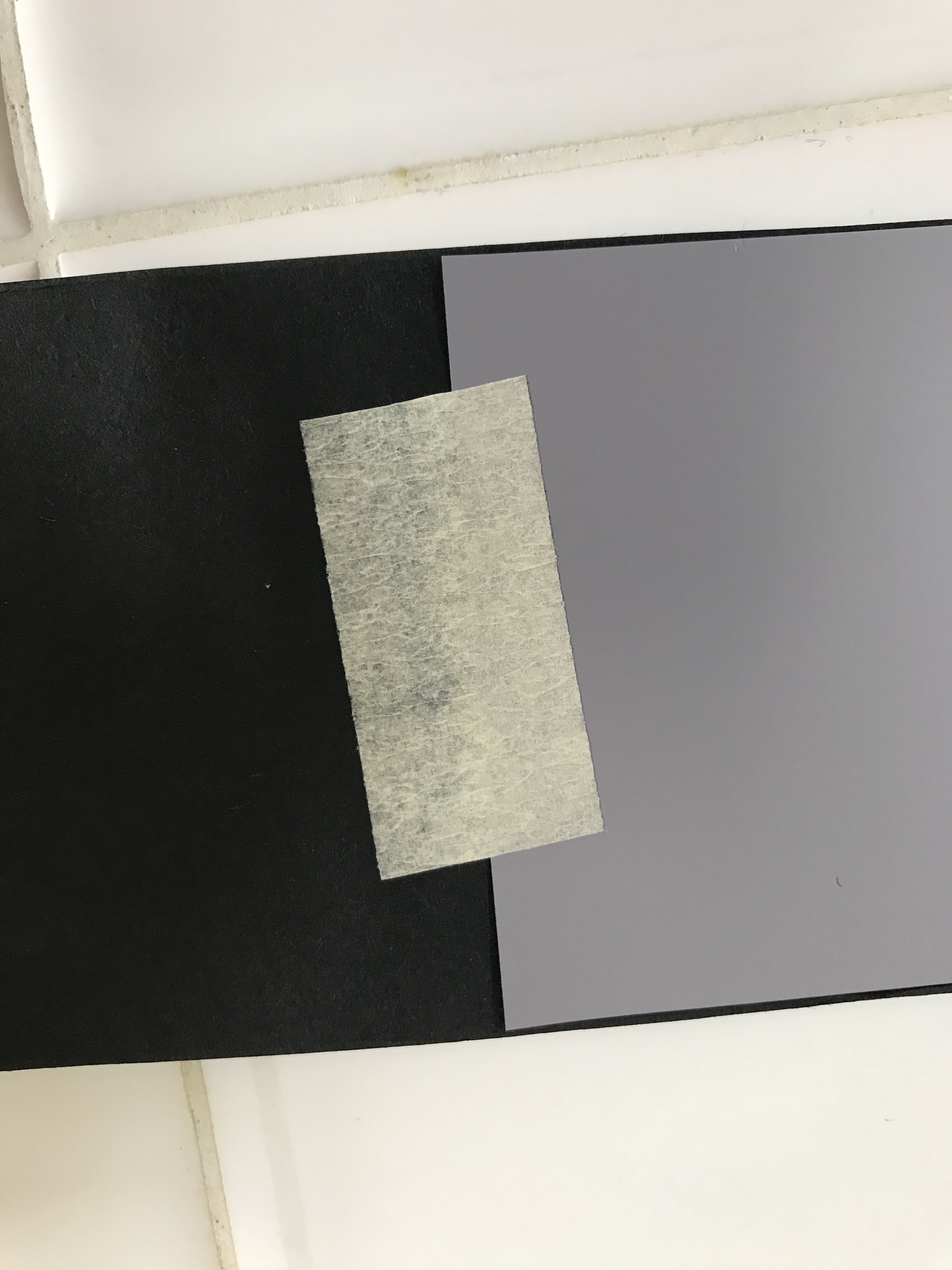

Wow. Without any real evidence, the forum has decided the tape is cheap and too short and is the sole cause of the problem with certain cameras that have a sinuous film path.
All evidence from people who have used the film, points to the tape. The tape is too short. The corners are snagging as the film is advanced. If it were me, I'd take one of those buggered rolls, retape the end properly, and run it through my Mamiya RB to see if it jams.

-) what other cause for the described camera malfunction and loss of film is imagable?
-) a film to jam a major camera, necessitating partial disassembly of it, is utmost faulty, whatever the cause is.
The situation would be different if the film would have been marketed as budget film, especially apt to feed plain box cameras and a warning about use with certain film transport designs.
I am willing to stand corrected.
The backing paper, perhaps? The tape adhesion, rather than length? Quality control in general?
I think there is probably a good reason why film manufacturers who care about QC, use long piece of tape...and backing paper with the right finish to hold the tape and film down. Shorter piece, even if the backing paper is top notch, will allow the film corners to bend, possibly catching onto something. I'll bet that CatLab stuff would bung up my Holga! :D
I recently processed a roll of CATLABS 80 as well as a roll of Ilford Delta 100 Pro. The backing paper from both was still in the trash can in my darkroom, so I fished it out to see if there were any differences. The CATLABS paper is very pulpy and relatively easy to tear. It was quite obvious where the tape had been, the surface was torn away (so tape adhesion strength is probably not the problem, although paper surface integrity might well be). The Ilford paper is much smoother and feels a bit more resistant to tearing. There was no obvious mark left where the tape had been. I could not identify which scrap of tape came from which roll of film, it was wadded up. This is a very small sample, and the roll of CATLABS did not give any problems in-camera. I do have a roll that would not advance properly in the camera (Rollei 6008, a pretty simple film path). I will examine that one to see what happened.
Sounds like CatLabs is not being very cooperative, or very concerned about this issue, and I know it's a bit of a pain, but for the remaining rolls that you have, you could unroll them, and stick on a longer piece of tape, then re-roll it. I've re-spooled many a roll of 120 onto 620 spool...
The roll that wouldn't advance properly...the tape and backing are still intact, not sure why I had a problem with this. But the tape IS short.

You would only have to unroll the backing until you reach the first inch of film, something you could feel in total darkness. The difficult part would be applying a piece of tape that would almost go edge-to edge of the film but not overlap the backing paper edges. I guess you could trim the excess off at that point, but I think it might be hard to do, and over-trimming might introduce yet another problem in a finicky camera or magazine. I still think the Shanghai/CATLABS paper is an issue. I just looks and feels suspicious to me.
When I was using the last of good GP3, before the plant shut down, I respooled several rolls for my Kodak Medalist II and Kodak Monitor 620. I can honestly say that the tape was not as adhesive as Ilford or Kodak. It wasn't bad, but was much easier to pull off the film. Why did I say "pull of the film" instead of pull off the paper backing? If I tried to pull the tape off the paper it would bring some of the rough backing paper with it and that meant I couldn't reseal the tape to the backing paper again. So I would remove it off the film and then press the tape to the backing paper and apply my own pre cut "long" piece of tape. One of the rolls that went bad in my Hasselblad back let the backing paper [feed normal, but took the tape right off the backing paper. It would feed norbally for about 6 or 7 shots and then stopped. I was stumped as to why I couldn't wind on. It took me a good long while to get that back opened and cleaned out. I'm glad I was using my old trusty 500C instead of my 555ELX. That motor drive would have really screwed things up.

[QUOTE="John Wiegerink, post: 2184386, member: 33580"One of the rolls that went bad in my Hasselblad back let the backing paper [feed normal, but took the tape right off the backing paper. It would feed norbally for about 6 or 7 shots and then stopped. I was stumped as to why I couldn't wind on. It took me a good long while to get that back opened and cleaned out. JohnW
EXACTLY what I experienced on my 2nd roll through the Hasselblad A12 magazine . . .[/QUOTE]
John,
Well that tells me the film hasn't changed one bit since they shut production down and restarted. This should have been fixed by Shanghai Film Company (whatever their name might be) way more than a year ago. I think CatLabs ought to really put the pressure on them to make this right. We shall see if the honorable Chinese do the right thing or not. JohnW
