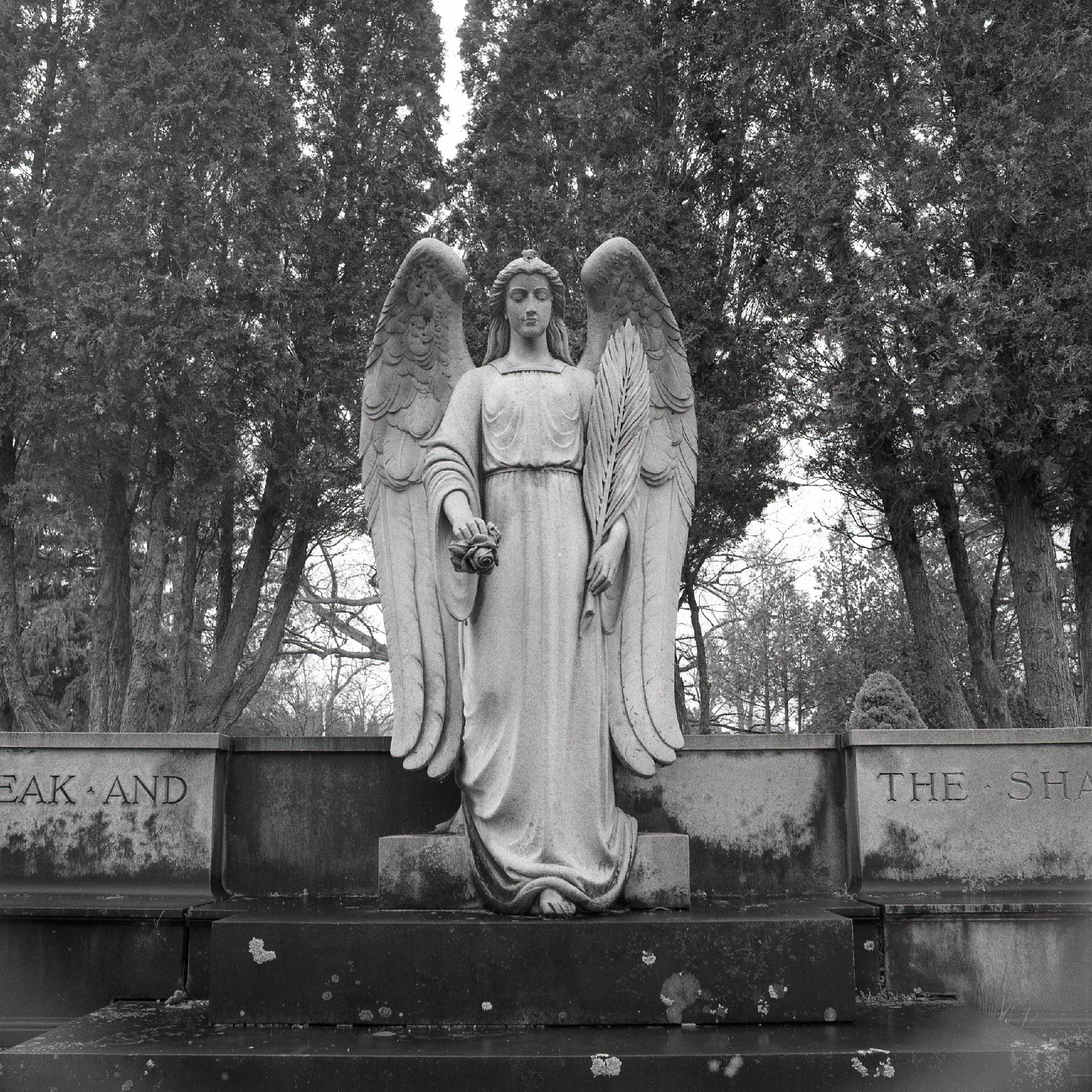

I have 10 rolls of it in 120 format. I shot and processed one roll in Rodinol 50 to 1. Here is one of the images off that roll . . .

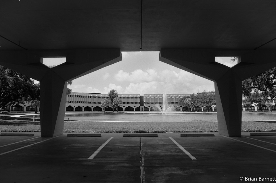

For what it's worth I shot a roll of the film last week thru a Mamiya RB 67 Pro-SD, 120 Pro-SD back and luckily didn't have any issues. I agree the backing paper was a bit on the delicate side and was pretty course. I liked the film though and look forward to using the other 4 rolls I purchased. I opted to develop in d-76 1+1. Attached is low rez scan of my results.

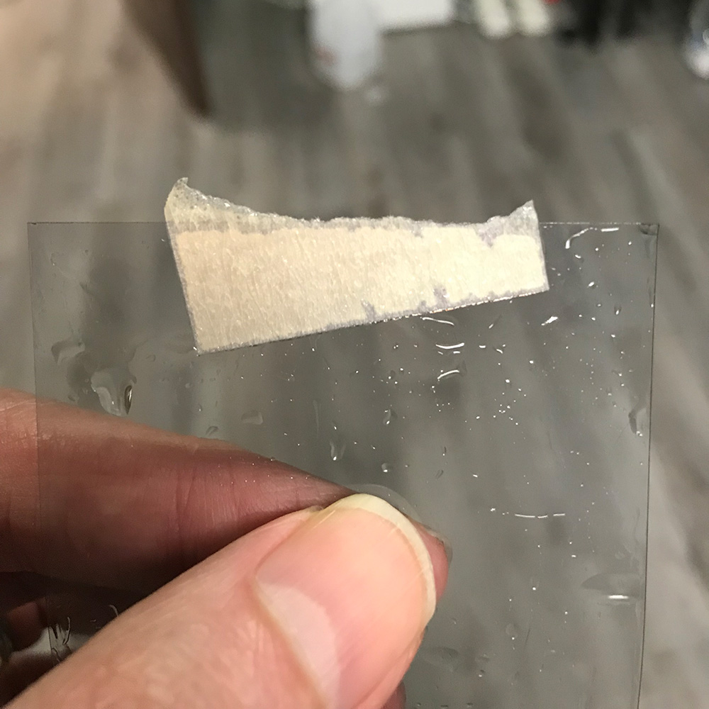

I ran the first roll of X Film 80 through my chemistry today and have some observations that may be related to the issue you had:
1. The tape holding the roll to the backing paper does not provide enough coverage across the width of the frame. It should go at least 90%+ of the width of the roll. If it doesn't, you're just asking for one of the corners to lift up just enough to catch on the inside of your camera and jam things up. See attached photo below. If there's something about this film that is going to hurt it, you're looking at it right now. I ran this roll through a Hasselblad 500CM and when I was advancing to the first frame, I felt one of the corners catch on something inside the film magazine. I was being slow and gentle and got past it, but I could see this easily being the source of lots of problems, so CatLABS, please take notes and on the next production run, the tape needs to go most if not entirely across the width of the film. I'm less perturbed about it not being affixed straight and more perturbed about the fact that it's not holding the corners down.
2. This is an observation and not a complaint. The backing paper resembles black construction paper. It's not particularly sturdy. It wasn't much of an issue for me, but it's definitely more fragile than backing paper for other films. It also smells funny. Not strong, but definitely not odor free, and not what I'd expect to smell. I'm not sure if its the film or the paper that smells.
3. holy wow that is some insanely clear film base.
4. I'll have a characteristic curve worked up and development time for replenished XTOL in a JOBO at 24C and posted in another thread in the next few days (this is what I'm spending my weekend on). It won't be long and we'll know the real workable EI for XTOL and a good idea of the characteristic curve. Following that will be some sample pictures.
