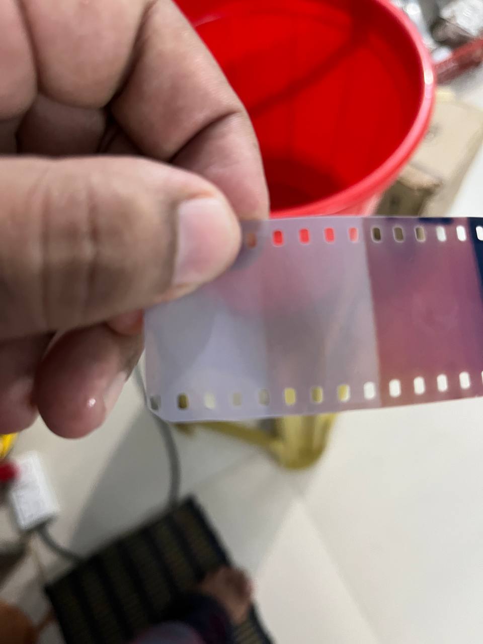

Okay so I have now developed several films, but this batch has been particularly difficult.
Using the AdoX kit, I miXed 500 ml and now in the siXth roll - an ektachrome 100D - it really fucked up. Am attaching a couple of photos. Is it that the First developer is gone? I had miXed the chemicals only day before. The temperature was also accurate. Any help/advice will be deeply appreciated…
Can you please give more detail? You said the "sixth roll", but you made up 500ml of the solutions just "one day before" ... does that mean the previous 5 films, which you must have processed within 24 hours, were OK? And what tank etc are you using, Patterson, Jobo ...?
I have never had a problem with the Adox E6 kit ... although I only processed 4-5 films per 500ml, never a sixth, but I can't imagine that the solutions just die in a few hours for the sixth film.
PS Many sympathies, it must have been terrible to open the tank and see this!
ujjwal
Jun 9, 2025
24
Vienna
So I am using a patterson single tank. and yes, the previous roll I did came out very good. THe previous roll was a provia 100. So the earlier ektachrome that I did also came out a bit strange. I had been adding a 15-20 seconds eXtra to FD time (from recommended times by adoX), as I was afraid that my dilution was off by a few ml s. The previous ektachrome (the fourth roll of the lot) came out darker and higher contrast (higher than ektachrome typical high contrast) so in this roll (the siXth roll) I stuck to adoX recommended timings.
And yes, this is terrible to see, the worst possible way to end the day really. Like the day was going well, and this!!!! AAAARRRGGGHHHH!!!
loccdor
Jan 12, 2024
2,387
USA
Are you sure it's not from film expiration? I've seen similar from very old slide I've tried to process.
ujjwal
Jun 9, 2025
24
Vienna
oh, i didn’t think about that….
as far as i know its not eXpired… i get these hand rolled films and am not sure about their eXpiry.
Even if it were eXpired, it shouldnt be eXpired for very long.
Spektrum
Apr 11, 2025
115
Poland
The expiration date is one thing, but another is how the slide film was stored. I'm reminded of a story my friend told me about, who in late spring put an unopened box of slide film in the glove compartment of his car. He forgot about it for two months, and in the meantime, the hot weather arrived. He remembered the slide film and tried to use it, but even though the expiration date wasn't for another two years, the film was already completely useless.
