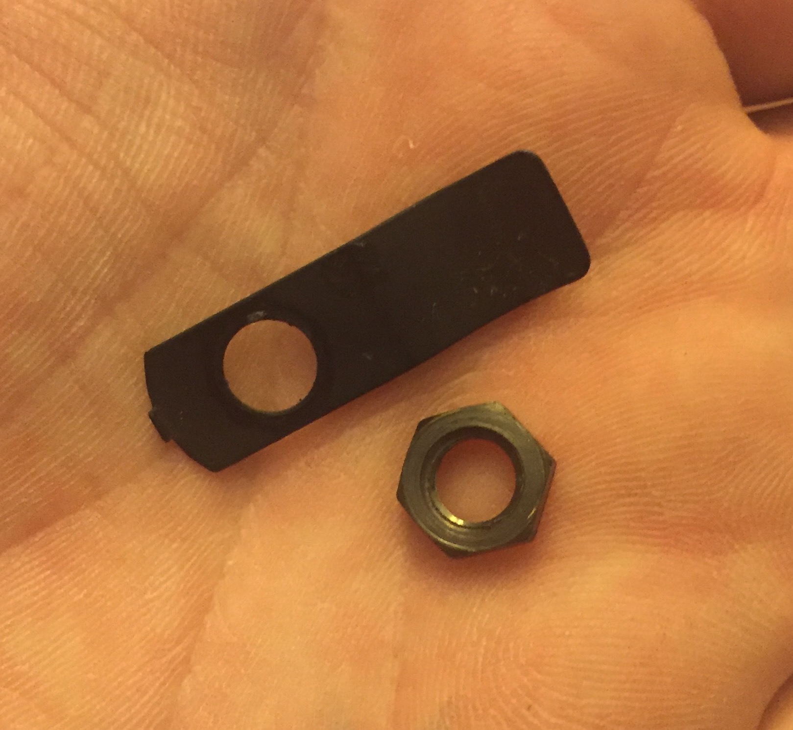

I just got an anniversary speed graphic in the mail. I found this part in the bed. I've looked at the diagrams in two different manuals and didn't see anything like this. Does anyone know off the top of their head?

Yes it's the small release plate and nut off the bottom of the front standard that allows front shift. The nut also locks the screw bolt that adjusts the front standard lock. It's vibrated loose in transport.
Just slide the standard off the front of the track and you'll see where it fits.
