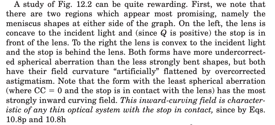

The optics principle of putting the aperture stop and concave meniscus towards the subject to reduce aberrations is very well established. Wollaston seems to have figured it out in the early 19th century: https://en.wikipedia.org/wiki/Wollaston_landscape_lens It is worked out as an example in optics design textbooks, because the single lens + stop is a good intro to ray tracing math and so on. I'm sure that it's in Kingslake's "Lens Design Theory," and in a different form in Warren Smith's "Modern Optical Engineering."
I found a pdf of the relevant chapter in Smith's book. Here is a screenshot where he's discussing a figure showing keeping the lens power (focal length) constant while varying the bending from concave toward the subject to concave away, and keeping the stop in a position to reduce coma. His remarks on the tradeoff between spherical aberration, field curvature, and astigmatism are interesting. The meniscus form has the field curvature compensated by astigmatism, whiile the unbent double convex lens (like a typical magnifying glass) has strongest field curvature.
(FWIW I am not an optical designer; I'm an astronomer with some optics experience, I couldn't easily design a lens from first principles, but can mostly understand the relevant textbook.)

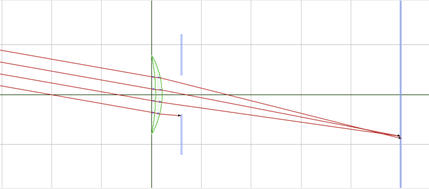

Just in case anyone is still interested, I made a couple of diagrams to show how changing the aperture location matters. These are optical diagrams made with the Optical Ray Tracer program, from here: https://arachnoid.com/OpticalRayTracer/ So they are real ray traces, but they are just an example and not optimized for a specific focal length, nor has the aperture location been optimized for image quality.
I merely set up a simple meniscus lens and then put an aperture stop either forward of or behind the lens. What you can see is that depending on the stop's location, it will admit or block different rays from an off-axis subject, so the off-axis image it forms will change. This diagram isn't sufficient to tell which is better, but calculations in optical design textbooks show that the first config with lens concave toward subject, aperture in front of lens is better.
Wollaston with his landscape lens actually figured out to put the lens concave toward the subject decades before photography was invented, which is remarkable to me (he was using a camera lucida).
Aperture (blue) in front of lens (green):
Aperture (blue) behind lens (green):

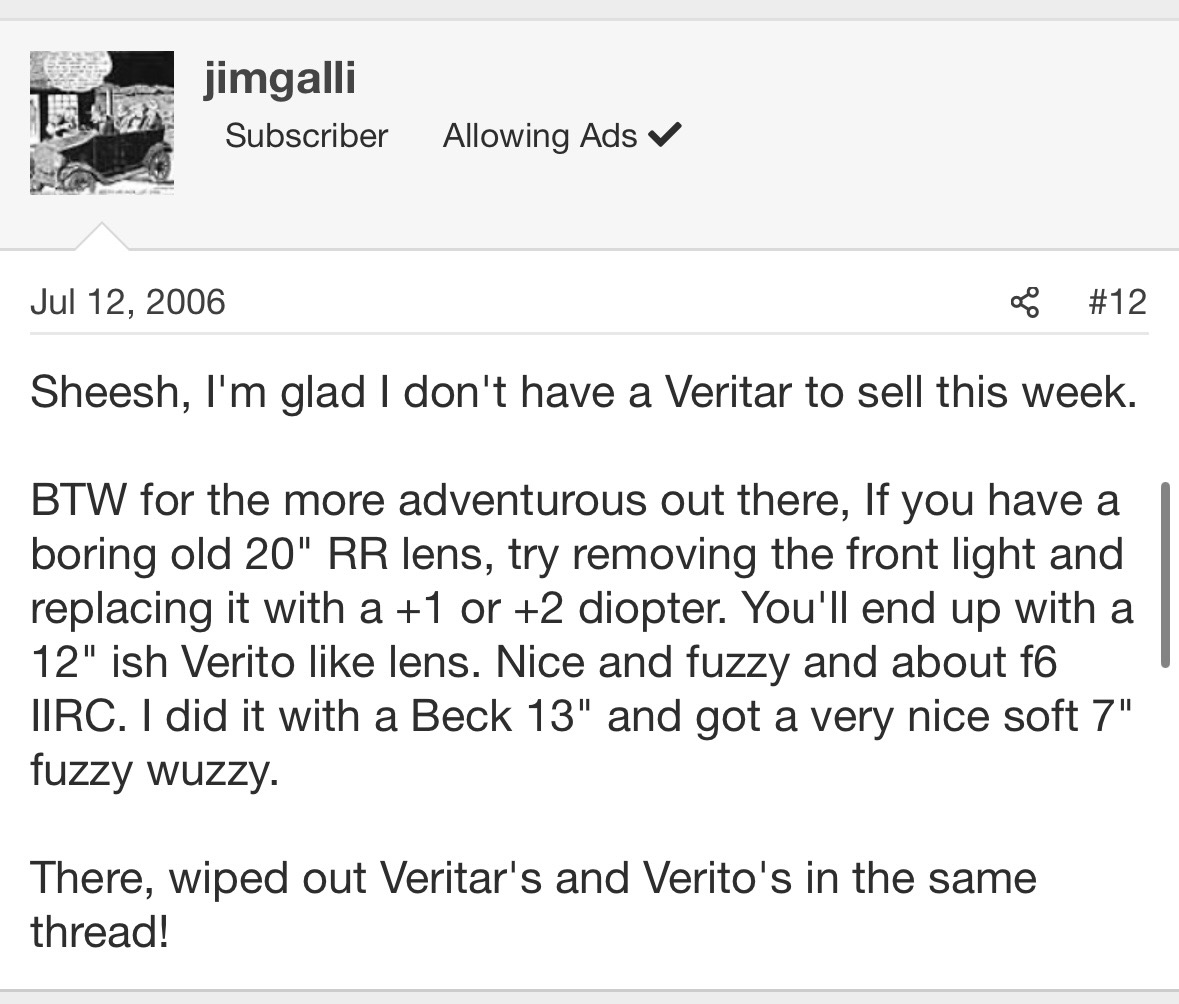

A post made by Jim Galli here on Photrio, recommending the use of a Rapid Rectilinear rear lens elements, paired with a Diopter lens up front.

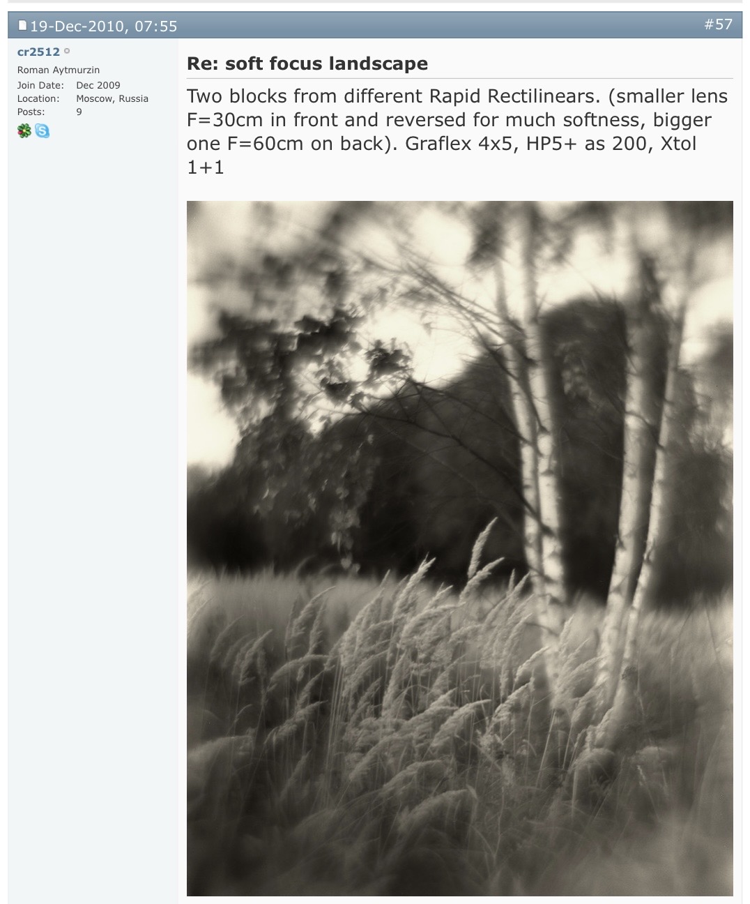

Another post, made by user cr2512 on the LargeFormatPhotography forum, suggests using two Rapid Rectilinear lenses of different focal lengths, and inverting the front element for more diffusion.

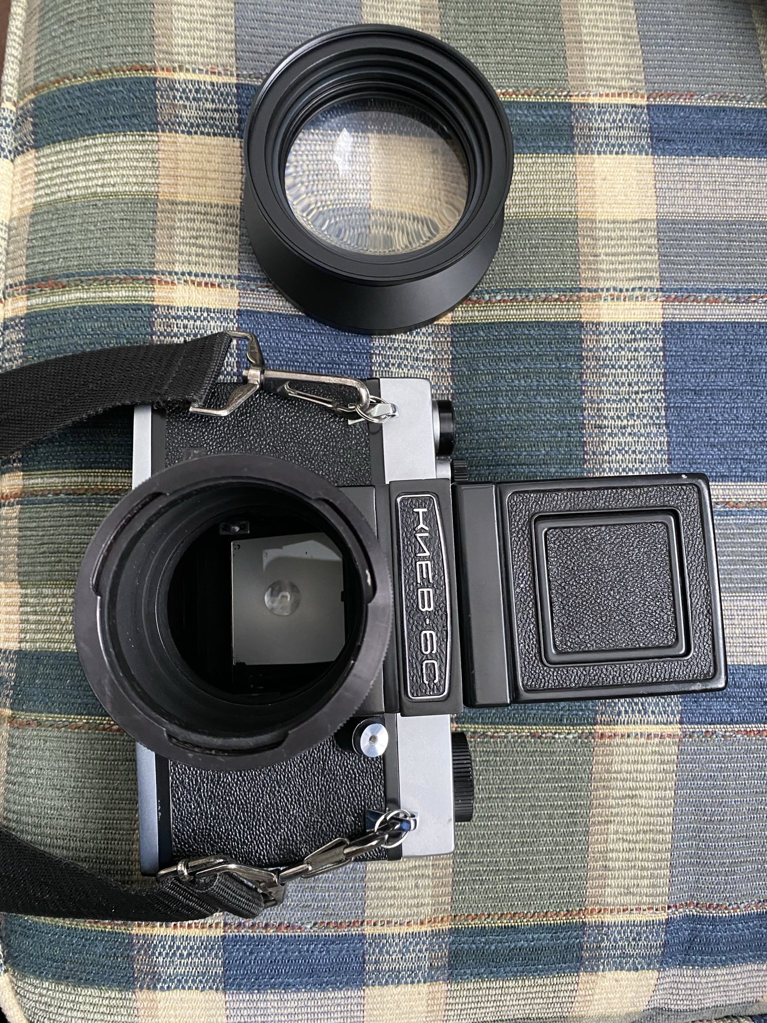

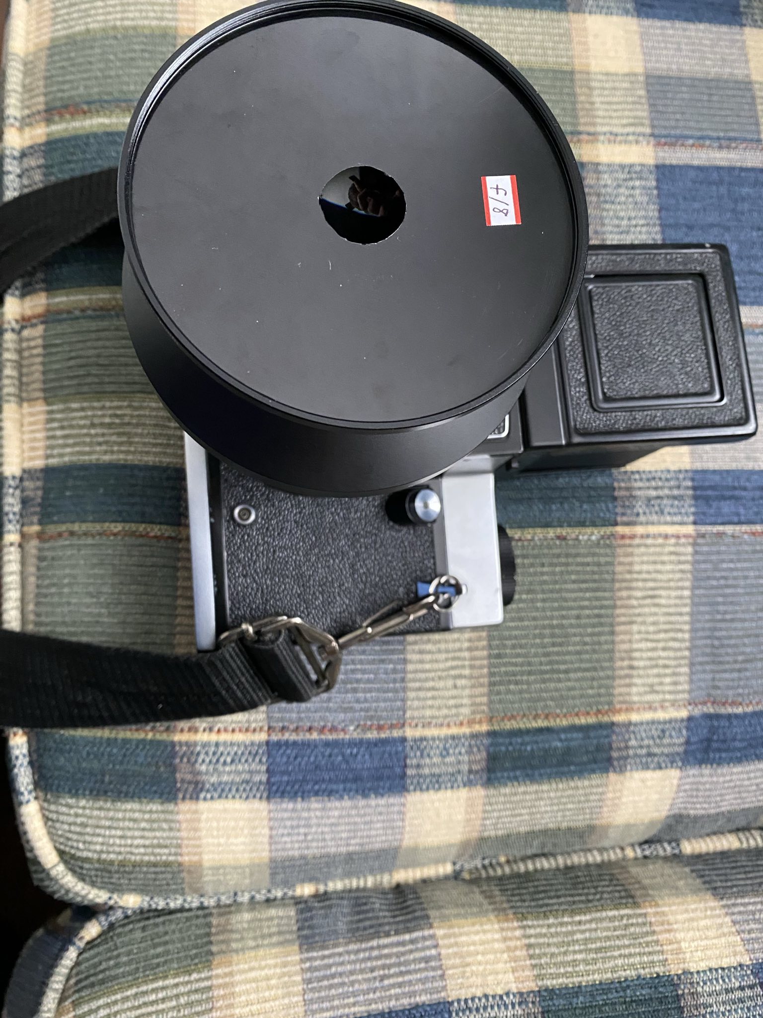

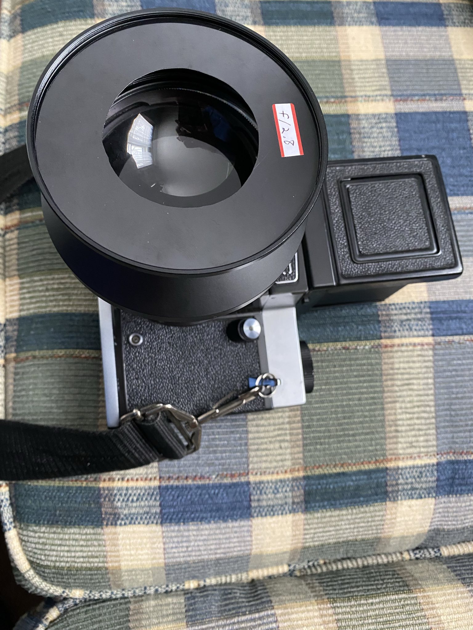

Thanks so much to everyone for the interesting replies, I wanted to give an update:

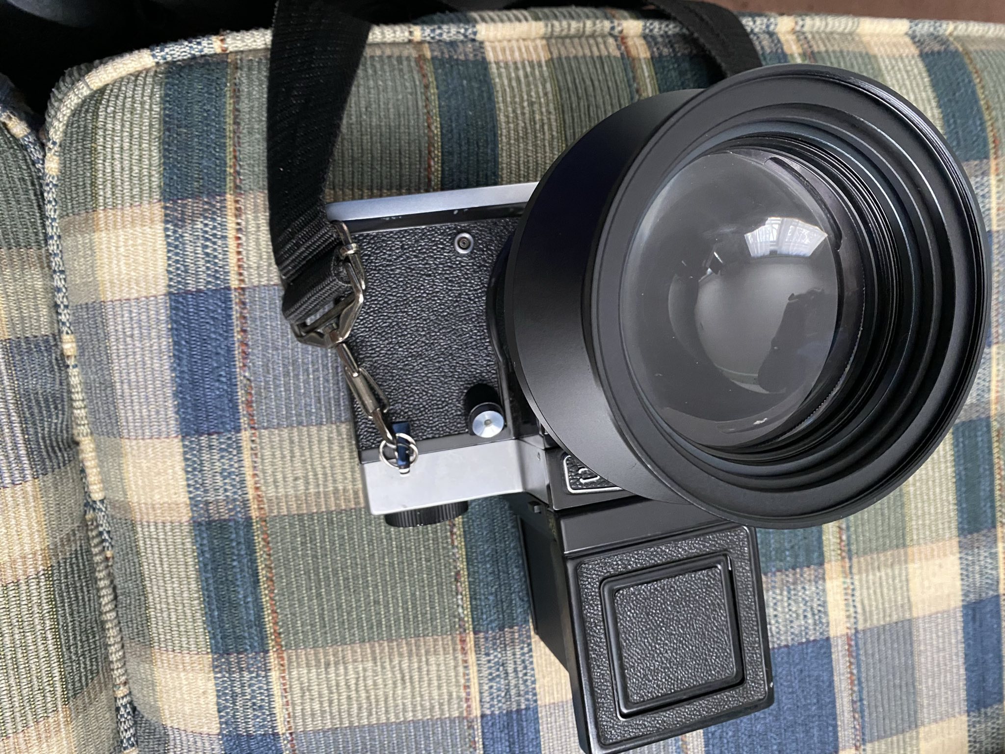

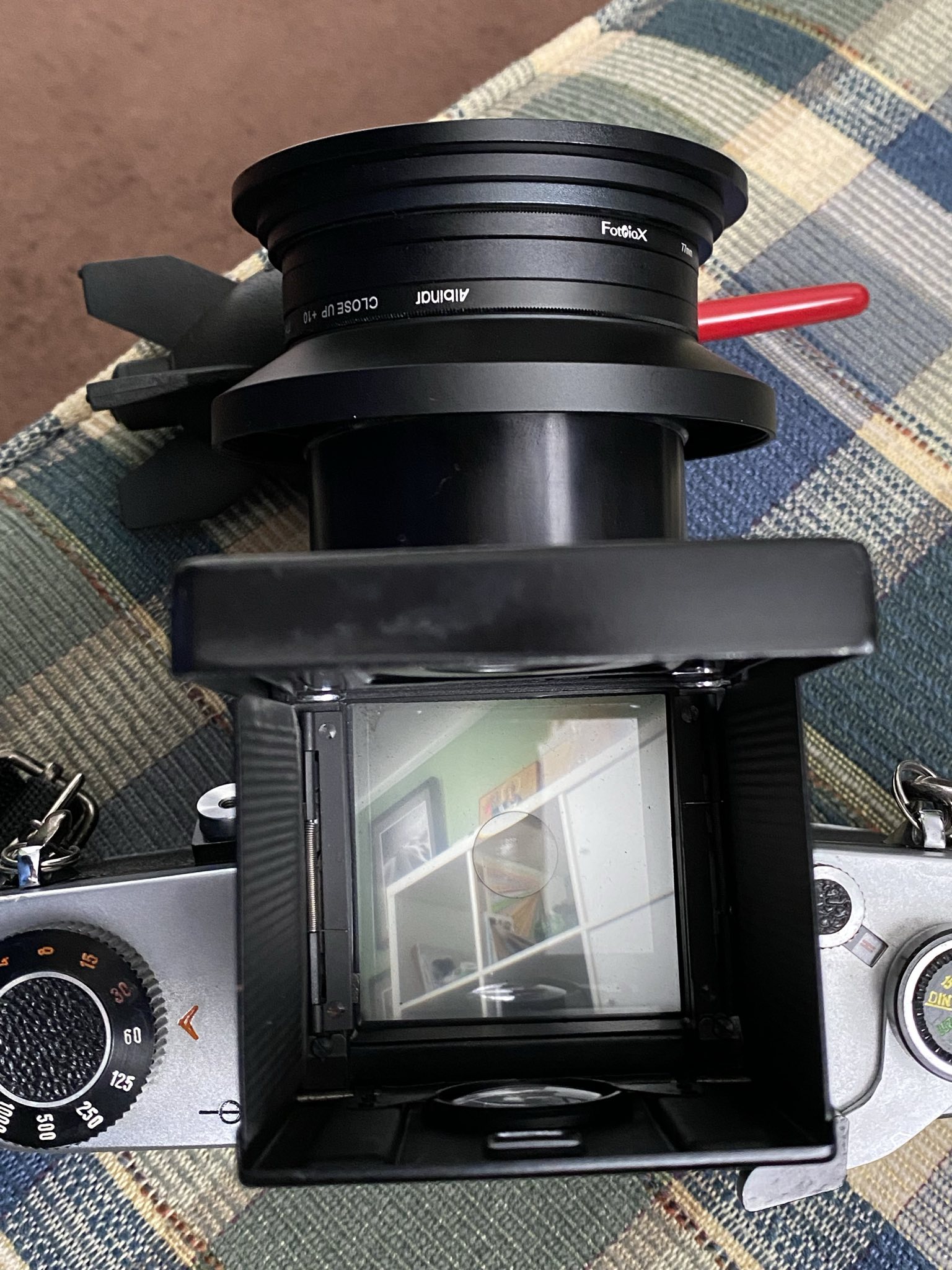

I received the materials for making this lens and started working on it.

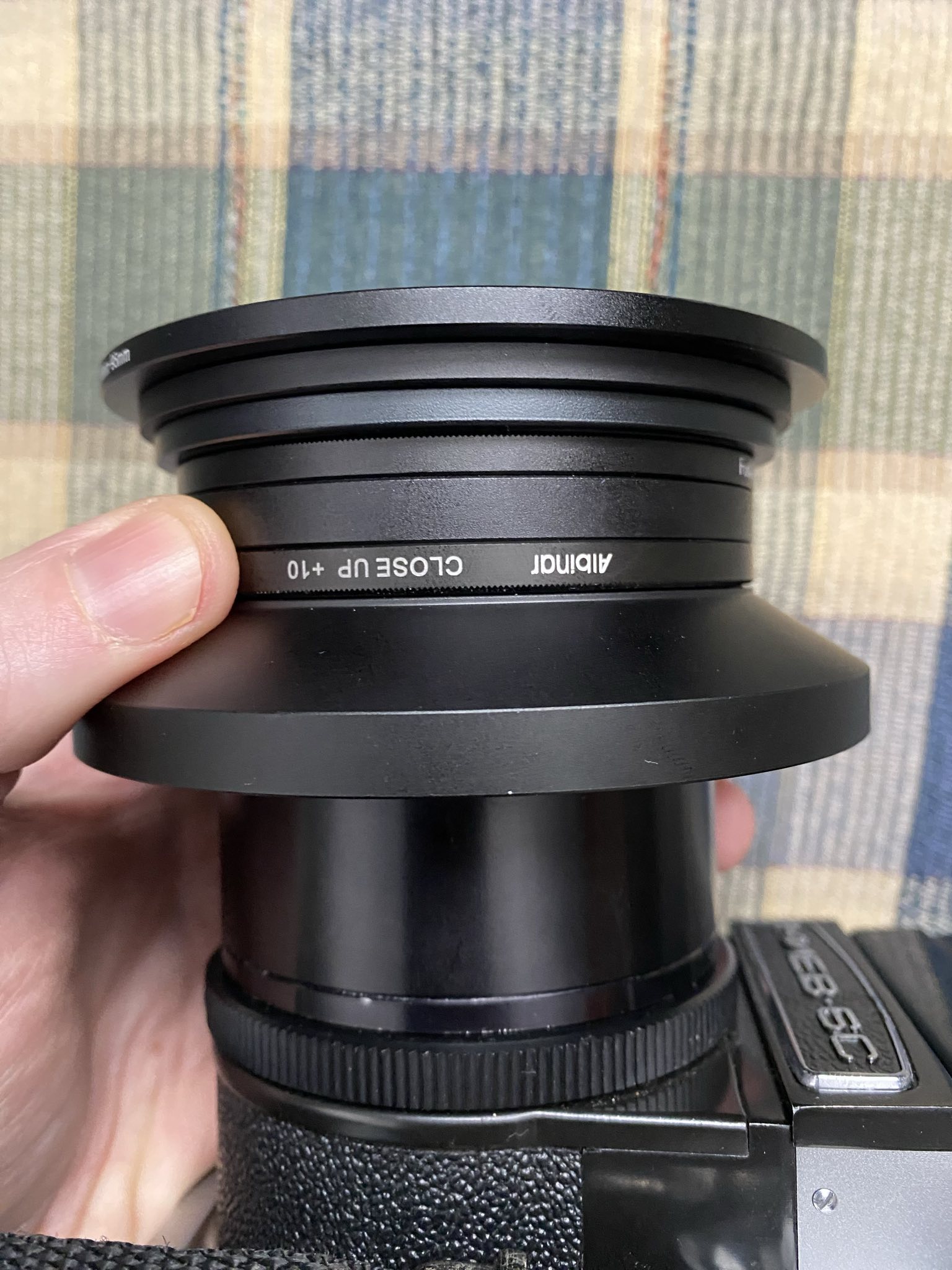

Unfortunately, the Zykkor 77mm +10 diopter filter I am using turns out to be a Plano-Convex rather than a true Meniscus. But fortunately, it seems to give a similar character, so all is well.
I did a lot of experimenting with how the rendering changes when flat side is faced toward subject vs. curved side.
Curved side toward subject doesn't give much coma, has poor center sharpness and almost nonexistent edge sharpness. Flat side toward subject gives more coma, more center and edge sharpness. All these are what I want so flat side is what I will use.

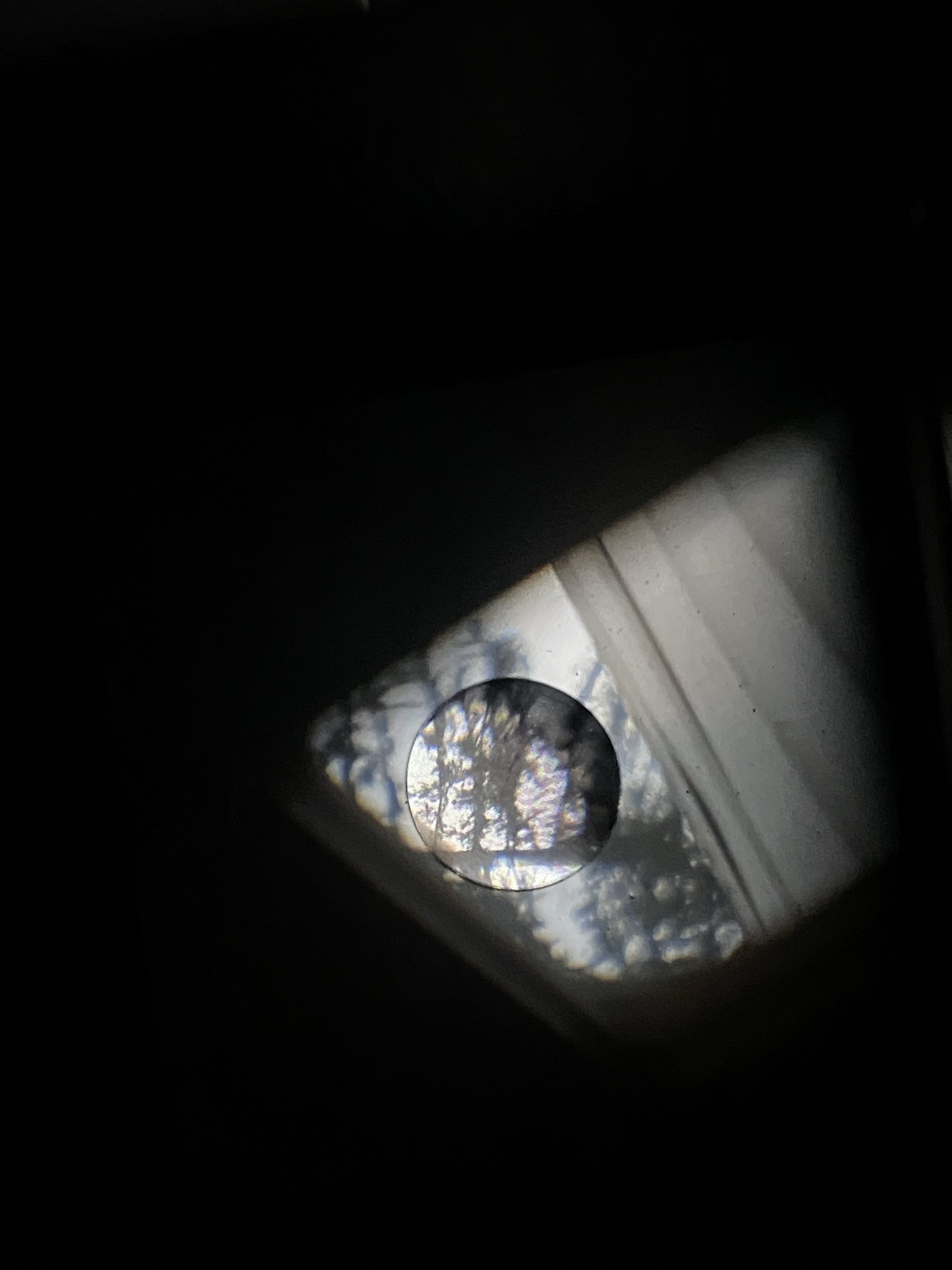

Stopped down to about f/4-f/6 (not well focused, just a rendering example picture of a viewfinder):
The diamond shape is a window I am shooting out of, not vignetting. But the painterly coma quality of the distant trees does at least confirm for me it's doing the rendering style I want.

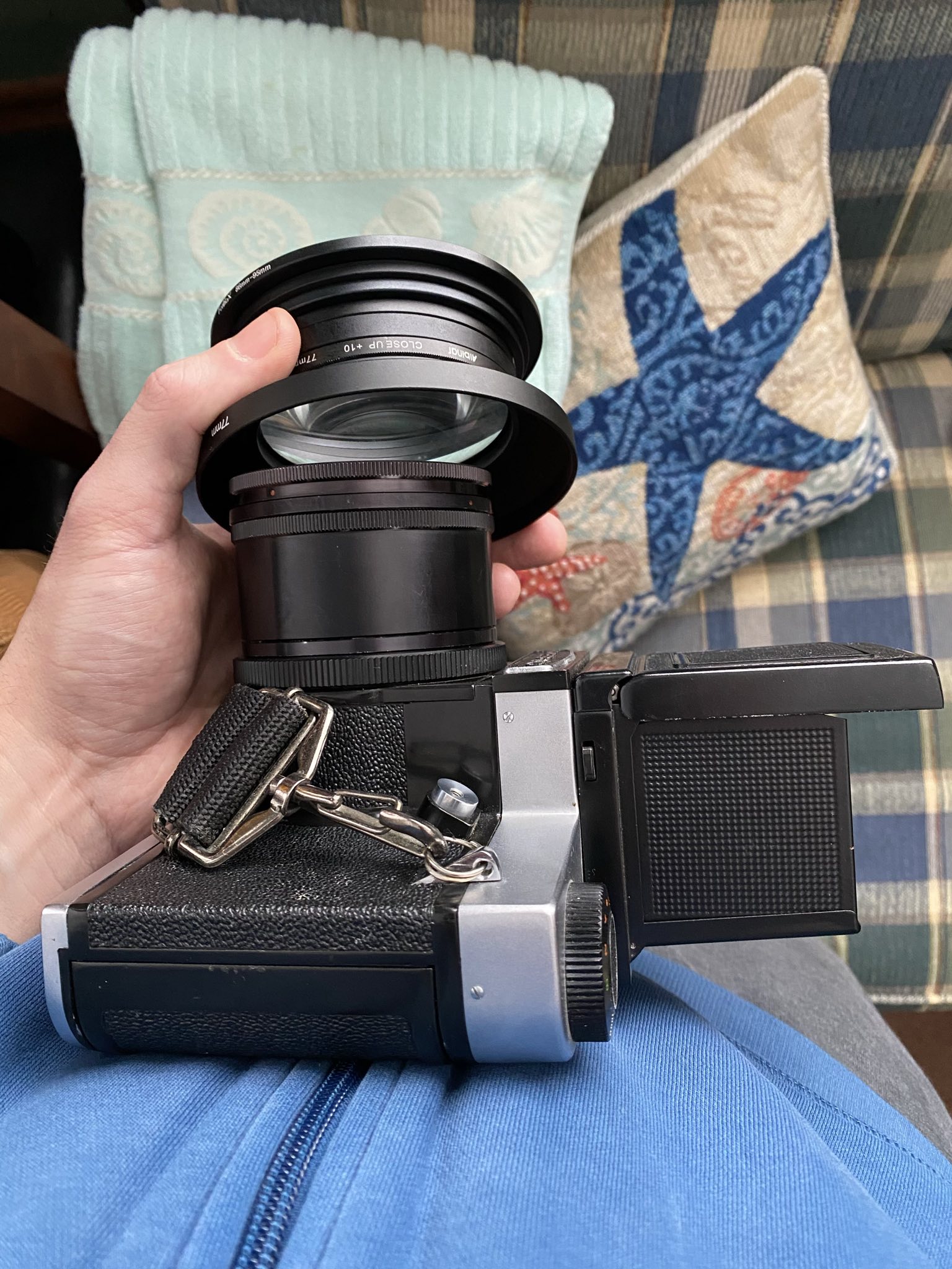

I'm using a series of step up rings, female-to-female rings, spacing rings, and a lens hood at the moment.
I have extension tubes on the Kiev 6C camera body that I try to make it so the lens focuses near infinity when I press the back of it to the tube.
However with this type of lens you need less extension for infinity focus as you stop it down (focus shift). So I'll need to decide on an f/stop I most want to use it at. Too bad I don't have a helicoid or bellows. Right now the plan is to "freelens" it to focus.
Also, the effective focal length turns out to be more like 150mm when assembled this way, which is significantly different from the 100mm raw mathematical estimate from the diopter strength. That's okay. When I had the curved side facing the subject, it was closer to 115mm.
The coverage is about 110mm for the image circle. Way more than I needed.
More experimentation will be required.

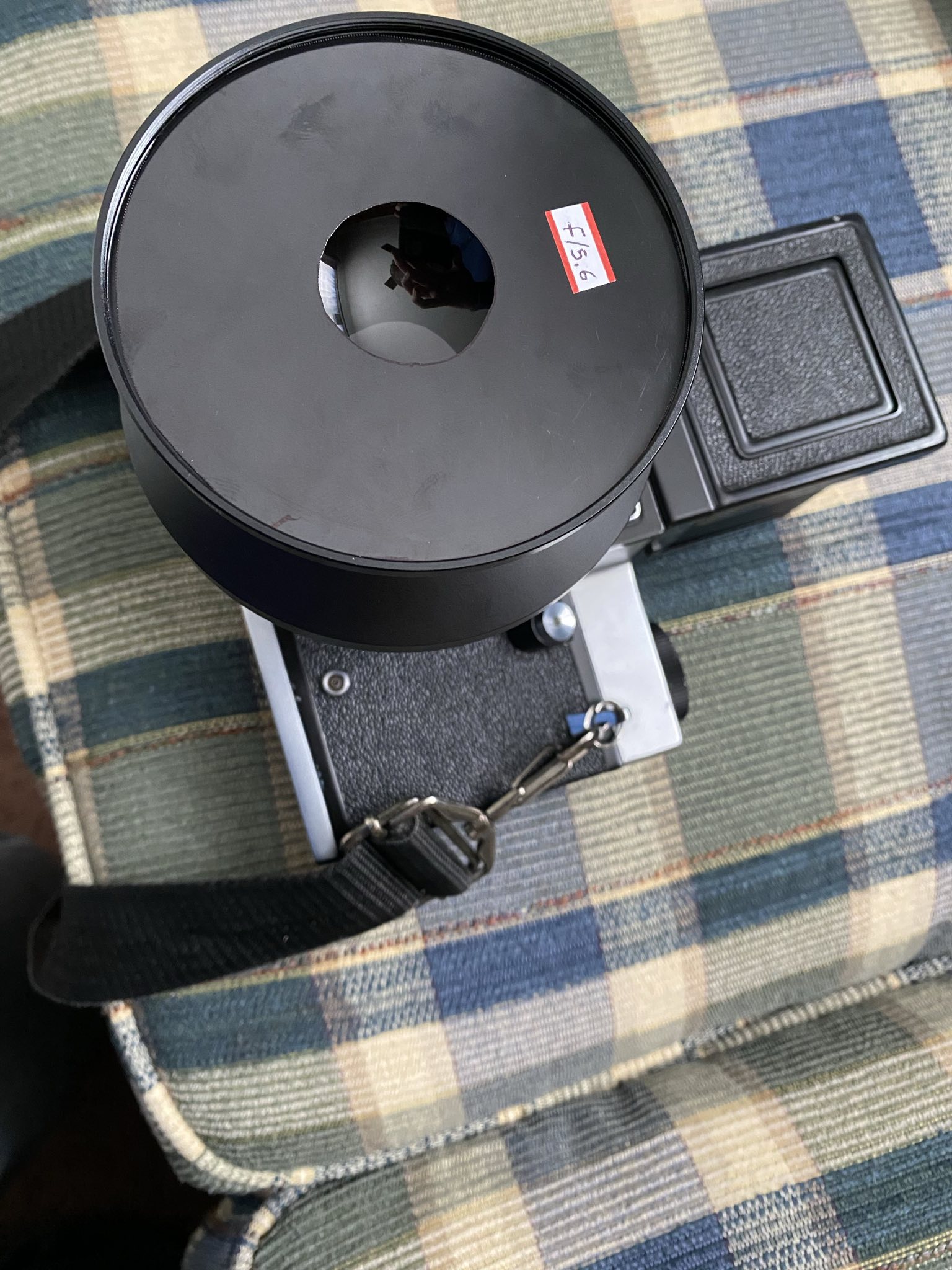

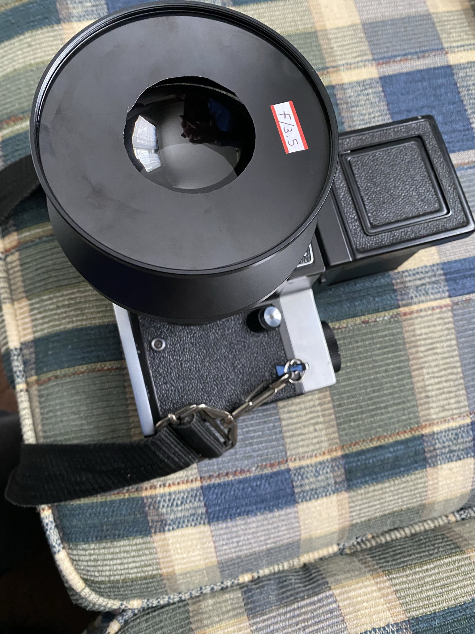

A few more pictures, with the stops created. I think that f/3.5 might be my favored stop with this lens, but also considering creating an f/4. f/5.6 has a very light coma effect. Wide open is f/2, too strong of an effect for most purposes, as is f/2.8.
I've added approximately 50mm of extension tube to make the pressed-against-camera focus distance about 3 meters.
f/3.5:
