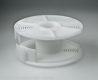

exactly.....we can add 'leak sweats' to 'film sweats' for new people to the art......I still, after all this time, get the sweats (esp in my climate) when the damn 120 film doesnt spool properly (paterson spools again).....I expect its because I use expired film thats been rolled up tight for decades.....
If your having issues loading 120 film onto standard Patterson reels , upgrade to a AP or Kieser reel .
They have a larger fin (?) for starting the film on , so much easier .
I always use this type for my 120/220 and the standard reel for 135 .

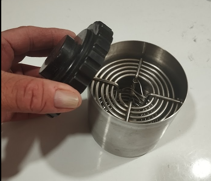

This is what I use :
I had several Paterson on the past, but most of them eventually got cracks. This thing last forever.
I have one of those plastic lids that has cracked, and one that seems to be lasting well.
Although the fact that I cannot successfully load 120 steel reels means that I almost never use my steel (and equivalent plastic) tanks for steel reels.
If I was only using 35mm, I'd seriously think about going back to steel reels.
