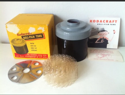

I have one of those plastic lids that has cracked, and one that seems to be lasting well.
Although the fact that I cannot successfully load 120 steel reels means that I almost never use my steel (and equivalent plastic) tanks for steel reels.
If I was only using 35mm, I'd seriously think about going back to steel reels.
When I started (on the early 80's), I really liked the plastic reels as well as the kodak
Used those for both 35mm and 120mm,as well as the Paterson plastic reels, but my father used to sneer on me (he was a photography teacher) saying that serious photographers used steel reels, so eventually moved to steel reels for most of my life (with a brief time I used Paterson tanks that got cracked, probably due to my mishandling).

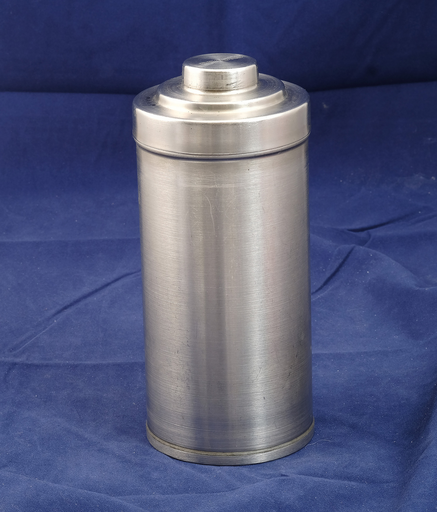

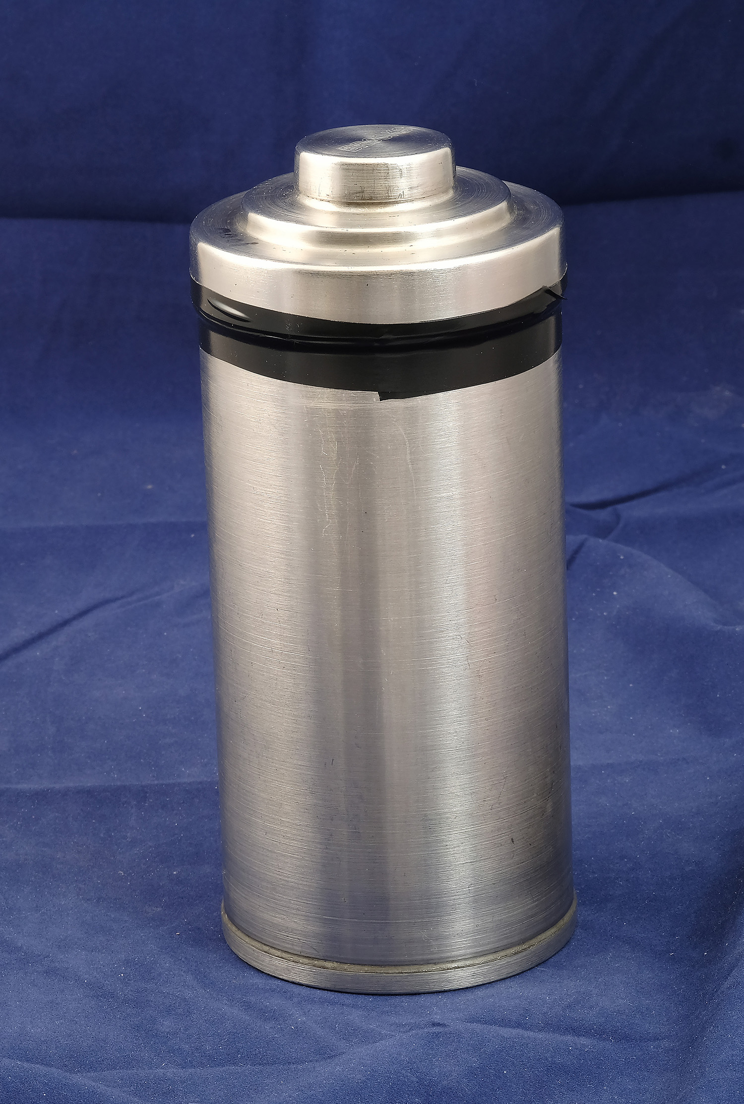

I'm fully aware of Scotch 33 tape as a sort of makeshift shim material. I always keep it on hand. It has a limited lifespan for such purposes before it starts end peeling on its own (rub it down firmly), but is easily replaced (it DOES leave sticky goo behind). Where I worked as a buyer, we had a 3M direct industrial distributor account for decades - communication between all the seemingly competing divisions was hell to navigate through. But this type of tape is available everywhere. Don't buy substitute brands.
I don't use as a shim and realize I had not been very clear regarding how I used the flexy tape. I use it as an outside seal (one-time use), covering the seam on both sides, body and lid. I had given up on plastic lid style tanks long ago and switching to the steel lid designs helped greatly. I hadn't thought to use the tape until I saw it as common practice at work. Here are a couple of shots of a tank today. It keeps everything very dry for me.

Tape down the SS top as illustrated above and, if really needed, try some plumbers Teflon tape on the threads so a plastic tank or electrical tape or plain Gaffer's tape, not Duck or duct taped which are too strong.
