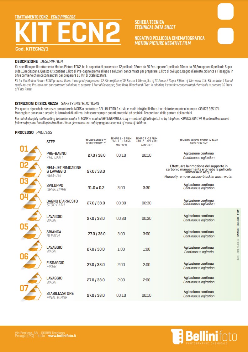

The instructions give the standard steps…

I'm doing pre-soak all the time for C41 film in Bellini kit. The reason is that I want to make sure the tank and film are around 100F when I pour in the color developers so the temperature and time will be correct.
In conclusion, I ignored Bellini's instruction of "no pre-soak" with no ill effect for over one year now.

I was watching a video in which the guy prewashed before using the Bellini. He added 45secs to the dev. Is that necessary? Or just more YouTube b***ox? :smile:
That's a massive increase that constitutes about a 1.5 stop push it so. As virtually always, it'll produce an I age and it'll scan OK, but the color balance will shift, crossover increases and so does granularity. There's no good reason to do this the way I see it.
