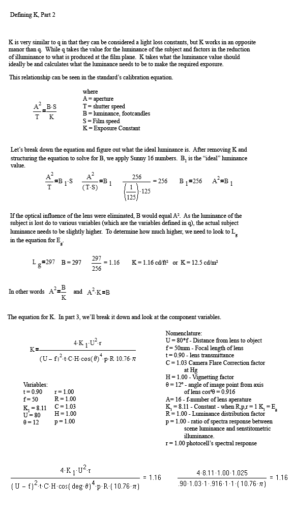

You introduce "K" in an equation, in which it is defined as 4*K (something over something else)???
It is K sub 1, not K. I know it's not entirely fair to present the equation without defining all the variables. My purpose wasn't to deal with K at this point. I just wanted to show how similar it is to the equation for q. Technically it's supposed to be K' sub 1 but ' is a function key in Mathcad and it wouldn't take. It's a small fudge, but I know it can be confusing. The standard uses a number of different variations of "K" and it's hard to keep them all straight.

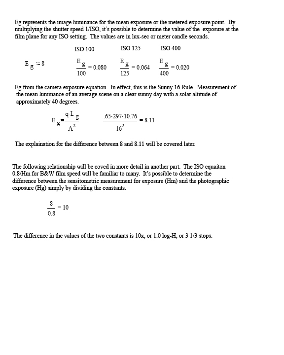

What makes all the math and numbers more than just math and numbers is how they connect it all together: exposure, film speed, and the meter. There are a few numbers to keep in mind because they keep coming up.
Eg = 8
Lg = 297
q = 0.65
And the camera exposure equation:
E = q * L / A^2
There are a few interesting concepts that can already be teased out of the information provided in part one. At first some of it might appear like circular reasoning but more proof will be available in the next few parts.
Defining K - Part 2
Part 2 introduces the constant K and shows how similar it's function is to the constant q.

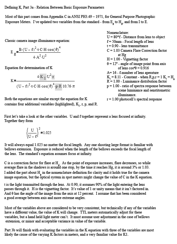

Part 3a begins to define the variables in the K equation. These cover the basic assumption on the optical system. Part 3b will look at the variables r, p, and R which have a more direct connection to the exposure meter and I believe the variance in K factors.
BTW, this is the first time I've made an attempt at a coherent explanation for the constants. I'm sure I have to missing steps, mistakenly assuming prior knowledge, or simply not explaining it well. Please keep up the questions.

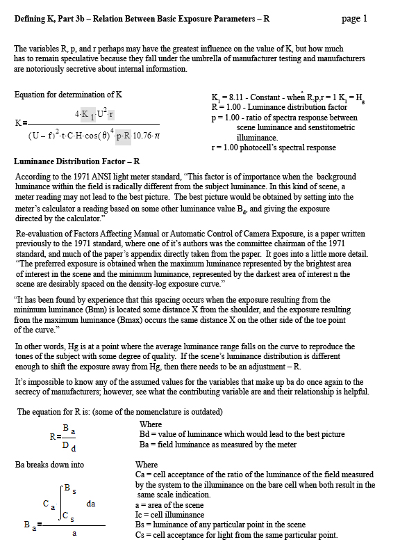

This is getting bigger and more involved than I had originally intended. Part 3b defines, as much as possible, the variable R. As I point out in this part, R, q, and p come under the domain of the meter manufacturers, and manufacturers tend to be very secretive.
I've yet to find only a few values for q, but haven't found anything on what the values for R and p are considered outside of the standard's values which all equal 1. Now this might represent the average conditions, or it could be zeroing the variables out of the overall equation of K in order to produce a universal version of K as these three variables tend to be specific to each individual meter's design. So, while it's possible to define the variables R, r, and p, we can only speculate what influence they have on the value of K.
Sounds like R is a weighted average factor for a regular reflected light meter.

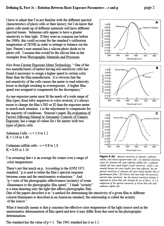

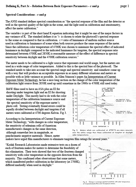

This part covers the variables r and p. I believe r is the major cause for different values of K for different meters. With the variables R, r, and p, it is now possible to define a basic constant K1 which excludes all variables except film speed and camera exposure due to measured field luminance. K1 will be defined in the next part.

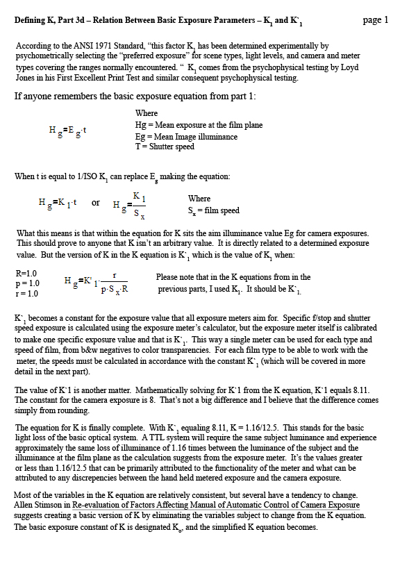

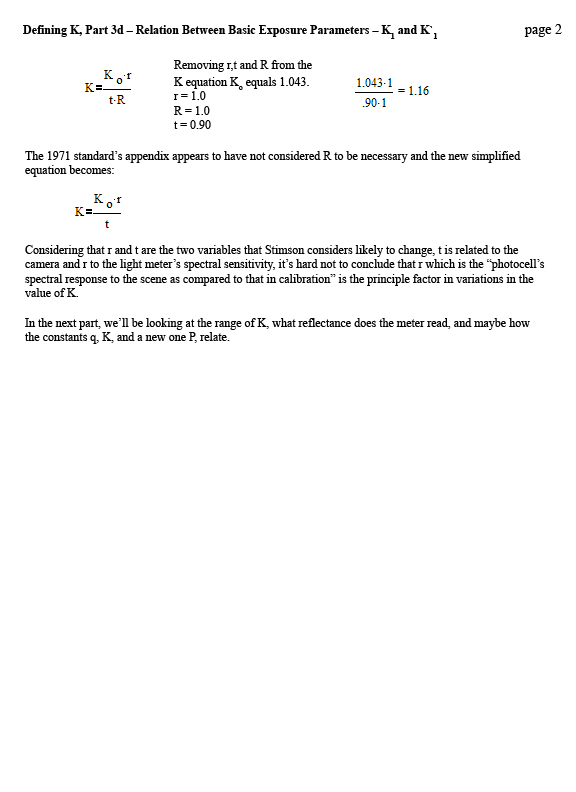

One of the more confusing aspects of the exposure meter standard is that there are four different versions of the letter K each representing different variables. ThereÂ’s, or course, the K-factor K. The other three are Ko, K1, and its derivative K`1. This part defines the confusing three Ks.
Bill, this part begins to answer your meter's K = 12.5.

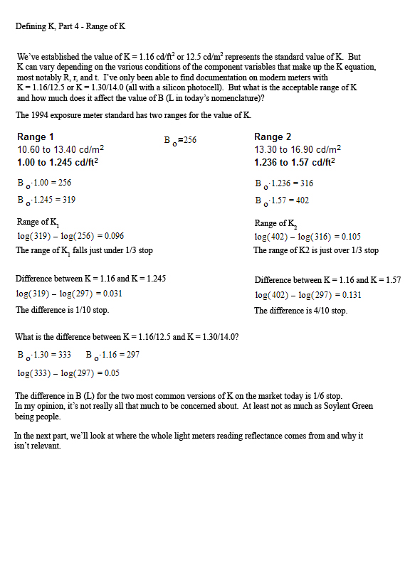

Part 4 deals with the Range of K. It might be surprising how little it really is.
Interesting point of fact: While reviewing the 1960 standard, I noticed that even though it introduced the change in the color temperature of the calibration luminance to 4700K, the K equation didn't contain the variables for R, r, or p. I was most surprised that it didn't have r as it is related to the difference between the color temperature of the calibration light source and the luminance of the subject.

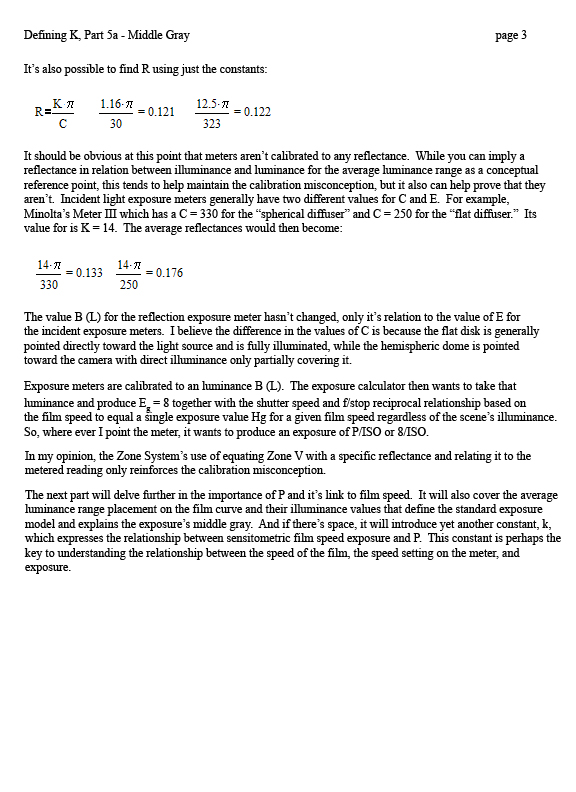

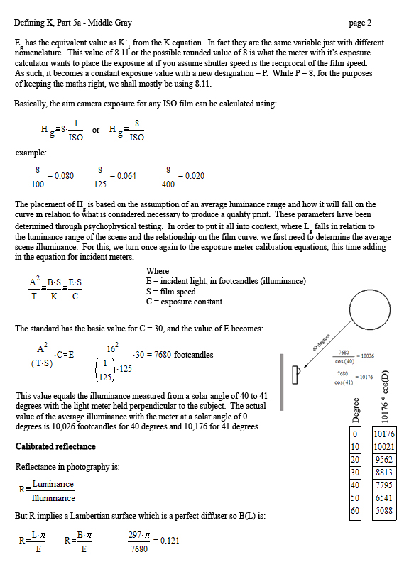

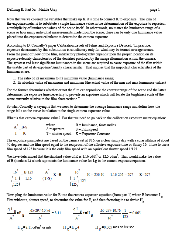

Part 5a finally deals with a subject that is usually one of the first issues raised on the topic of exposure meters - Middle Gray.
I'm hoping nobody is having difficulty with the awkward mix of older nomenclature mingling with current. My excuse is that most of the detailed equations for exposure meters come from older sources and I am more familiar with their symbols. I also didn't want to confuse myself having to do all the conversions. I'm now beginning to regret that decision. I hope this hasn't caused too much confusion for the four people still hanging on.
Thanks Stephen, lots to digest. Hard to believe in the end it all gets wrapped up into one number.
