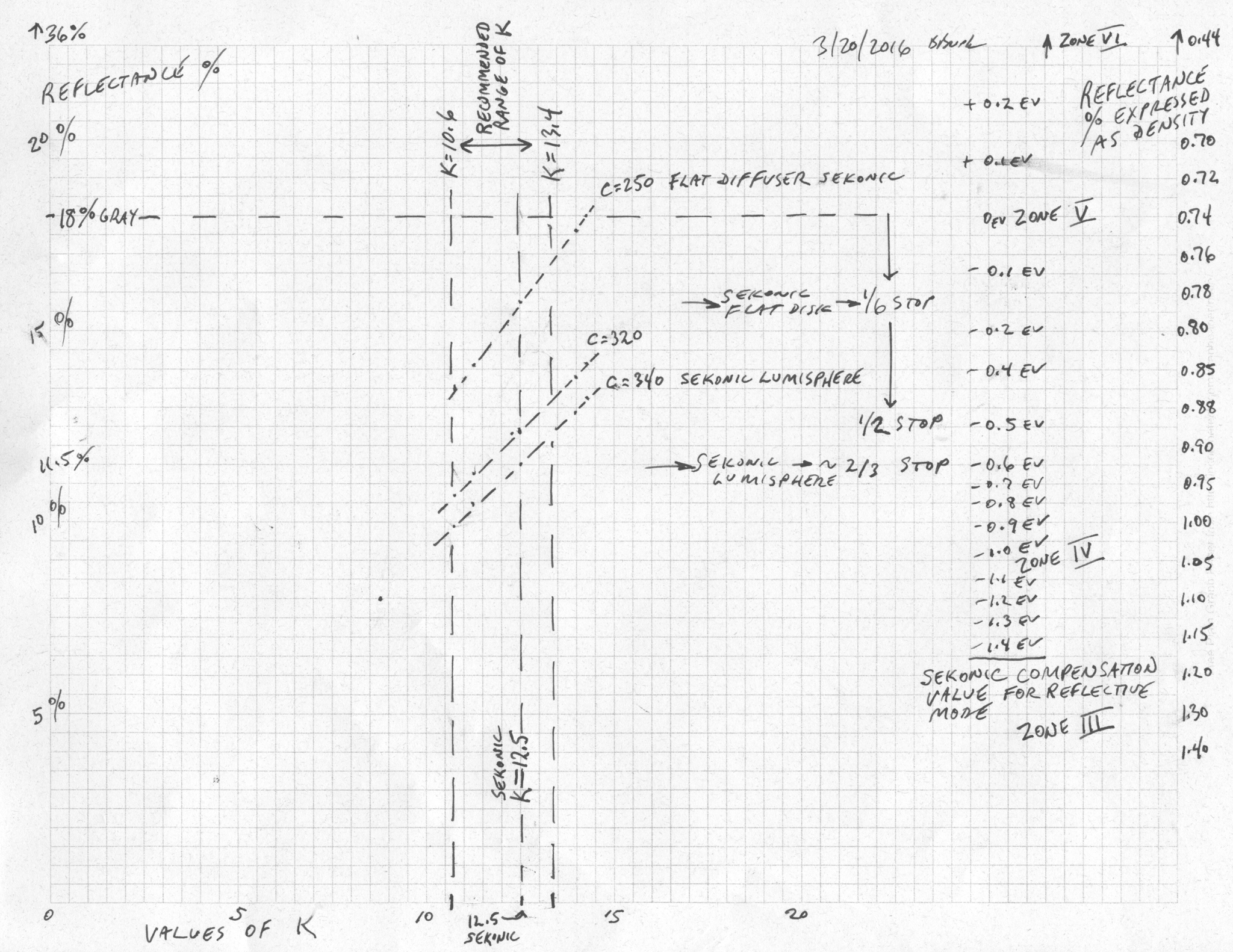

I graphed the chart of K and C values given at http://dpanswers.com/content/tech_kfactor.php and added some pertinent labels.
I verified that when I set the Sekonic L-758DR exposure compensation in reflected light mode for -0.6 EV compensation... lumisphere and reflected light readings from gray card read the same as each other a few times. This suggests that if I wanted to make the incident meter lumisphere agree with 18% gray card, -0.6 EV compensation would do the trick. If I wanted to match the flat disk to the 18% gray card, I would set reflected light mode for -0.1 EV or -0.2 EV compensation.
I have not yet decided I really want to cancel this standard calibration to fit the idea that a reflected light reading of 18% gray card should agree with incident readings, so I reverted to 0.0 EV compensation.

With the flat disc your meter would read perfect incident and reflected with a 15.6% gray card because your meter has K=12.5. Which is --0.16 EV and that's why you sometimes get -0.1 and sometimes -0.2.

The graph that I drew illustrates exactly which shade of gray card correlates to three example values of C.
Also graphed is the EV correction from 18% gray.
At this point, I tentatively believe the deviation due to what Ansel Adams called K... amounts to -0.16 EV.
And anyone who has trouble getting an incident meter to agree with a reflected light meter should use the flat disk to compare the two modes... because I tentatively believe that using the hemispheric dome is just not the right thing to do when you want to compare to a flat gray card.
