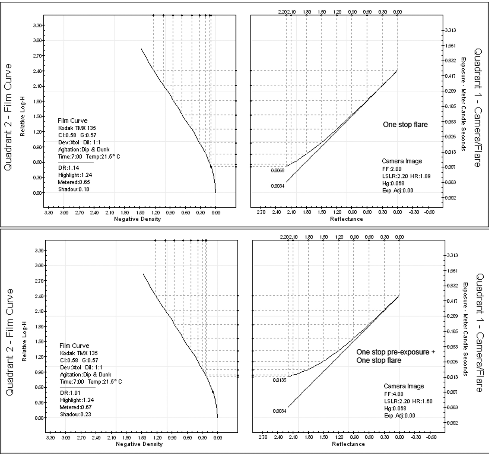

This is what Mark is suggesting.
The top example has one stop flare. The bottom has one stop pre-exposure and one stop flare. The changes are in the camera image curve and the exposure is superimposed upon a fixed film curve.
Mark, I think the situation is basically how the testing is conducted and semantics. If it's like the above or if there's an extra quadrant added for the pre-exposure curve, then you will have a fixed film curved derived from the standard sensitometric exposure. If the film is flashed before making the sensitometric exposure so that the test incorporates the low intensity reciprocity failure that will be experienced in practice (which also has the option of being another quadrant), then the curve will have changed in relation to the standard sensitometric exposure; however, the primary exposure will still be superimposed upon the film curve.
Yes, Quadrant 2 demonstrates what I'm suggesting. The film curve remains constant, the placement of subject matter changes.
