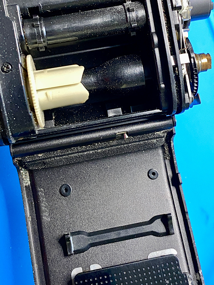

When removing the old light seals and any existing mirror shock absorbers, you have to be careful that none of the often sticky parts get into the shutter or onto other moving parts. First the rotten stuff sticks together and then it might get hard.

To get back to the OP, he described a condition of the light seals that no longer indicates 100 % functionality. hence time for service, today or tomorrow. Hopefully no important film will be damaged tomorrow:

Light seals and mirror foam aren't hard to clean off and replace, much less time-consuming, invasive, or costly, than getting a CLA. It depends on the camera, because for example many 35mm SLRs have a channel around most of the back that forms a labyrinth light trap and you only might have to be concerned about a piece near the hinge.
On the other hand, some compact cameras don't have a labyrinth and you do want some foam or felt on the back (for example the popular Canonet QL17 usually has some gooey foam residue on the back that should be fixed), or there is crumbly mirror foam that will be magically attracted to the focusing screen, like in Andreas's X-700.
For crumbly mirror foam like that, consider putting a drop of alcohol either on the foam or on the tip of a plastic spudger, and using the spudger to scrape off the foam residue. Do this while holding the camera up, lens opening down, so that all the scraped off gunk falls out and not into the camera.
