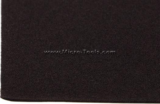

@Andreas Thaler on the topic of sourcing foam for this purpose, what would you recommend? Note that OP is in Europe like both of us.
This sounds promising (microtools Germany):
Light seal
Mirror bumper
They translate two different things to the same words. Close enough, though.

I also have to face the topic and have already ordered material for cutting from microtools.de. Up to now I can't say whether it's a good fit.
The challenge will be to cleanly remove the rotten old stuff and to cut the light seals to fit precisely and especially to completely replace them. The thickness of the stripes also has to be right.
It would therefore make sense to get a suitable set at the beginning.
