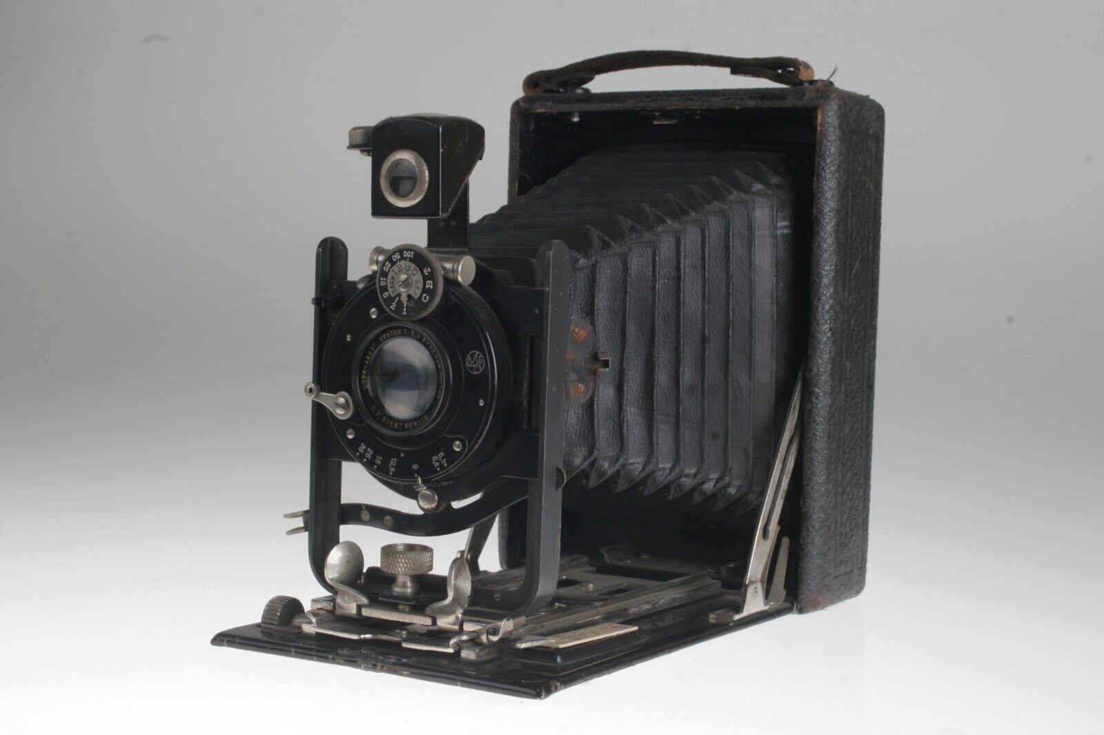

There's a Rodenstock 9x12 camera (Welta) with a 135mm f4.5 Eurynar listed at the moment, these are nice cameras. The screens on all pre-WWII camera are dim, I replace them in my cameras, and having a f4.5 lens compared to f6.8 makes a significant difference too.

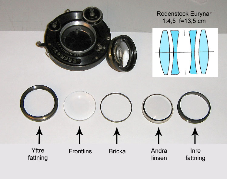

Many dialytes can be screwed apart so you can clean all glass surfaces. I could do that with the 4,5/135 and 3,5/150 Eurynar, but not with the 5,4/135 version. I have one 5,4 Eurynar with haze inside that can't be cleaned. 😞Just be sure that the lenses face the right way. I took pictures when I cleaned the Eurynars. Here is one of them I still have saved:

I hadn't seen that one, the lens on this one shows a lot less wear to the shutter and clean glass. You should be able to find a camera in much better condition, at a reasonable price.
That's a good one, and with the 4,5/135 Eurynar that takes the easy to find 37mm filters/lens hood.

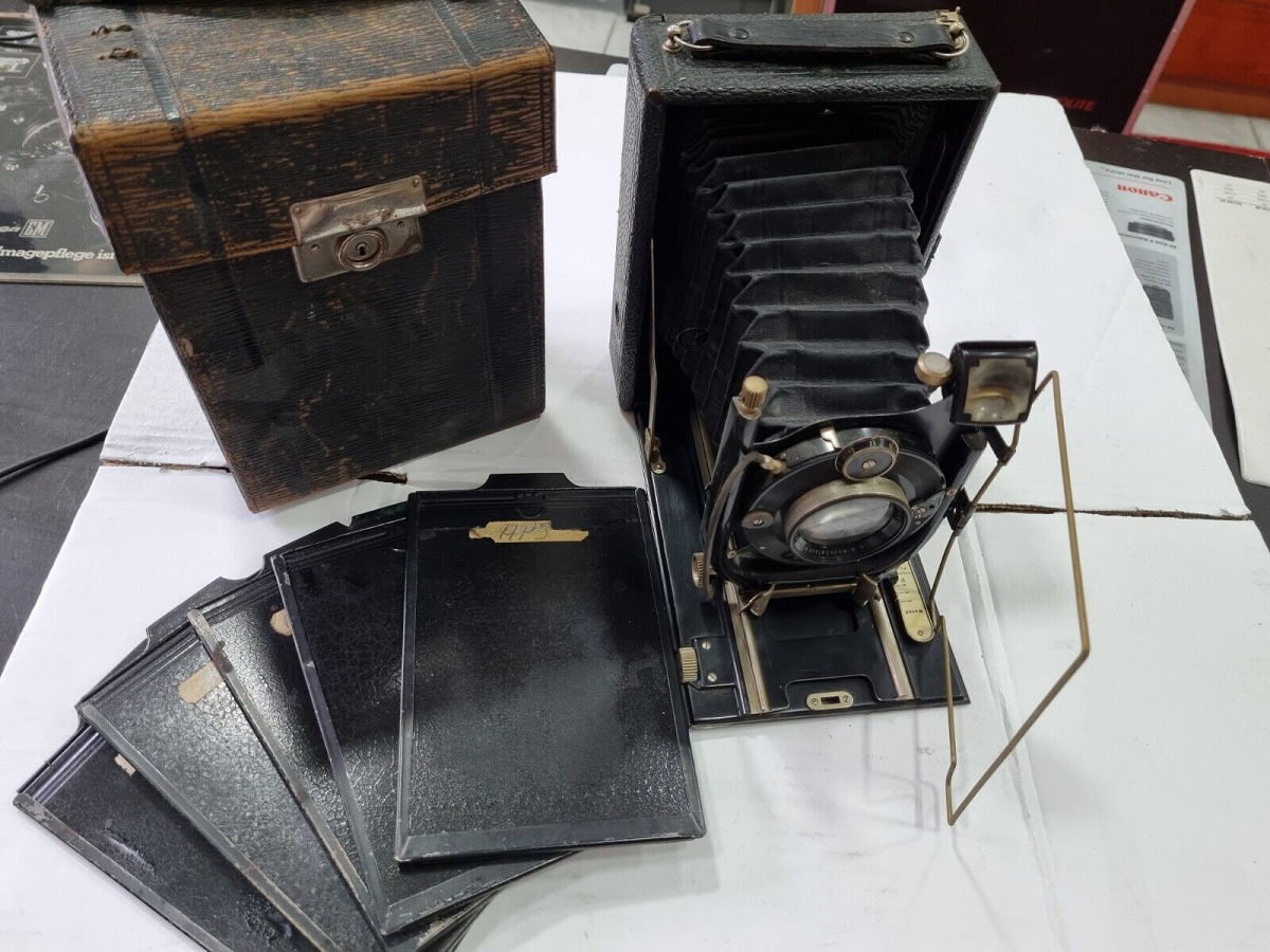

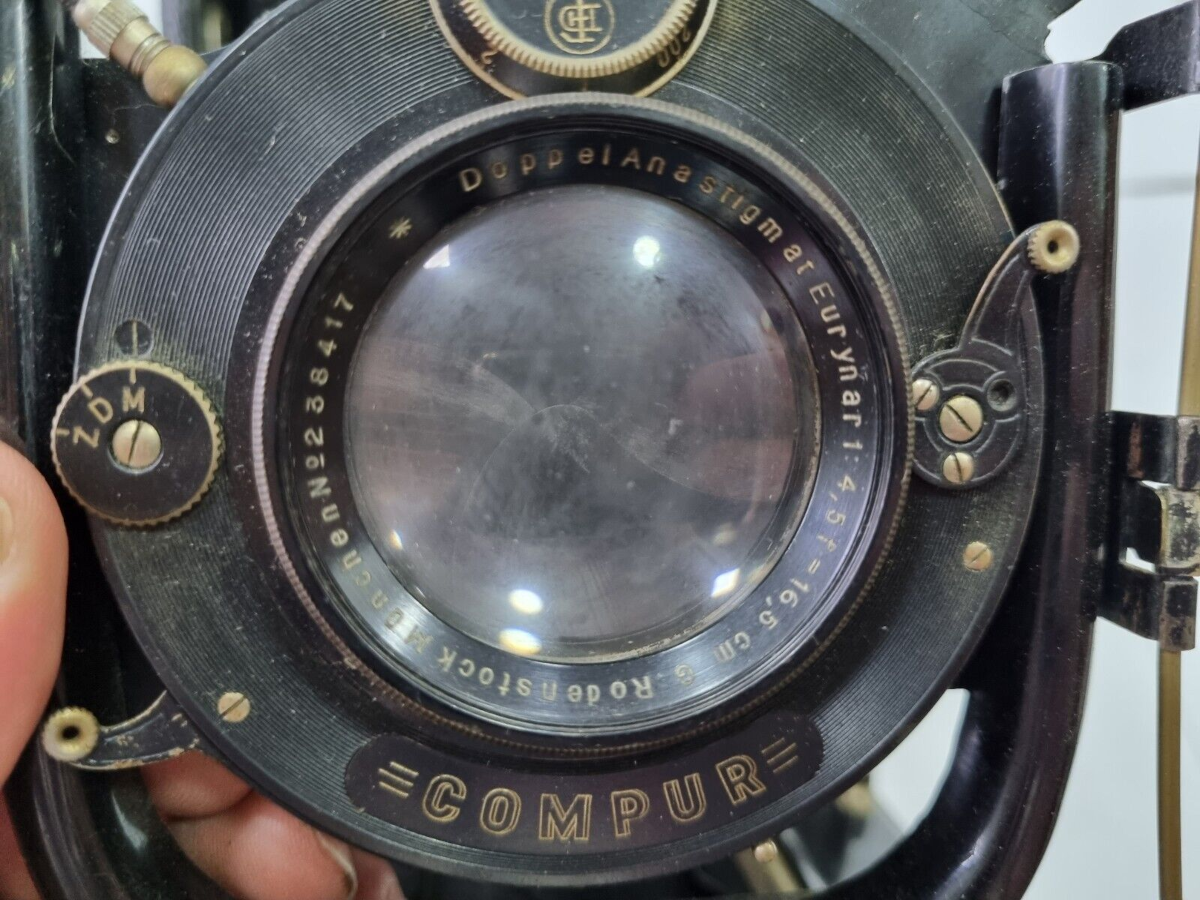

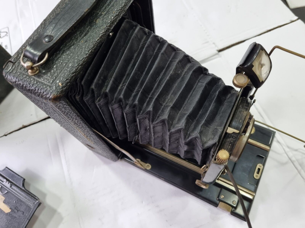

thing that is attractive is the focal length which is 16.5cm f/4.5 but other than that the camera itself need a good cleaning.
I think it's a 10x15 camera. Are you looking for a camera to use, or do you already have a LF camera and just want a classic lens?
