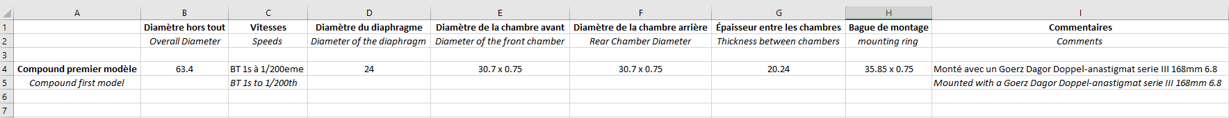

manage to find the details of this compound shutter. Seems it is not the standard one and may be its difficult to find a compur of this size.
It's best to be careful if the aperture blades are made of plastic or paper.
Yes, my advice was restricted to cleaning the piston, not the whole shutter ;-\
Why would you need a compur if you already have a compound?
