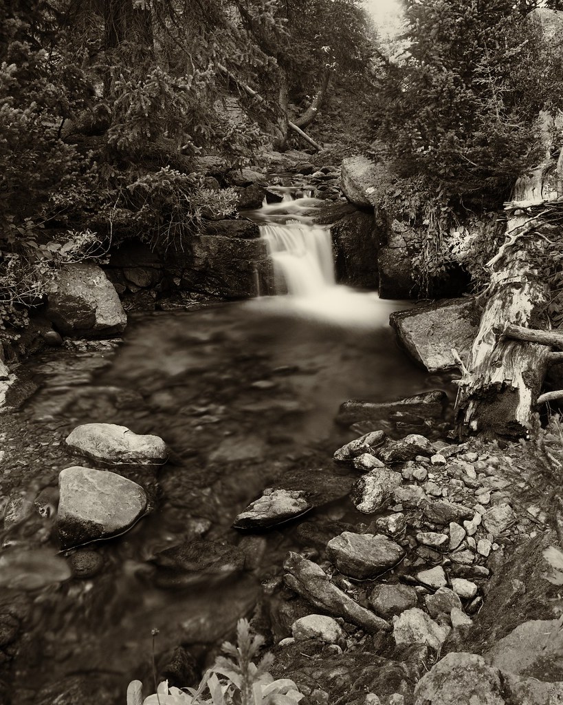

Here are a couple that I metered with the Pocket Light Meter app on my iPhone.
4x5 Korona, Fujinon 90mm f/8, Delta 100 in Pyrocat HD.
Old Fall River Road creek, Rocky Mountain National Park
Bronica GS-1 6x7cm, 110mm f/4 Macro, Delta 100 in XTOL.
Avalanche Creek 1, Glacier National Park
Since this thread is about the efficacy of the i-thingy meter, I have to ask is there any shadow detail on the negatives? Because on my screen the pictures look underexposed. I do quite a lot of very similar work under similar lighting and always get much more shadow detail. But then I have the disadvantage of using a 50+ year old LunaSix.:wink: And 100 year old lenses.
I know you're poking fun, but the 100 year old lenses themselves will help open up the shadows.
Well, yes and no. You still have to expose properly. The slight diffuse flare ( there's very little with a masked compendium and only two internal surfaces) will help get the film off the toe of the curve, thus opening up the shadows a bit. It's one of the reasons I use the lenses, that and the smooth tonality.
I get good shadow detail with the set of modern coated lenses which I use on 4x5, too. And then there's the possibilty that it's something to do with my monitor, or the contrast range the poster chose.
But if that's what is on the negatives, the shadows are underexposed, and the contrast range of the scene is such that it isn't neccesary.
That's what I meant. I gain effective film speed increase of about half a stop with older lenses, compared to newer ones.
