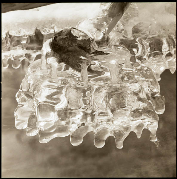

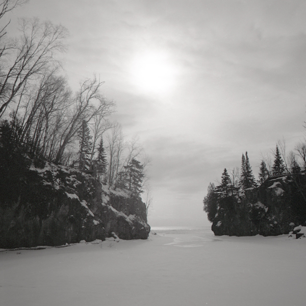

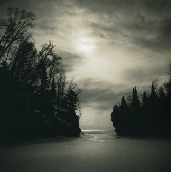

I've found great value in seeing how photographers work up a print from a negative. I thought a thread showing a raw scanned negative paired with an interpreted print (or possibly multiple interpretations) would be informative. A brief description of materials and printing steps might also be of interest.
To start things off, here is a recent example taken along one of my favorite places to photograph, Eagle Creek.
Full frame square negative on the left: Ilford Delta 100 developed in Pyrocat HD. The brownish cast to the scanned negative is typical of film developed in Pyrocat HD, a staining developer.
The print was made on 8x10 Kodak Polymax FA paper using a #2 contrast filter (Zone VI cold light head with V54 bulb).
  • The negative was cropped from the top to remove the dark triangular portion of a branch that didn't belong in the print.
  • After the main exposure, the highlights along the top LH edge were burned in for 1/3 stop using a card with a hole. This was to balance the left and right hand sides of the top edge.
  • The lighter portions of the water on the LH side around to the bottom middle of the frame were burned in for 1/4 stop using the same card, again to balance the water across the frame.
  • The water was burned in 1/8 stop to deepen the tones slightly in contrast to the brilliant ice.
  • The processed print was toned for 2 minutes in selenium 1:9
  • After thorough washing, the print was lightly bleached and then toned in thiocarbamide.
Print on the right
I hope others will share some of their examples.
All the best,
Daniel

Danial,
Thank you for starting this thread. I found it to be most informative, especially to this B/W noob whom is caught up in an internal debate over scanning vs. contact proof printing. After seeing this post I think the $30 contact printer is winning over the $500 scanner.
Terry

Hi Terry,
I use both negative scanning and contact proof printing in my work flow, so it's not an either/or proposition. In fact, negative scans can be very useful for experimenting with manipulations I might want to use during the actual printing stage.
I don't have a particularly fancy scanner, since my final work product is a wet darkroom print.

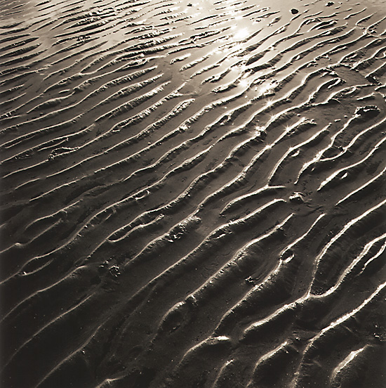

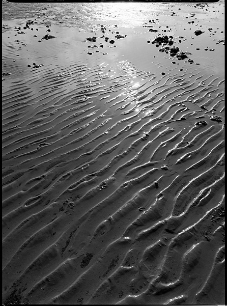

Late Afternoon Sun ~ Sand patterns
Hi Daniel
Great Idea for a thread. Here is my contribution.
The Negative
Made with my Pentax 645n2 and a 75mm lens. The film was Delta 100 and it was developed in Pyrocat M. Most of my images are already made in my head. I then wander in the landscape looking for them. This negative was made on the August APUG weekend. It was about 4pm and the sun was low in the sky. I remember being quite excited by the sand patterns as I walked the beach with Ailsa McWinnie. The composition I was looking for would not come easy as you can see in the neg scan that the beach is dotted with ugly stones. In this situation I usually find that it is a good idea to step back a few yards and take a wider view. The rest of the visulisation can then be done after the negatives have been developed.(Post visualisation) I new from past experience that by exposing for the shadows, the sunlight glinting in the wet sand would burn out, and be paper white in the final print.
The Print
I was not disappointed with the negatives, though it was quite hard work looking for the final print in them, as at the time I did not have a negative scanner. It involved carefully studying them on a light box, which can be quite tedious. Once I had made my choice of negative to use. I made a full frame print. It was then just a case of using some lengths of mount board to mask of the print untill I saw the composition that I would finally go with. It should be noted that this is a process thet should not be rushed. Every ripple in the sand is exactly where I want it to be and I go to great pains to replicate them when I reprint this photograph.
The negative was printed at grade 3 as I wanted the print to be quite High in contrast. It was important to me for the shadows to be right on their limit when it came to detail, and the highlights to 'SING'
  • The top of the print needed to be burnt in for 1/2 stop at grade 3
    The top right corner was burnt in for 1/2 a stop and the bottom left corner was burnt in for 3/4 stop, both at grade 3. This was to naturally frame the sunlight that travelled through the frame from top left to the bottom right corner.
    The final print was lightly bleached and then toned in a home made theo toner. This was heated up to about 35 degrees as I find it gives me a warmer sepia than at room temperature. After a short wash the print was then toned in selenium at 1-9 for about 1 1/2 mins.
I am really happy with the final print and I know it sounds corny, but it is exactly as I saw it before I found it (in my minds eye)
Best
Stoo
P.S The final print shown is a scan of the final print, not a manipulated neg scan. The tone is quite faithfull to the print.

Stoo,
This is a beautiful print. Thanks for posting. I think it's a wonderful example of "post-visualization". It also demonstrates the importance of not allowing the dimensions of the format to constrain your vision.

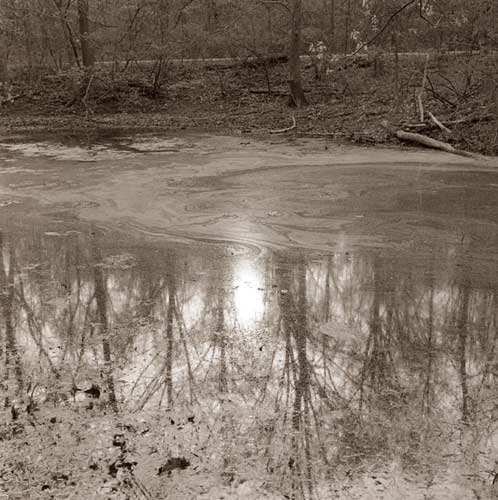

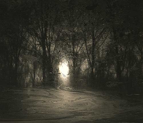

Here is an example of an interpretation that is quite a departure from the straight negative. This scene was photographed in the morning at Lilly Pond in Eagle Creek Park, which is close to where I live in Indiana. I often drive through here on the way to work and get out for a quick walk if the light is interesting. What caught my attention were the swirling patterns in the duckweeds growing on the surface of the pond.
Looking at the negative scan and playing around with levels allowed me to explore different possible interpretations. For me, this is one of the most powerful and time-saving aspects of working with a scanned negative image on the computer. I can play around with cropping and manipulate tonal representations, even with my most primitive computer skills, which can save an enormous amount of time, not to mention expensive paper, in the darkroom. It also allows me to visualize extreme changes that I might not consider otherwise.
Negative: Fuji Acros developed in Pyrocat HD
Paper: Ilford Galerie Grade 3 developed in ID-62
For this print, I've flipped the image vertically and cropped from the square to remove extraneous elements.
• The image was printed down quite drastically to create a more somber mysterious mood.
• "Foreground" swirls were dodged during the main exposure
• Top, left and right hand edges burned down after the main exposure
• Processed and washed print toned in thiocarbamide using a presulfiding step, i.e. brief soak in the thiocarbamide toner bath prior to bleaching.

Daniel
That is quite an amazing transformation from the original. I have recently adopted the use of a neg scan to see if i can take a print that little bit further. I have to admit though that I have never moved as far away from the original as you have here, though, knowing your skills in the darkroom, I am quite sure that you had this final vision of the print long before you opened the negative up in photoshop.
I used to be quite sceptical of people who posted neg scans in the galleries, but since adopting this way of working I was very supprised to find that there is not anything I can do in photoshop that I can't do, and probably better, in the darkroom (with a printable negative)
Thanks for sharing this beautiful image.

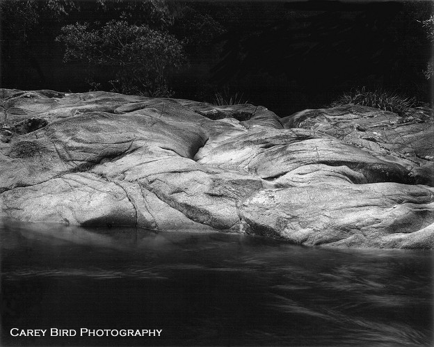

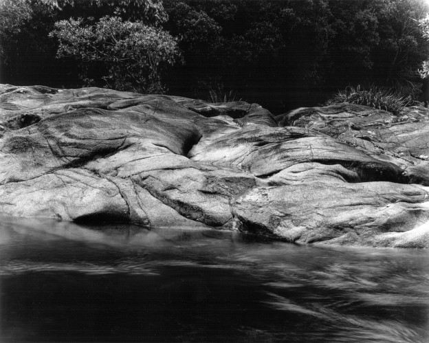

Thanks for an interesting thread Daniel. I've enjoyed others' contribution so lets try and reactivate things...
Here's a fairly simple example of some selective burning. The first image is a straight print from the negative. The second image is the finished (manipulated) print - well, as it presently stands anyway... :wink:
The grain of the rocks on the river bank was what initially caught my attention, and I've attempted to emphasise them by significant burning of the bush above the rock, and a bit of burning of the flowing water in front of the rock. I didn't want to completely loose the bush although that could easily be done. Corner burns and burns down the left and right edges complete the current printing strategy (although I'm still working on it).
Never Never Creek, NSW Australia
150 Apo-Symmar on my Technika with APX100 in the DDS
Dev Rodinal 1:50 for 10mins
Both prints on MG IV
The bush and water burns are both 1 stop.

Carey,
Thanks for posting your examples. It's quite a lovely scene.
I had a couple questions regarding the burning sequence you've described. Are you using the same contrast filter as the main exposure for the burns? It looks like the foreground water was burned in using a lower contrast filter to bring down the highlights without pushing the tones in water down too far. Retaining detail in the background, which works here without competing with bright rock textures, can be achieved this way too.
All the best,
Daniel
Seabird
Jun 13, 2008
112
Sydney, Aust
Carey,
Thanks Daniel. I like it too. :tongue:
All exposures were with the same contrast filter. I use an old D2V with condensor head so the filters go in the condensor "drawer". I've always been paranoid about changing filters for fear of moving the head/inducing vibrations etc... But thanks for the tip, I may have to get over my fear and try your suggestion next time round.
And thanks again for starting a great thread.:tongue:
Cheers
Gim
