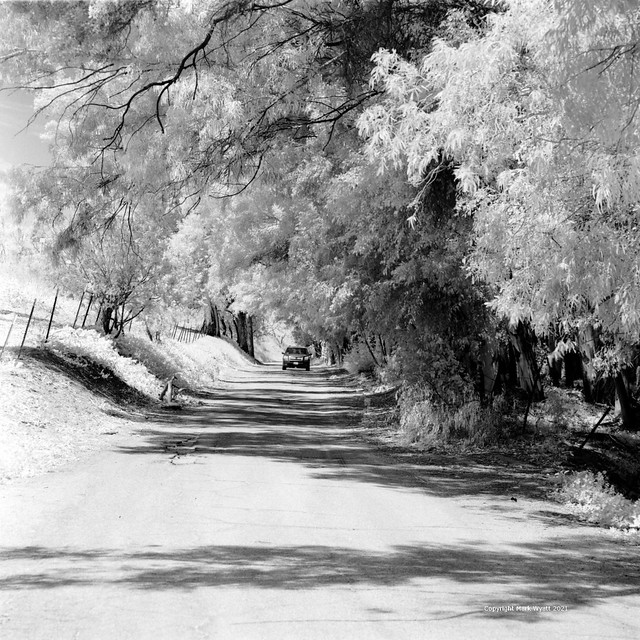

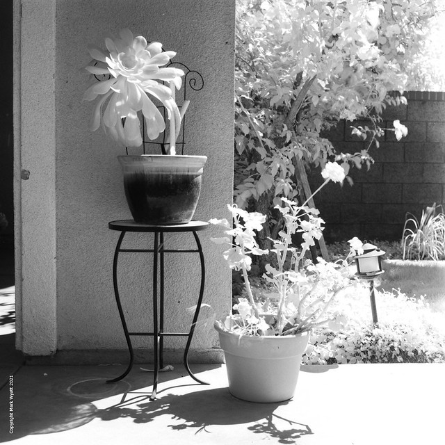

I have shot two rolls of Rollei IR400 (Agfa produced) in 120, and used those two settings. I liked the 5 stops (equivalent to external metering at ISO12 with the R72 on the lens ) better than the 6 stops (equivalent to external metering at ISO 6 with the R72 on the lens). Both were good, but I lost more of the highlight in NIR rich areas with the ISO 6 equivalent. I know the proper way is to meter at ISO 400 (again external, not through the lens), then open 5-6 stops, but these are equivalent. With the Gossen Luna Pro SBC you could also set to ISO 400 and then set the VF ring to 32 (5 stops) or 64 (6 stops); though IR film is usually used under sunny 16 conditions anyways, so often no need to meter. In sunny 16, I think I used f16 (get DOF due to possible small focus shifts) at 1/8s for the 6 stops and 1/15s for the 5 stops (on a tripod of course). The Lee filter may be too radical for this film (Rollei IR400), maybe more suited to Kodak High Speed IR or Efke IR820 (if you could get either!); though if the published spectral curves are correct, with enough exposure (and accounting for reciprocity) you should be able to get an image. The Rollei IR400 I have was made in Beligium by Agfa (expired 2015). The newer Rollei IR400 is probably produced by Inoviscoat, and is purportedly the same emulsion.

6 Stops (ISO 6 w/R72):
Potted Plant
by Mark Wyatt, on Flickr
5 Stops (ISO 12 w/R72):
Surreal Country Road, Car

6 Stops:
Potted Plant
5 Stops:
