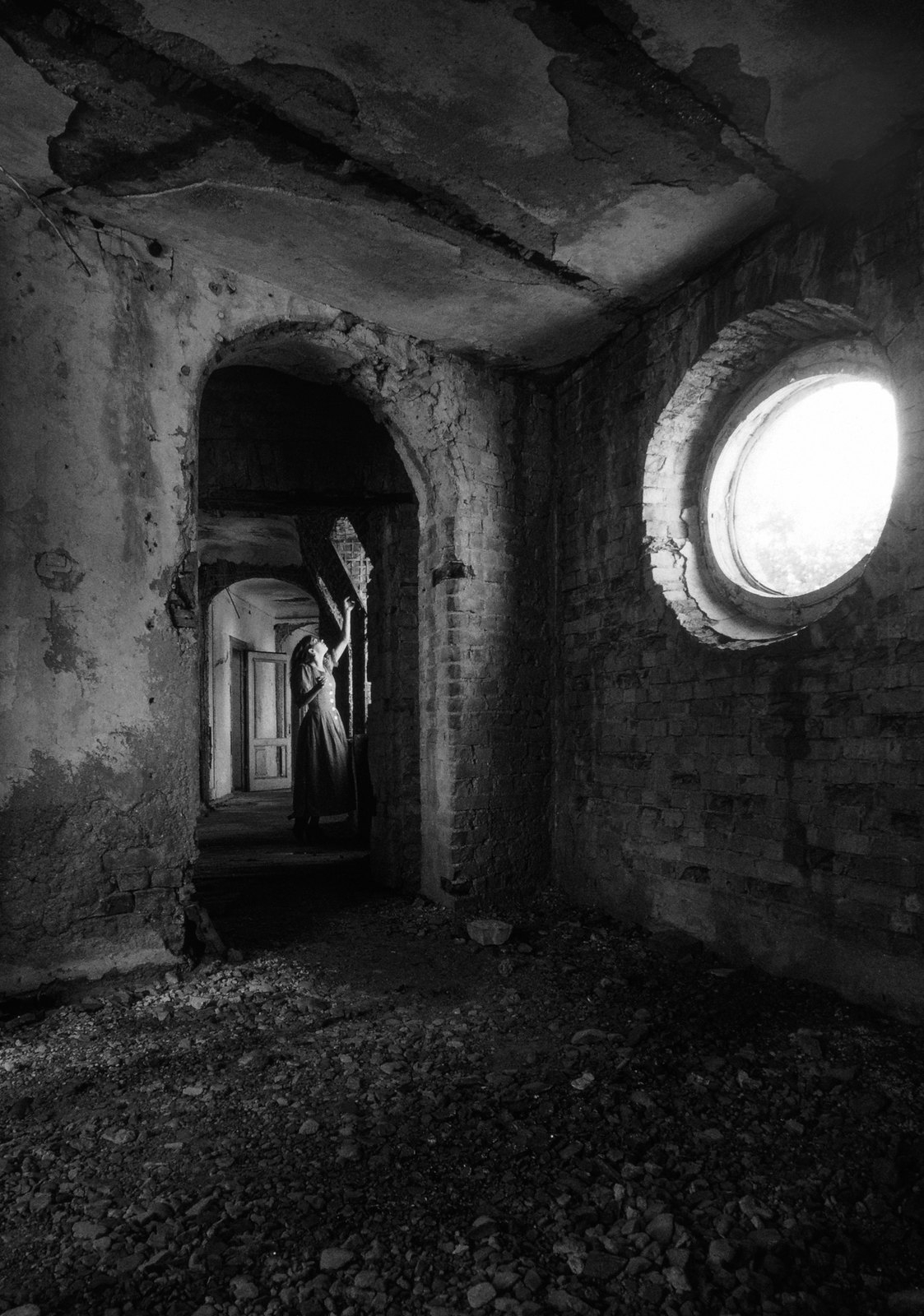

Here are my examples. Including IR shots in abandoned premises with very much limited light, of course. What I've found out is you cannot approach it with standard filter factor method too. It all depends on the intensity of light we cannot see, that behaves interestingly, thus bracketing is a must.
If you measure blue skies and make +5 stop exposure compensation and shoot that sunlit scene, you will be on a good track. If you, however, measure shadows a minute later and add same +5 stops, it'll be too much - overexposed. So there's something nonlinear going on to master : )
Rollei Infrared 400 shot indoors with no artificial lights. 2 second exposure at f/4, metered at 400. Looks like I could meter it at 200 or even 100 indeed, thanks for this info and I'll try that the next time around.
A closeup in shade. Half a second at f/8
Morning light, 1/4 at f/8 and CPL. Two filters stacked.
This is one of my most overexposed one's I've kept. 1/15 f/5.6
