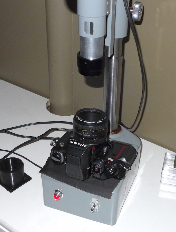

One would use an autocollimator (or distant object) and a known good body and/or known good lens to diagnose the issue.

Possibilities are as follows and one would need to use the usual testing to elucidate the problem:
a) Lens infinity stop is wrong
b) Lensmount to film plane distance is wrong
c) Mirror angle is wrong
d) Focus screen distance is wrong
Curiously I have about 30 Nikon bodes and about 30 Nikkor lenses. None have ever tested wrong at the 4 points listed above.
Other brands....yes to all 4.
