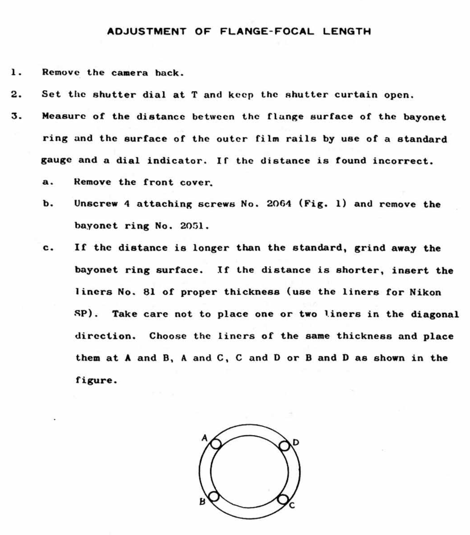

In the case of Nikon F or Nikkormat, how would you do this? Mirror angle adjustment is straightforward, but I don't recall seeing any shims used where lens mount meets mirror box casting, or where mirror box bolts onto main body casting. And those mirror box castings are pretty stout, and do not seem designed for bend-to-adjust alignments.
Clip from the "F" service manual. In addition to using a dial indicator, one can also use a "standard" lens that is correctly set to infinity and read the flange-focal length error off the autocollimator scale.
