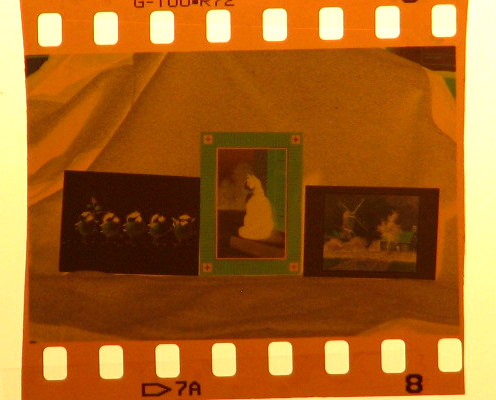

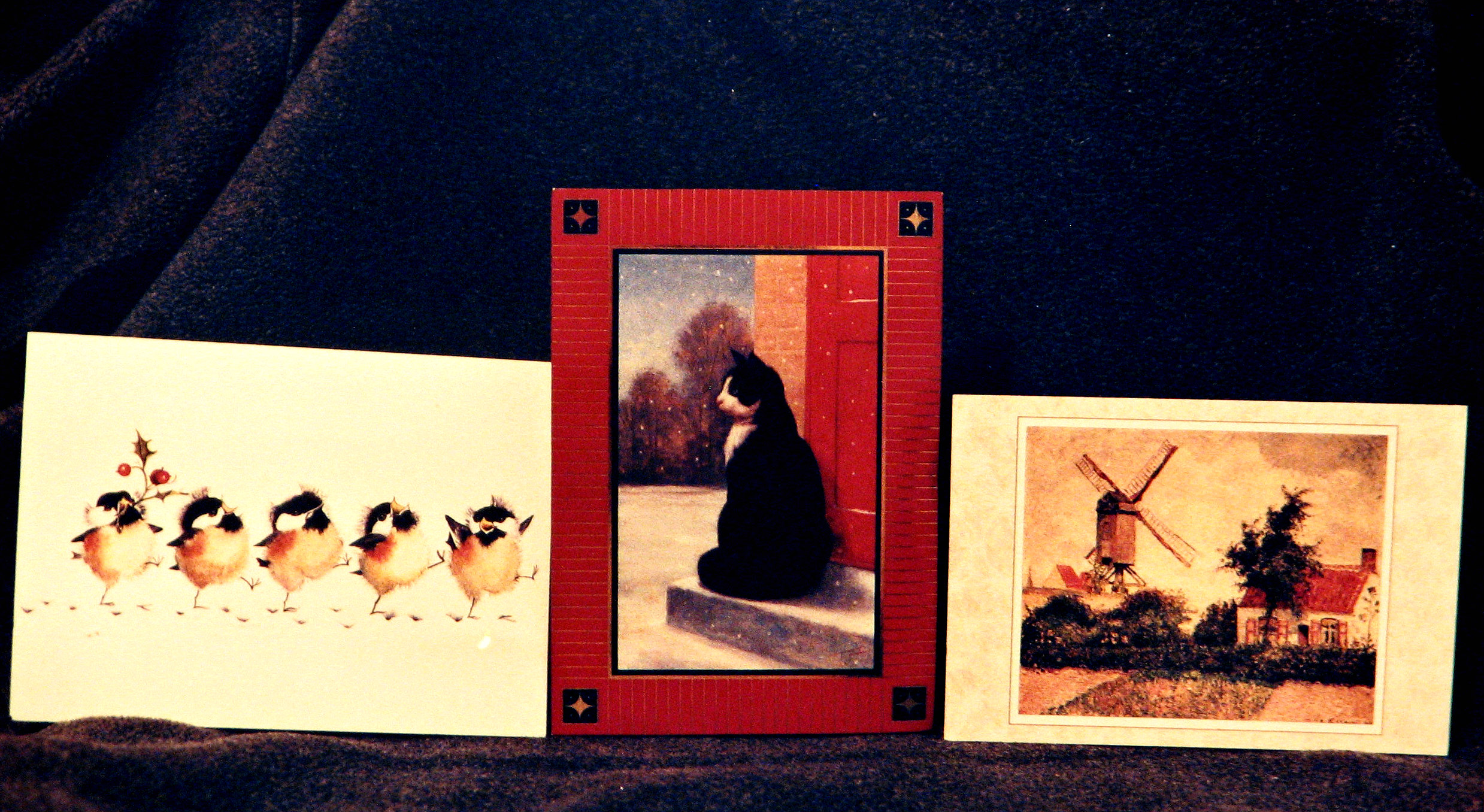

greeting cards.JPG color negative.JPG View attachment 168261 View attachment 168262 View attachment 168261 View attachment 168262 View attachment 168261 View attachment 168262

Last evening I photographed three greeting cards under tungsten light. No filtration was used for the exposure on Fuji Super G+ ISO 100 film. The film 'expired' in 1998 but was kept cold and retains all its speed. It was printed on Fuji Crystal Archive.
NO sensitometric tests were done; only my eyeball.
