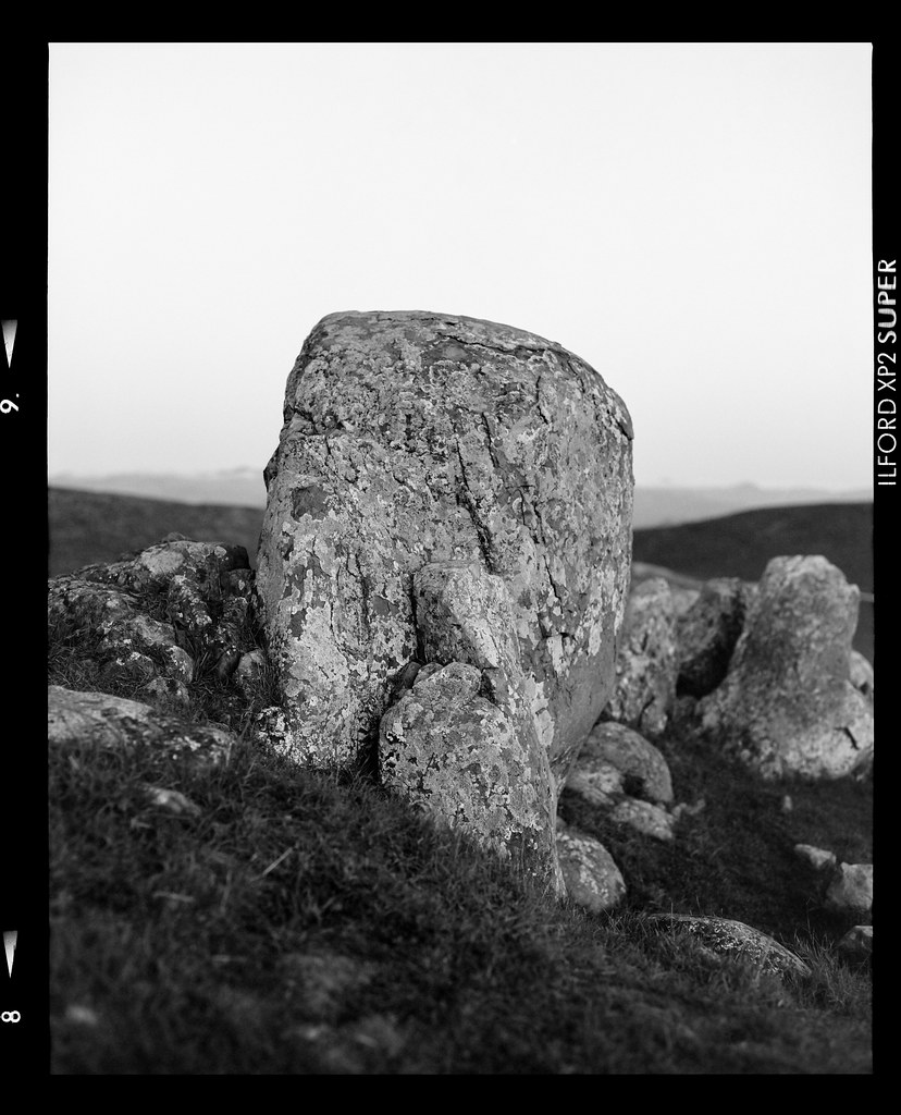

@RalphLambrecht : I think you're referring to this article by @drmoss_ca who shared some of his recent work (XP2 Super in Diafine) earlier in this thread. As you can see from the examples he shared, XP2 Super gives superb results in B&W chemistry. One has to give a stop more exposure than box speed to get best results.
Slightly less exposure would have held details in the highlights, perhaps.
Even in color, it's usually necessary to reduce exposure a little (i.e. expose at higher EI) when using bleach bypass, because of the density of the silver image. When I shoot XP2 Super for bleach bypass, I use EI 800, but I won't claim that's "right" -- I tend to use a higher EI than other folks for other films, too. EI 500-640 is probably a good compromise value if you meter the way most folks do.
Very interesting! I saw the higher resolution version on Flickr and was quite impressed. Slightly less exposure would have held details in the highlights, perhaps.
I expected the highlights to blow, because bleach bypass. Predictable results.
I like the end result and will keep this in mind for the future.
