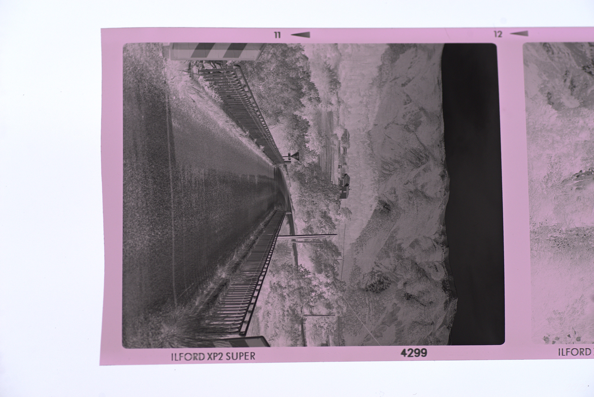

Is it possible for you to take a pic of this negative and share it here?
Here's a quick shot with my phone as a background light:
This is more than adequate. Thanks so much.
I was curious to see the shadow detail in the negative at EI:800. For a ISO 400 film, the loss in shadow detail at EI:800 is substantial though contrast is good. This is not surprising as my own experiments with this film in different developers suggested EI:150 for best shadow detail. Anything higher than 150 resulted in progressive loss in shadow detail. Now I wonder how C41 processing with bleach bypass fares in a situation like this.
It's overall pleasing enough that I really don't mind the loss of shadow detail. I will keep on using it at ISO400-800 personally as I have a use for this look.

I have absolutely no problem with that and by no means my previous post was a criticism of your EI for XP2 Super. The reason for asking you to share the pic of the negative is purely technical - what level of shadow detail does a chosen EI give us. There's definitely a style of photography that can get the best of XP2 Super at EI 400 and higher (in B&W chemistry) and I'm appreciative of it.

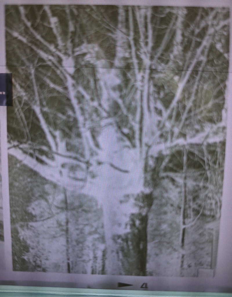

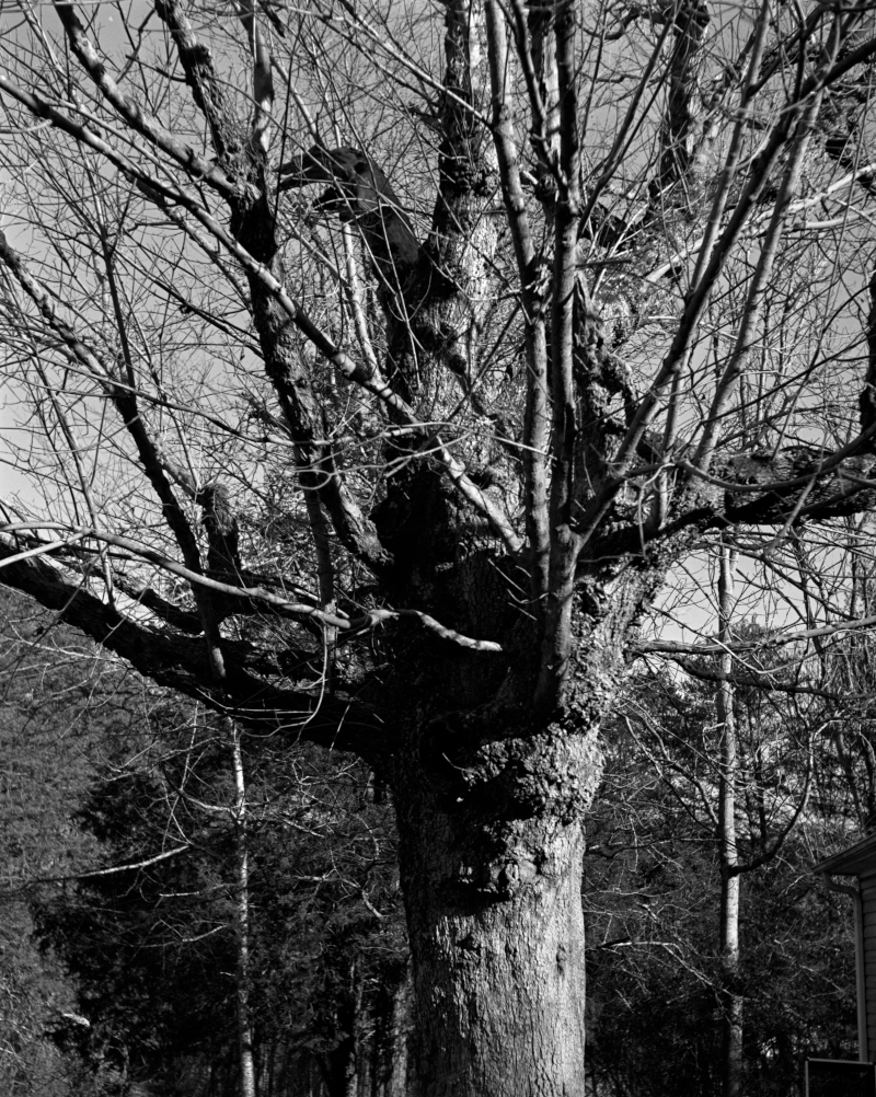

Okay, as promised, here's a scan and photo of the negative, XP2 Super at EI800, processed in Flexicolor with bleach bypass.
Mamiya 6, 75mm Zuiko f/3.5, XP2 Super EI800, Flexicolor bleach bypass
Please pardon the background texture -- I, too, have no light box (held the negative page against my screen to take the photo with my phone) Should give some idea what detail is present in the deepest shadows, though. High SBR here, BTW (hard sunlight, nothing to fill the shadow areas).
Pretty damn great for ISO 800 imo.
Which is why I'm paying a premium over my usual ISO 400 (Fomapan aka .EDU Ultra ) and processing the XP2 Super this way pretty much exclusively. Now, being a 645 negative helps some, but it's good even in 35mm (I'd have posted that, as a better comparison, but the only 35mm roll I found quickly was from my kit-built Konstruktor).
