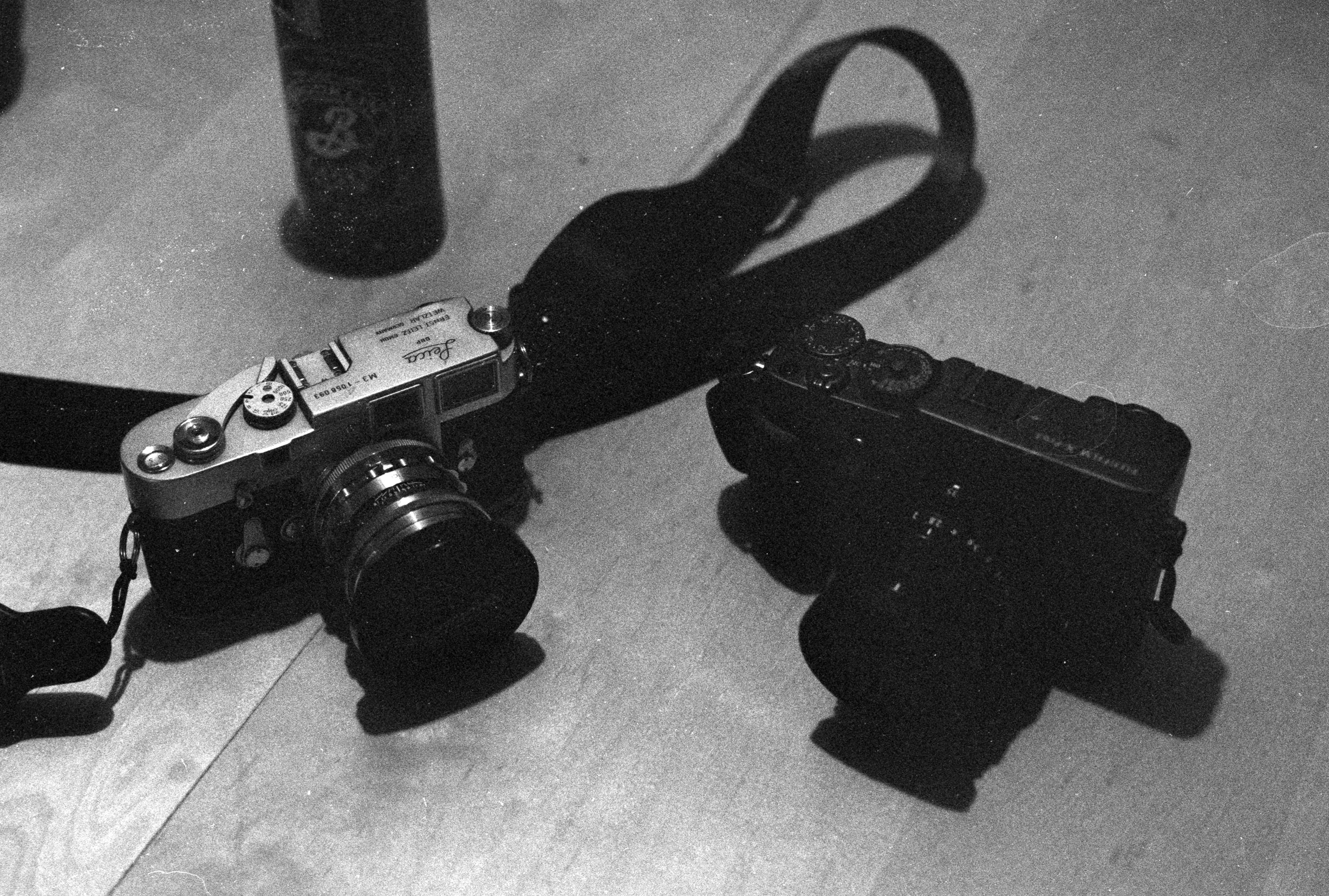

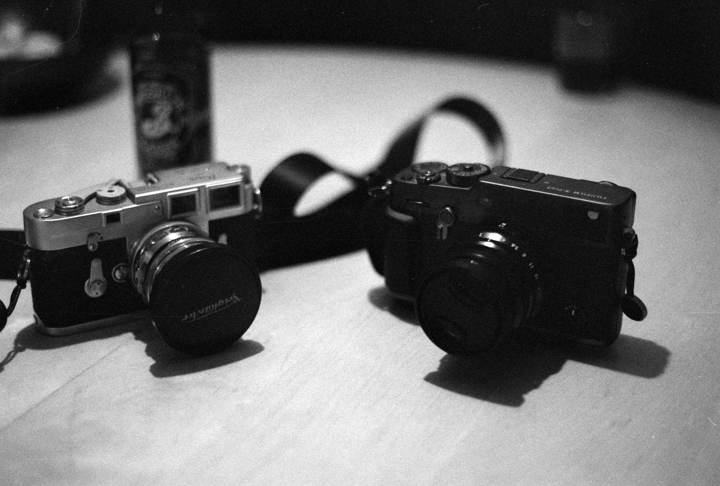

I wanted to do another test, but in lighting conditions where ISO 6400 would actually be more or less necessary when shooting handheld. The first attempt failed miserably as the negatives came out almost blank from a 1:500 dilution. While mentally recreating my steps I realized that I accidentally mixed my developer wrong in the first test, I mixed it at 1:100, not 1:500 as I stated in my original post. Making another attempt I mixed the developer at 1:100 and did another semi stand development for 90 minutes. These were shot at night, on my dimly lit kitchen table. The exposures were 1/180 @ f4 and 1/90 @ f2.0. For the first photo (1/180@f4) I measured and exposed for the table top between the cameras. For the second photo I measured the exposure for the Fujifilm camera, and manually compensated -1 step by adjusting shutter time and aperture (I did not use the exposure compensation).
Some conclusions:
  • When you say that the dog photo was in fact not exposed at EI 6400 (ambient), you are probably correct.
  • When you say that using the term EI to determine exposure isn't valid when spot metering, you are also correct.
  • Exposing HP5 at 6400 is still valid for me, using my method of measuring and photographing, regardless of what the actual EI turns out to be.
  • I should pay more attention when mixing my chemicals.
Here are the photos. I of course dropped the negatives emulsion side down and had to re-wash them. Some scratches, spots and drying marks, but you get the picture (pun intended).
