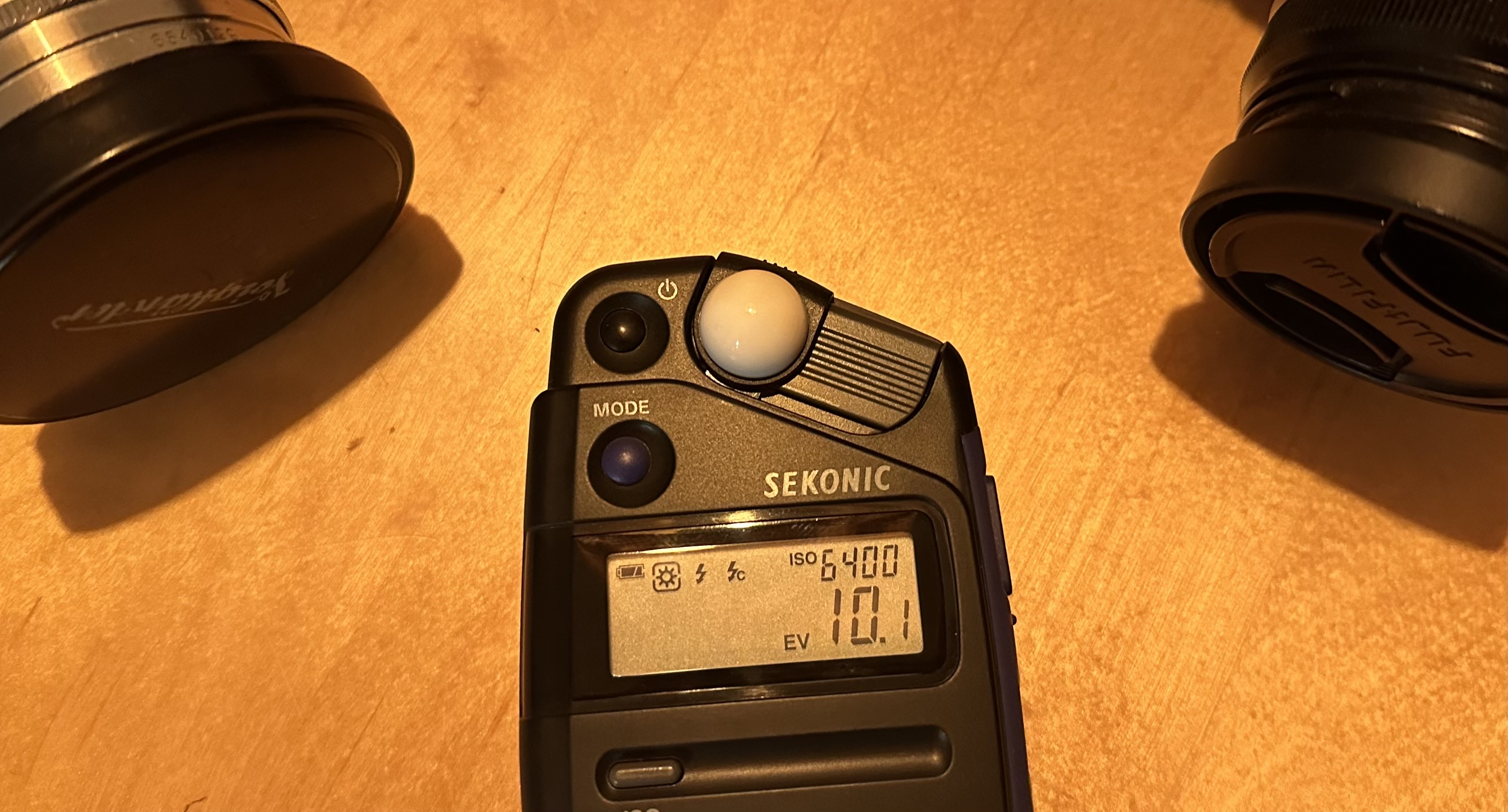

I can actually do that! I just picked up a lightmeter today, and I can easily recreate tabletop scene and light.

Here's the EV with the lightmeter flat on the table, pointing upwards towards the lamp. Pointing it downwards towards the table gives EV 9.1. Reflected light off the black camera reads EV 8.

Notice that the ISO on the lightmeter is set to 6400. If I set it to ISO 100 and take the same reading with the meter on the table, it shows EV 4.1. If I measure reflected light from the black camera at ISO 100 I get EV 1.4.
If I set the lightmeter to 6400 and f2.0 it gives me a shutter speed of 1/80, which is very close to what the camera gave me.

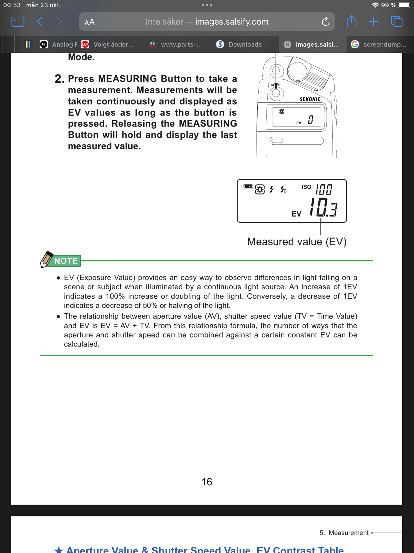

This is how the lightmeter works. If you insert my shutter and apperture values in the table, and compensate for ISO, you’ll see that the math adds up pretty well. It shows that the scene was exposed at, or around, 6400.
It even adds up with your calculator. Entering my values in the calculator that you linked to, we get the EV for the scene, 2.33. This would be at ISO 100, so to get to 6400 we add 6 EV steps. 8.33 is pretty close to the 8 (7.9) that the lightmeter gave me.

My meter read 10 on the table (9 when facing down), that’s where I exposed at 1/180 at f4 (EV 5.33 according to your calculator). The meter read 8 when reading reflected light from the black camera, where I used 1/90 at f2 (EV 2.33).
Your calculator gives the EV for the scene at ISO 100. My meter gives the EV compensated for ISO. There’s 6 stops between ISO 100 and ISO 6400. Add 6 stops to 2.33 and you get 8.33.

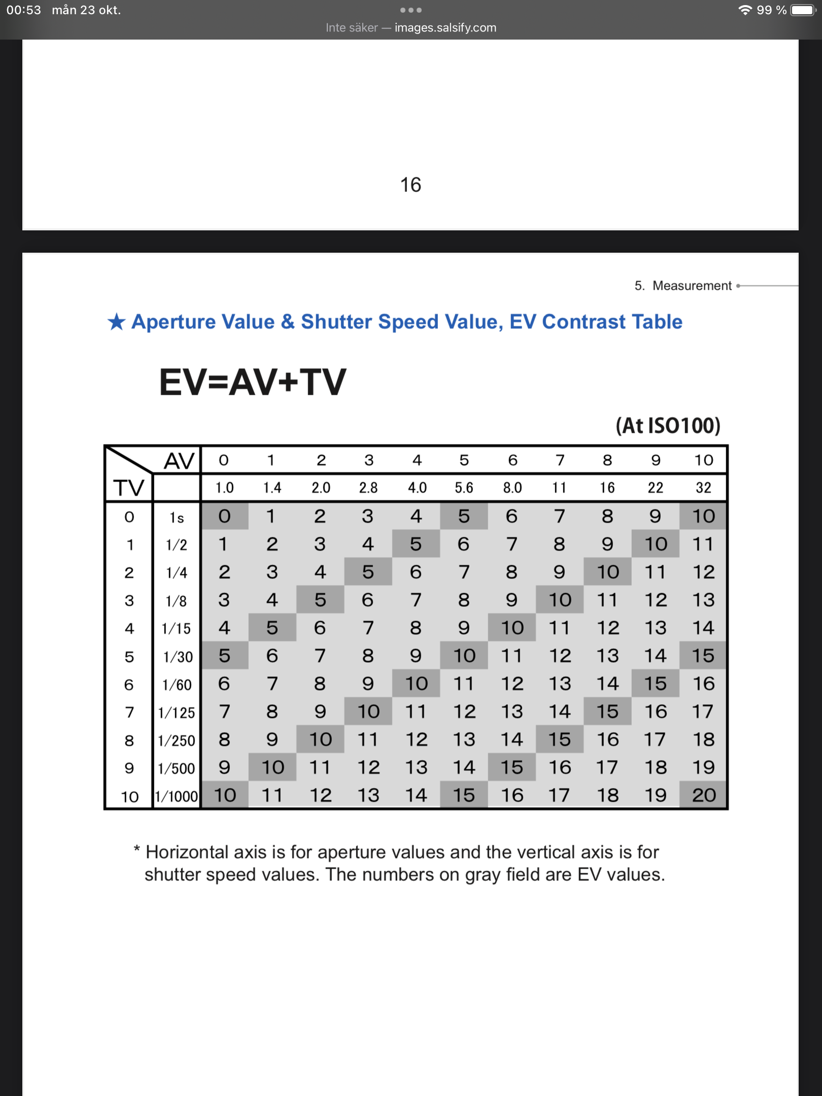

I don’t think you’re reading it right. Take the EV 2.33 and plug it into the table above. That gives 1/4 at f1.0 at ISO 100. I used 1/90 at f2.0 which is roughly 6 stops LOWER than 1/4 at 1.0. But I developed for ISO 6400, which is 6 stops HIGHER than ISO 100.
Go to the calculator I posted and enter your actual numbers. You’re getting confused by the chart and your conversions
