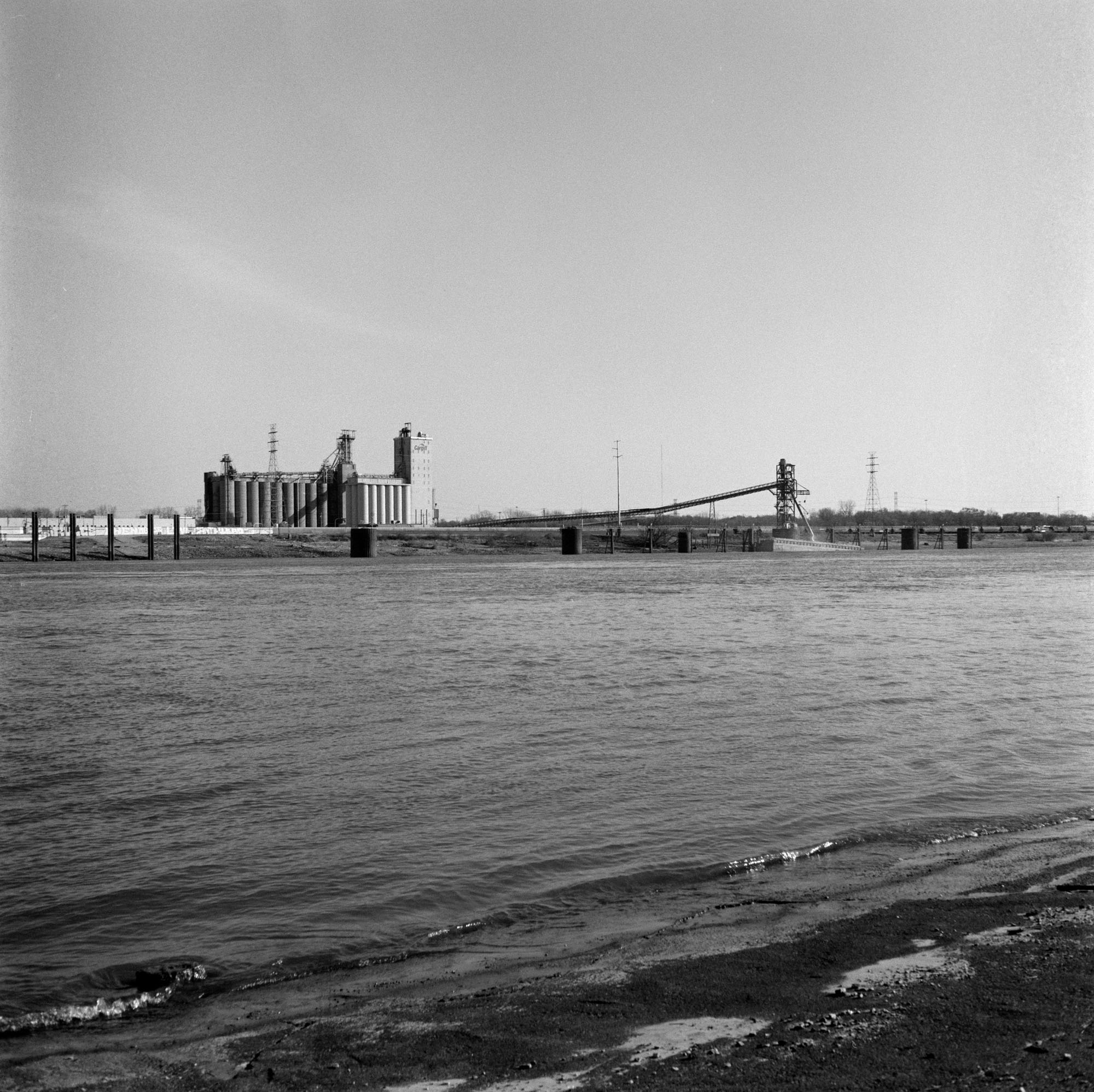

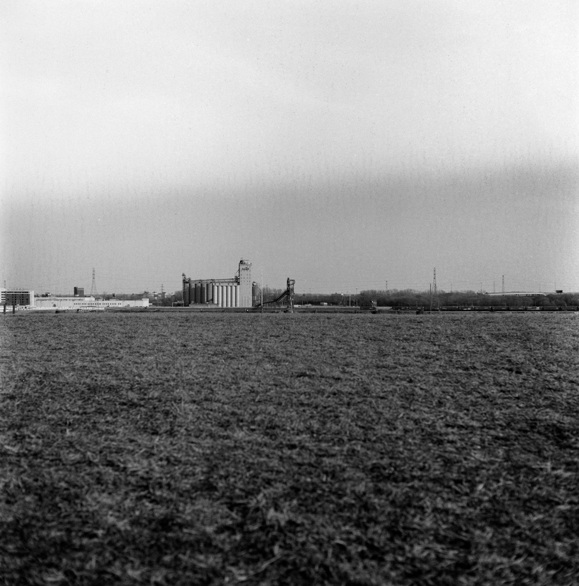

I recently processed a 120 roll of FP4+ that had some weird artifacts. The film was fresh when purchased, but I had shot half of it and then forgot about it and it was left for about a year in my camera. Everything looked decent when processed except for the last image that I shot had weird artifacts. The other images had some slight artifacts and seemed to be more grainy than it should've been, but that's probably just latent image loss or something similar due to it going unprocessed at room temp for a year.
Last image on roll showing weird stripey dot pattern
"mostly fine" image showing weird grain on edges of sky
Could this be an error on Ilford's part, or just weirdness from it being left in the camera for a year? The camera was pretty much kept at stable room temp the entire time and apparently had no light leaks, just this weird grain effect
That's what I was figuring, though the artifacts do look like a mild version of other scans here. I've never had similar problems with FP4+ before or since
Most likely this has something to do with the backing paper and film and atmospheric moisture all interacting under the influence of the film transport system.

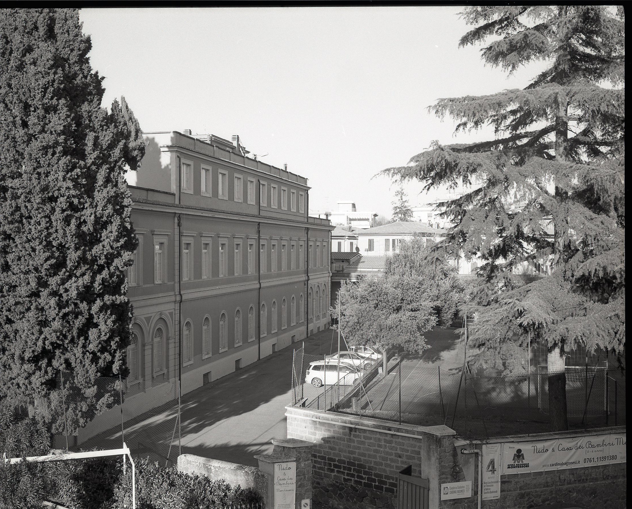

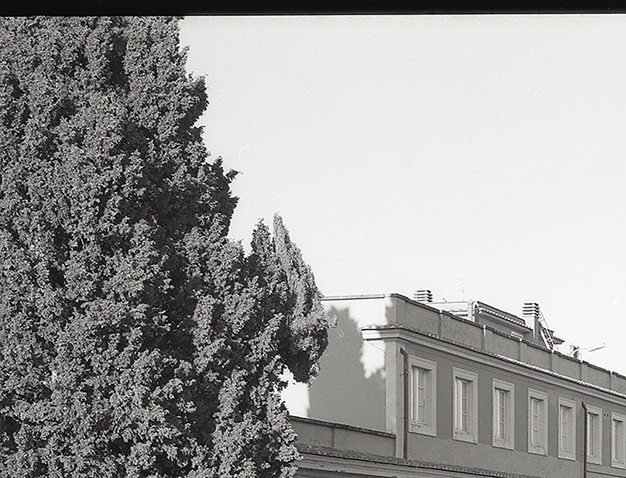

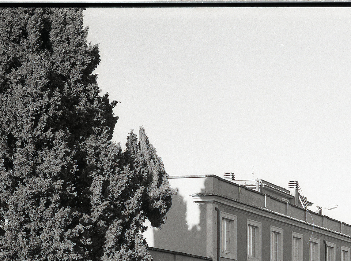

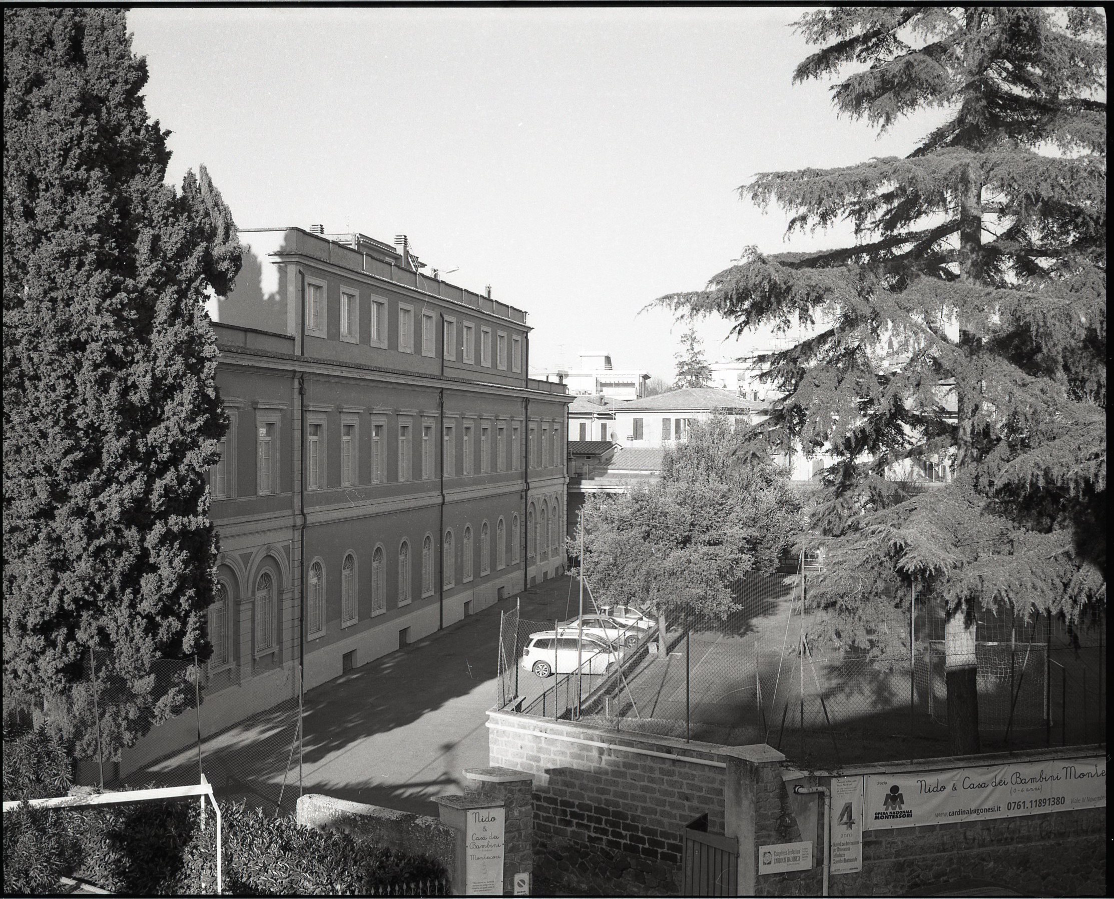

I ordered and received fresh FP4 120 films. I exposed and developed in the same condition the last roll from the "old" batch and the first from the fresh's one. What I did this time following
the suggestions of a friend:
1) "Manical" cleaning of the tank/spirals.
2) A more "calm" rotation of the tank during the process (in the past I always suffered of a lot of foam at the end of the developing process with HC110 dil. B).
3) As the last time I used deminaralized water for the whole process (Dev/Stop/Fix).
4) After the 20 minutes washing I put the spirals in deminaralized water and then I removed the excess of it with the fingers from the films.
So I now have 10 images with artifacts on the "old" film and 10 more or less perfect images on the "new" film. The artifact are less easy to find (need a lens) but they are on the old fim. Probably the more calm turning of the tank reduced the big effect I had this year during the developing of these films but in any case defects are there. Same effect had a friend of mine to whom I gave a film from the old batch: little, difficult to see but the artifacts are there on these films.
