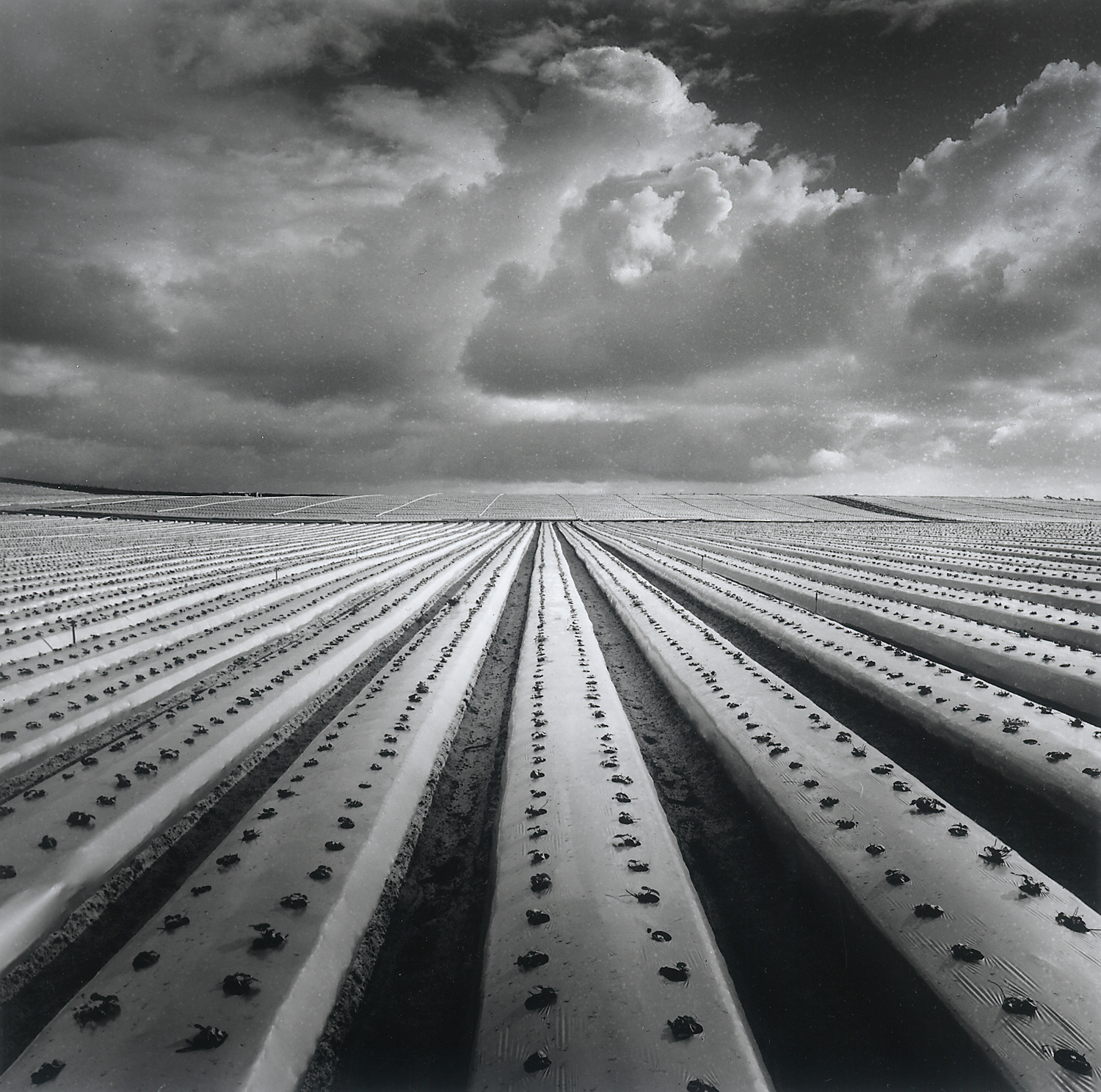

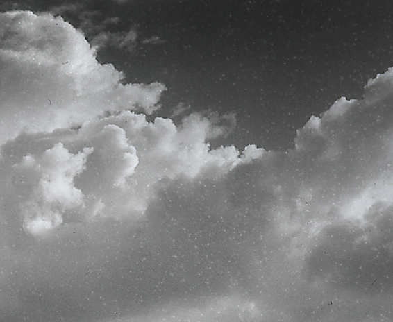

First post (not me), the first image image in the thread. Ilford SFX 200
I have talked to a couple photo store reps, though they are not Ilford reps. They all thought this and that and the other, (as eluded to by other posters here) but after some discussion, it seems that they saw it from my point of view: manufacturing defiects. SFX 200, Delta 400 and PanF 50. Surely there are others as well.
I develop two rolls at a time, in stainless steel tanks, and use fresh diluted photo flow every 10 rolls. The "mottled" parts are not dirt, debris, etc., and they are there on the film before it goes into the photo flow. The mottled bits are in the film, the emultion.
I will try to upload some of my photos scanned from RC workprints. The prints are not necessarily excellent prints, but they do show the flaws in the film and the horror of the retouching job necessary in order to have the prints made in the traditional sense. I am thinking somewhere from 30-40 hours of retouching per print.

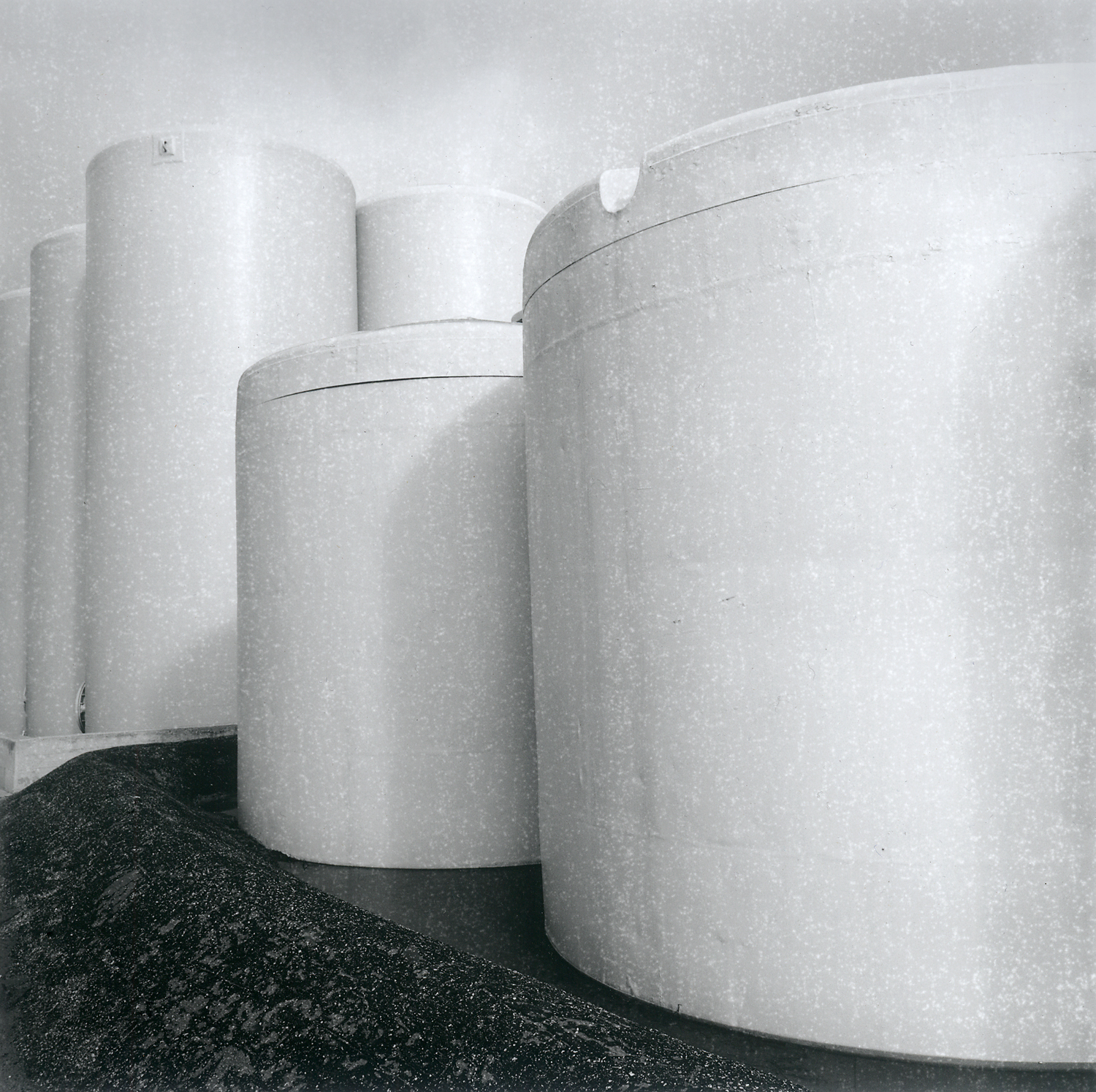

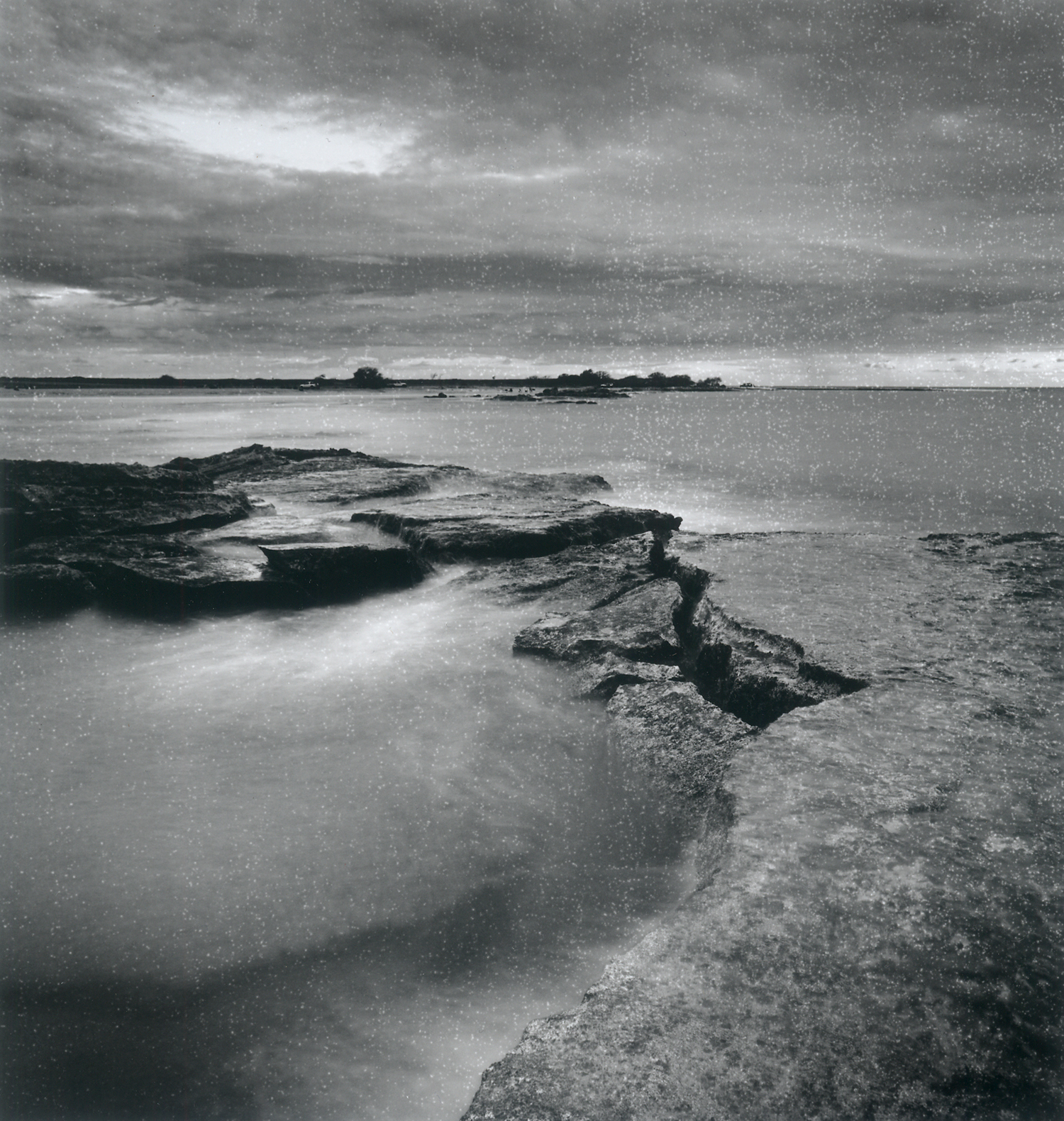

I have been using Ilford Delta 400 for about 28 years exclusively in Pyro PMK, and just began using Ilford PanF after my stock of Agfa 25 ran out (need a slow speed film of course). This is 120 format film film. When a photographer tests out a film, for exposure index, development time, latitude and grain structure, once they come up with something good, they tend to stick with it. It becomes predictable, reliable, especially in the long exposures where reciprocity comes into effect and when using the Zone System or Tone System (as I use).
Photo 1 and 2 is Ilford Delta 400, same roll of film. The other roll developed at the same time was not affected.
Photo 3 is Ilford Pan F, printed a bit too contrasty, (awful print really) but shows the damage. the other roll I develop at the same time was not effected.

I'll just re-emphasise what I posted in the other thread: none of the faults displayed are indicative of anything other than well known faults of 120 backing paper when exposed to significant & rapid temperature differences causing condensation or poor storage in humid conditions. The films listed as affected are slower moving products, thus likely to have spent longer on shelves/ in fridges/ freezers.
There is no evidence of wrapper offset like the issues Kodak was having. As much as I'm sure Ilford would like to know (if only to investigate poor storage habits downstream in the distribution chain), I suspect their response will be to the effect that the effects are characteristic of poor storage after leaving the factory.
That is how I interpret the sample photos also. I've had it happen to my film at times, and it was always atmospheric conditions (fog, cold) that introduced the problem.

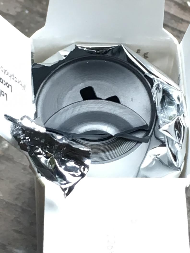

Question, when have you ever gotten a roll of 120 film that has a creased spool end cap? Hashtag never. Here is a roll I received as new. Quality control at Ilford has gone downhill, and I firmly believe changes in marketplace has lead them to cut corners in the traditional film marketplace. I have not found that with papers yet. Only film.
Check it out, sold as new! quality control issues? ummm, yes. And I believe it is running into the film coating lab too.....

I have proven their QC is not up to par by releasing a picture of a defective roll sold at market, damaged spindle. I wish it wasn’t true, but it is. I feel the QCextends through the process of making film too. They are letting substandard film out to the film buying public and it is not cool. Us, as photographers, not pixelographers, our livelihood depends on the film. And when we happen to get bad film we must speak up, contrary to what others think or experience, and let our voices be heard.

With the almost complete contraction of sources for backing paper, there has been a marked increase in reports of problems, with Kodak having the biggest problem.
The film substrate, emulsion backing paper and ink sandwich is susceptible to environmental factors.
Your problems look like the sort of problem generally that plagued Kodak - an interaction between the emulsion, the backing paper and, particularly in the Kodak case, the ink on the backing paper.
Problems like this once were common, they diminished with technological advances and high volumes, and now seem to be on the rise again.
I feel that it is happening during the coating process of the film base. The machines run thousands of rolls of film at a time, maybe tens of thousands. Only a small percentage of rolls are affected when the silver slurry becomes inconsistent and is applied unevenly to the film stock.
The coating defects I see generally fall down into two categories:
1. Tiny spots of max or min density (usually the latter) as a result of particulate matter contaminating the emulsion. Not the case here, as the definition of the spots is not sharp enough and the size is too big and density is somewhere in-between min and max.
2. Longitudinal marks of lower or higher density as a result of coating thickness variations. Again, not the case here as the defects are not continuously longitudinal but more spotty, which does not align with a high-speed coating operation.
The defects that I do see in these images are remarkably similar (or even identical) to the examples I've seen (also first-hand) of known and proven backing-paper interactions with the film itself, likely augmented by humidity in many cases, but not necessarily so (improperly dried or sweating oil-based inks can be a cause as well). As MattKing says, this all looks very similar to the well-documented recent case of Kodak TMX and TMY-2 backing paper problems, and I would add the also fairly widely known issues with e.g. Rollei Retro 80S of a similar nature (which may have had to do with packaging and/or storage conditions).
What is NOT apparent is where in time these issues emerged: whether they are problems with backing paper production QC, a poor choice of materials or a change of materials without proper qualification (again, inks come to mind), or that the issues emerged later on in the process, e.g. due to improper/insufficient drying of the backing paper before mating with the film or storage/ambient conditions after film assembly.

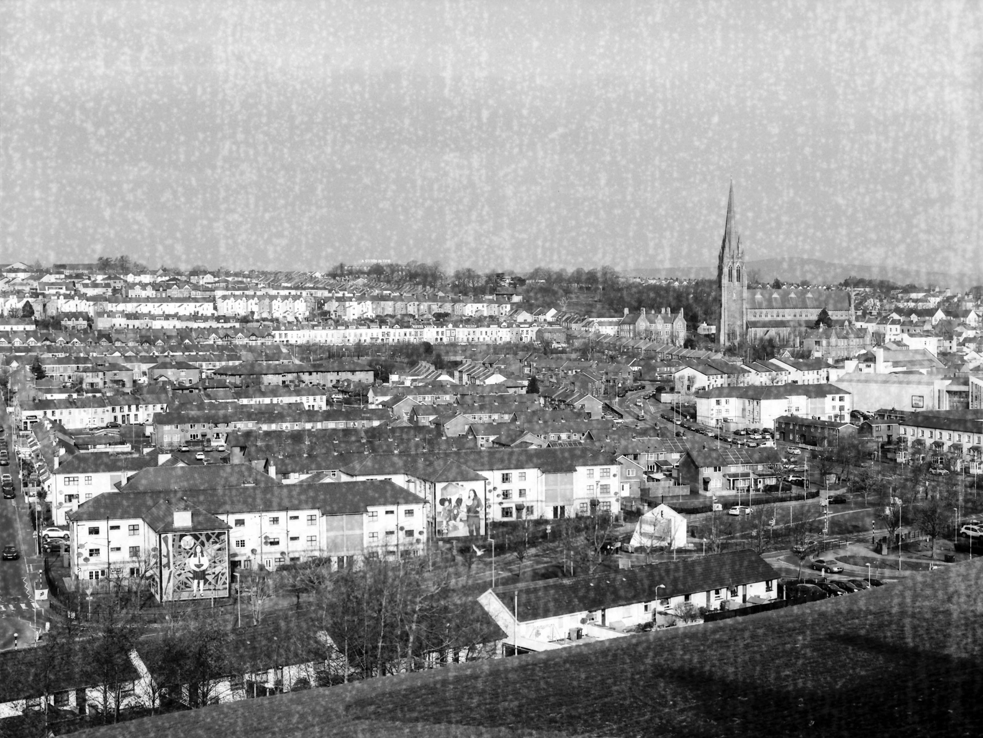

I have had mottling like that only once, it was a role of Delta 400 that I loaded into a Paterson tank then for whatever reason had to leave until the next day before processing. Learned my lesson from that and now only load right before development. One and only failure I have had from home processing and run through about 20 rolls of Ilford since all which have come out perfectly clean and defect free.
I have had two or three weird QC issues though with Ilford film recently, first was the tab towards the end of the role got caught in my Hasselblad A12 back and tore off. Amazingly I managed to unload the role and get it into a foil wrapper and box where it was wound tight enough it didn't unwrap. After that I had another couple of rolls from the same batch that did something similar, the tab got caught up in the film back making unloading fiddly. After that no more problems at all weirdly and all Ilford film either Delta 400 or HP5. Seems like the tab was stuck on at an angle and flaying outside of the width of the backing paper when wound.
I'm going to put myself in the "rapid change of conditions" camp. It looks exactly like an interaction of the film with the backing paper, whether you wish me to say so nor not. I've seen similar with film that has been rapidly brought up to temperature after being chilled or frozen and with outdated 120 film. I've never seen anything remotely like that mottling in any other circumstances. Like it or not, this has all the hallmarks of a mistake in handling the film at some point. We all make mistakes.
