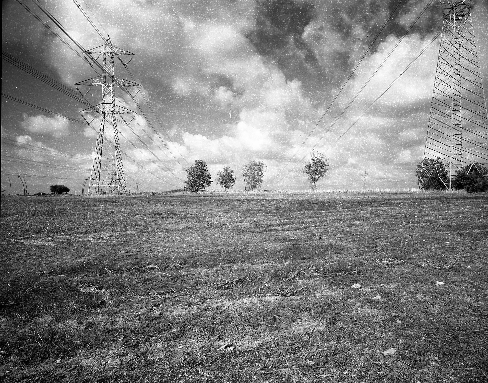

It's unlikely it's coating defect due to the quality controls Ilford use to check their coated materials which are amongst the best. Delta 100 has been my main film in 120 and 5x4 for over 10 years and I use a lot of it and have never seen an issue.
A "craquelure" texture sounds like a processing issue due to temperature variations, There's a scant regard to temperature whether it's film storage or processing (not aiming at you M Carter), but most issues with films are poor storage or rapid temperature changes from freezing to use, and it's the same in processing. When some of us started films were poorly hardened, FP3 and HP3 were quite poor by today's standard softer than Fomapan and ona par with the last EFKE films, Kodak Plus-X and Tri-X of that era were no better. Unfortunately Kodak keep the same names even when they upgraded so you can't tell Tri-X name which generation of film 1939 to today.
I've never seen a pattern like this on any film I've handled/developed since the 1980s, and I'm overly paranoid about processing tips - pre wash (if used), developer and stop are within 1° or so of developer temps, and I do a post-stop rinse that's maybe 3° more, the idea being to work the temps up to the slightly warmer tap water wash. (I know I'm being pretty anal about temps, but I think it just "feels" right to control it like that, sort of "because I can", and you never know which neg will be the one you print again and again - a Foma neg from that week has been a big seller for me). I ran Foma 200 and Rollei IR the same session with no issues, but I know there was a post somewhere on the internets regarding Delta 100 and the cracking pattern. (I store my 4x5 films in the wine fridge, cool but not as cold as the fridge or freezer, and they were in holders for a couple days before processing).
So, like I said, I'll do a really controlled tray fix-out for starters, and run some more sheets and see if it repeats. But if it's processing temp issues, it's odd that 1 batch of a specific film would be that sensitive to a well-controlled process that works fine with all other sheet films I have.

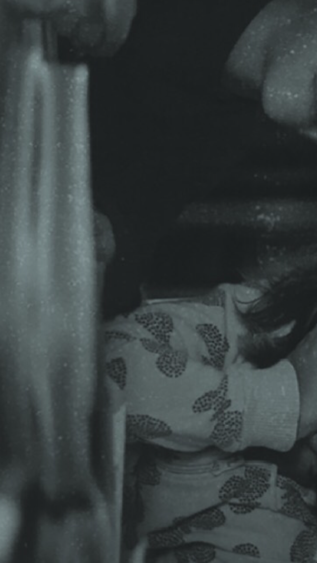

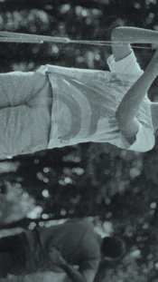

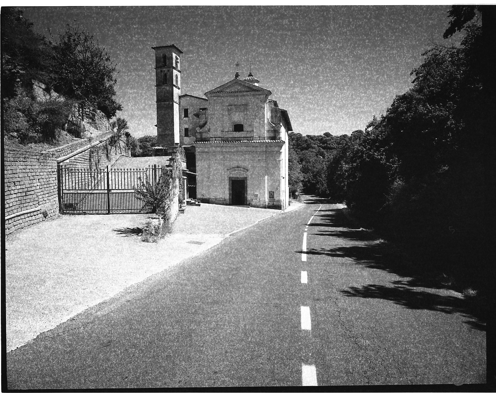

In the Ilford Partner forum, there is a thread about the SFX 200 film defects. However, it has become apparent that the defects are widespread, covering multiple films and speeds. If you have had an issue such as described or visually similar to what is posted below, please contribute.
We all love Ilford Film, they have been a backbone of black and white photography for countless years. We hope in all our might that they continue with quality products, Film, Paper, Chemicals, filters and everything traditionally related.
That being said, this is what people are finding:
First post (not me), the first image image in the thread. Ilford SFX 200
I have talked to a couple photo store reps, though they are not Ilford reps. They all thought this and that and the other, (as eluded to by other posters here) but after some discussion, it seems that they saw it from my point of view: manufacturing defiects. SFX 200, Delta 400 and PanF 50. Surely there are others as well.
I develop two rolls at a time, in stainless steel tanks, and use fresh diluted photo flow every 10 rolls. The "mottled" parts are not dirt, debris, etc., and they are there on the film before it goes into the photo flow. The mottled bits are in the film, the emultion.

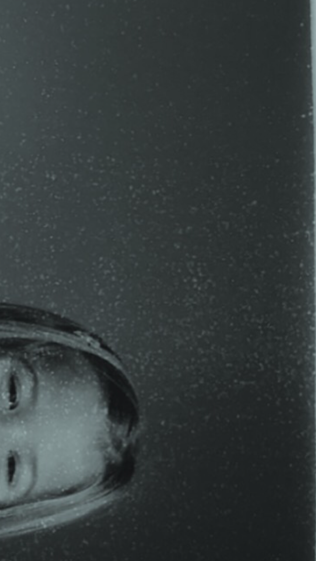

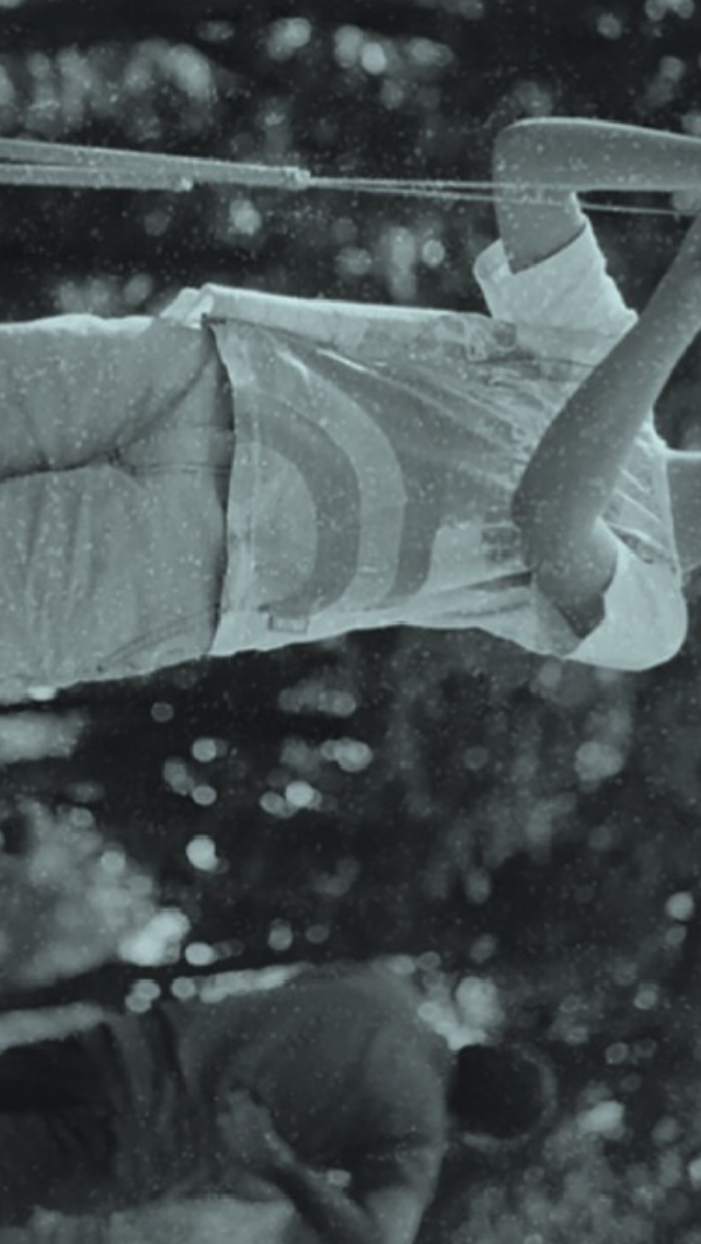

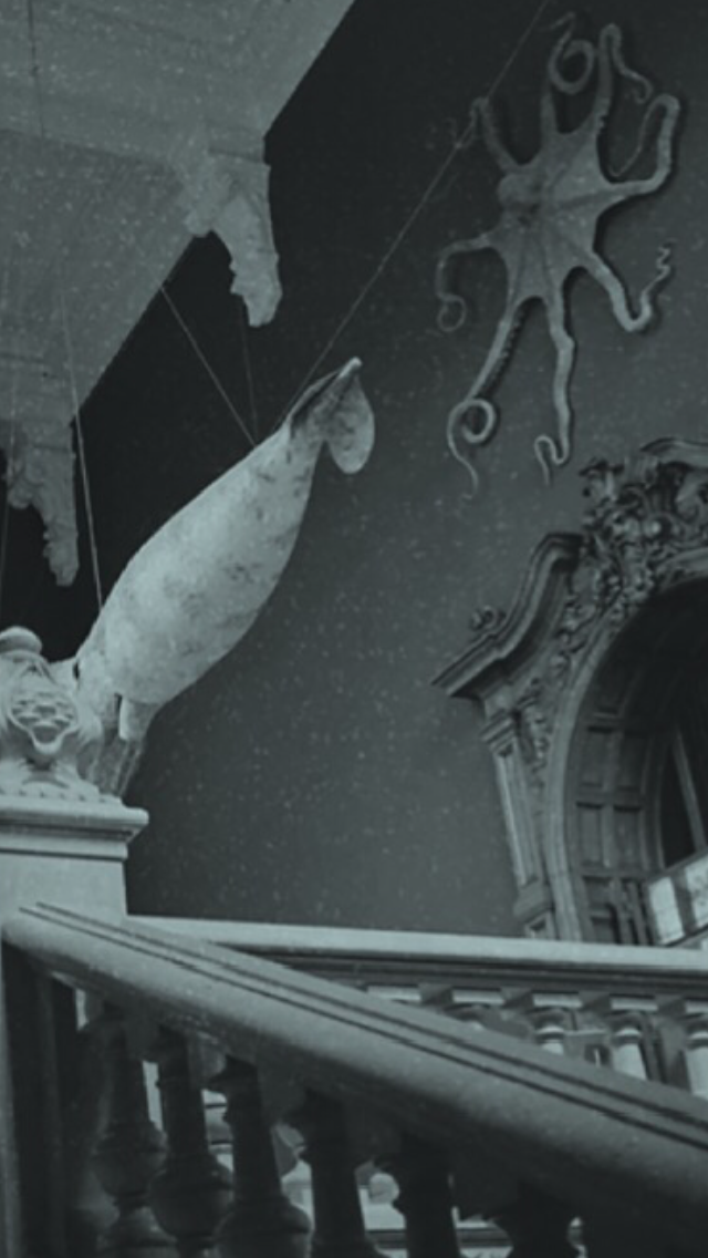

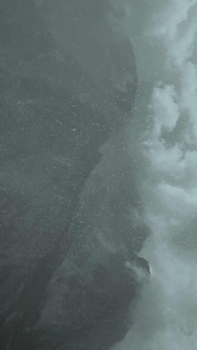

I will try to upload some of my photos scanned from RC workprints. The prints are not necessarily excellent prints, but they do show the flaws in the film and the horror of the retouching job necessary in order to have the prints made in the traditional sense. I am thinking somewhere from 30-40 hours of retouching per print.
I have been using Ilford Delta 400 for about 28 years exclusively in Pyro PMK, and just began using Ilford PanF after my stock of Agfa 25 ran out (need a slow speed film of course). This is 120 format film film. When a photographer tests out a film, for exposure index, development time, latitude and grain structure, once they come up with something good, they tend to stick with it. It becomes predictable, reliable, especially in the long exposures where reciprocity comes into effect and when using the Zone System or Tone System (as I use).
Photo 1 and 2 is Ilford Delta 400, same roll of film. The other roll developed at the same time was not affected.
Photo 3 is Ilford Pan F, printed a bit too contrasty, (awful print really) but shows the damage. the other roll I develop at the same time was not effected.

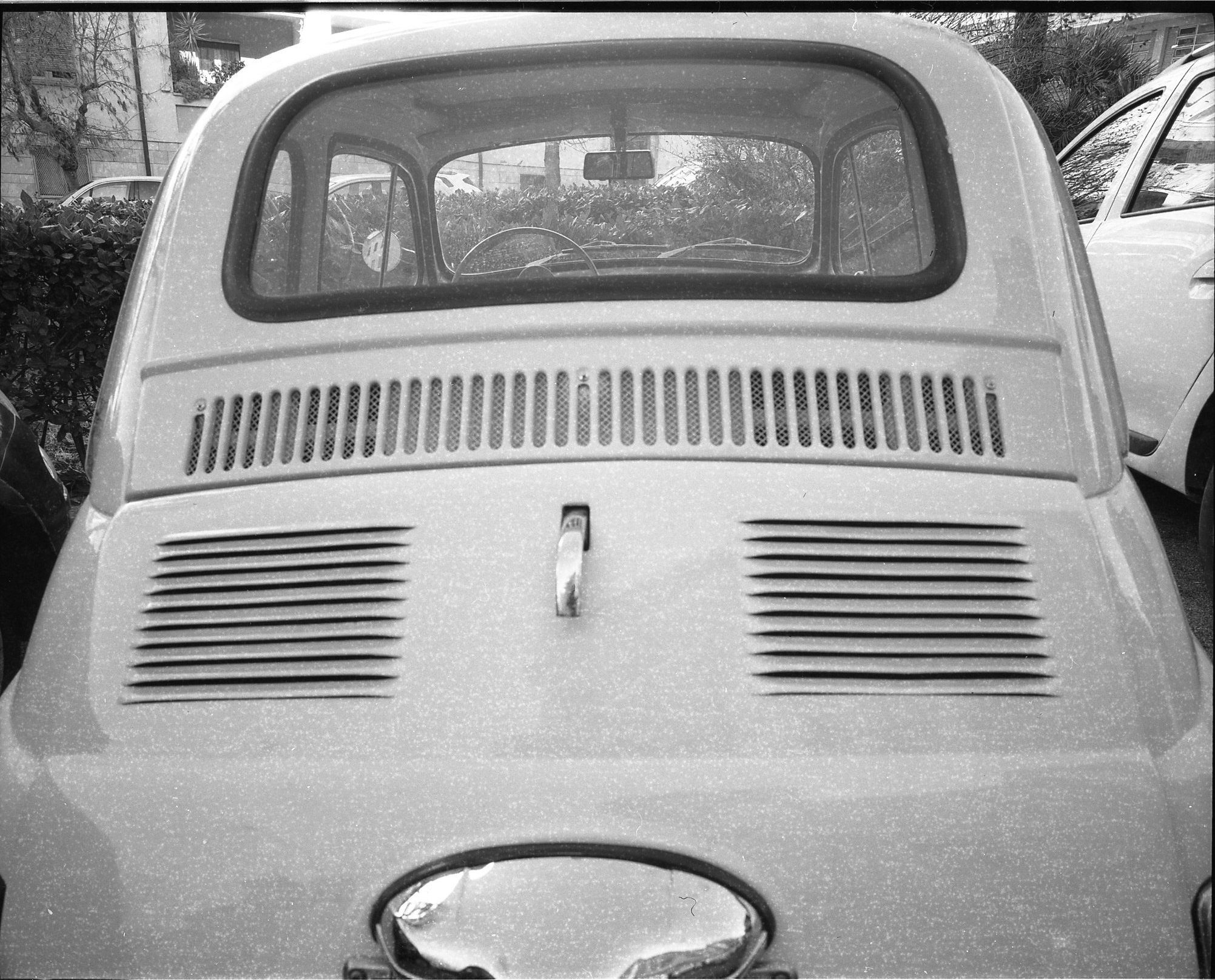

It looks like I am experiencing the same problem on the last 10 FP4 120 rolls (46AFN1C01/03 Oct 2020). For the first time yesterday I have used deminarilezed water for the whole process but the defects are still here. Please take a look of some images. Awaiting your comment, best regards. Ivo
I've been seeing this on Ilford film as well. Recently a roll of Delta 100 had pinholes which is very rare.
Looks like poor temperature control either during development or washing.
