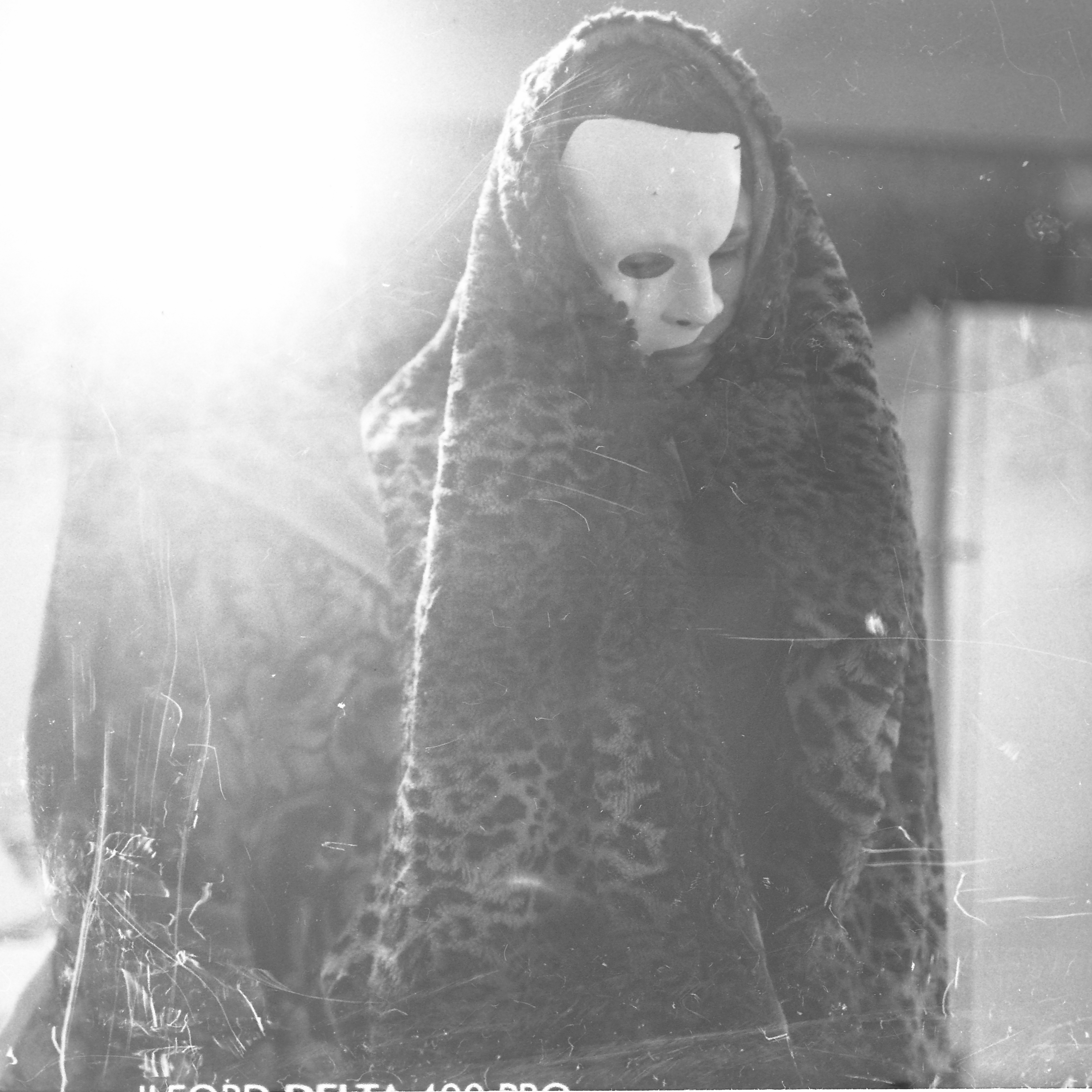

Having not done this before, aRolleiBrujo may not have known how it was supposed to be. The first time I used steel I thought the film was supposed to be pushed through the same way it is ratcheted with plastic reels.
A simple cell phone picture with the film next to the reel may help us identify the reel.

20140805_222718 by a.rodriguezpix, on Flickr

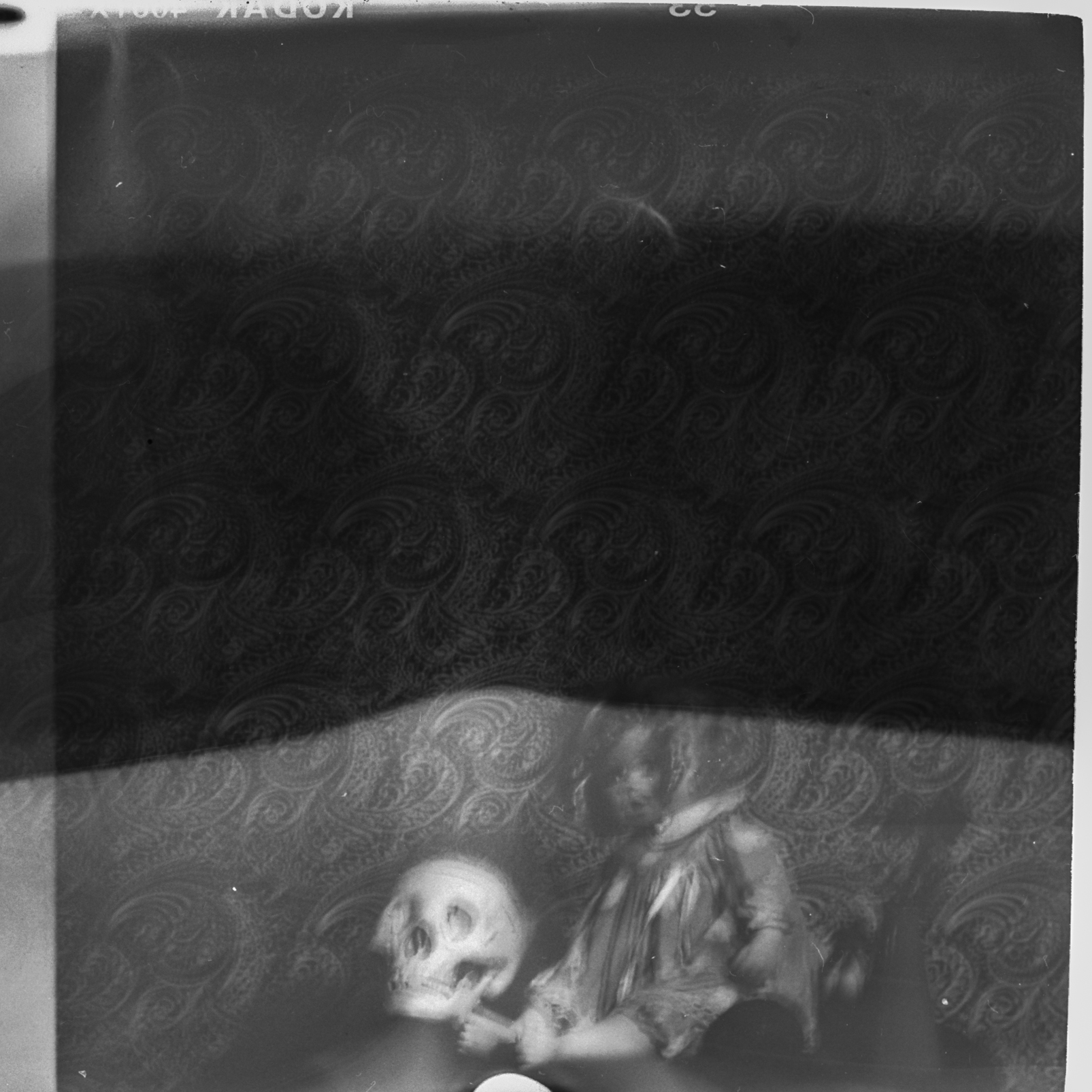

EUREKA! I have not one, but TWO saved TMAX 400 exposures! That from that which I thought ruined, during my first caffenol development and film shoot period! Oh, Thank the FILM God's!
