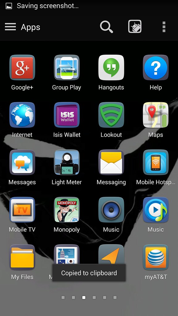

I forgot to add, that I relied solely on my Samsung Note 3 as a meter, with an app I purchased for $2.00! I give it, Light Meter, 6 thumbs up! by a.rodriguezpix, on Flickr
If you have 6 thumbs, you may need extra practice loading the reels:D
aRolleiBrujo
aRolleiBrujo
Apr 23, 2013
798
Modesto Ca
Lol, That is for certain! Sadly, I only have the two! I do have a Gossen Sixtar, that I just don't understand how to use! i don't get what read! the needle is constant that i know, however, how do i know which aperture to shoot at??:blink:
