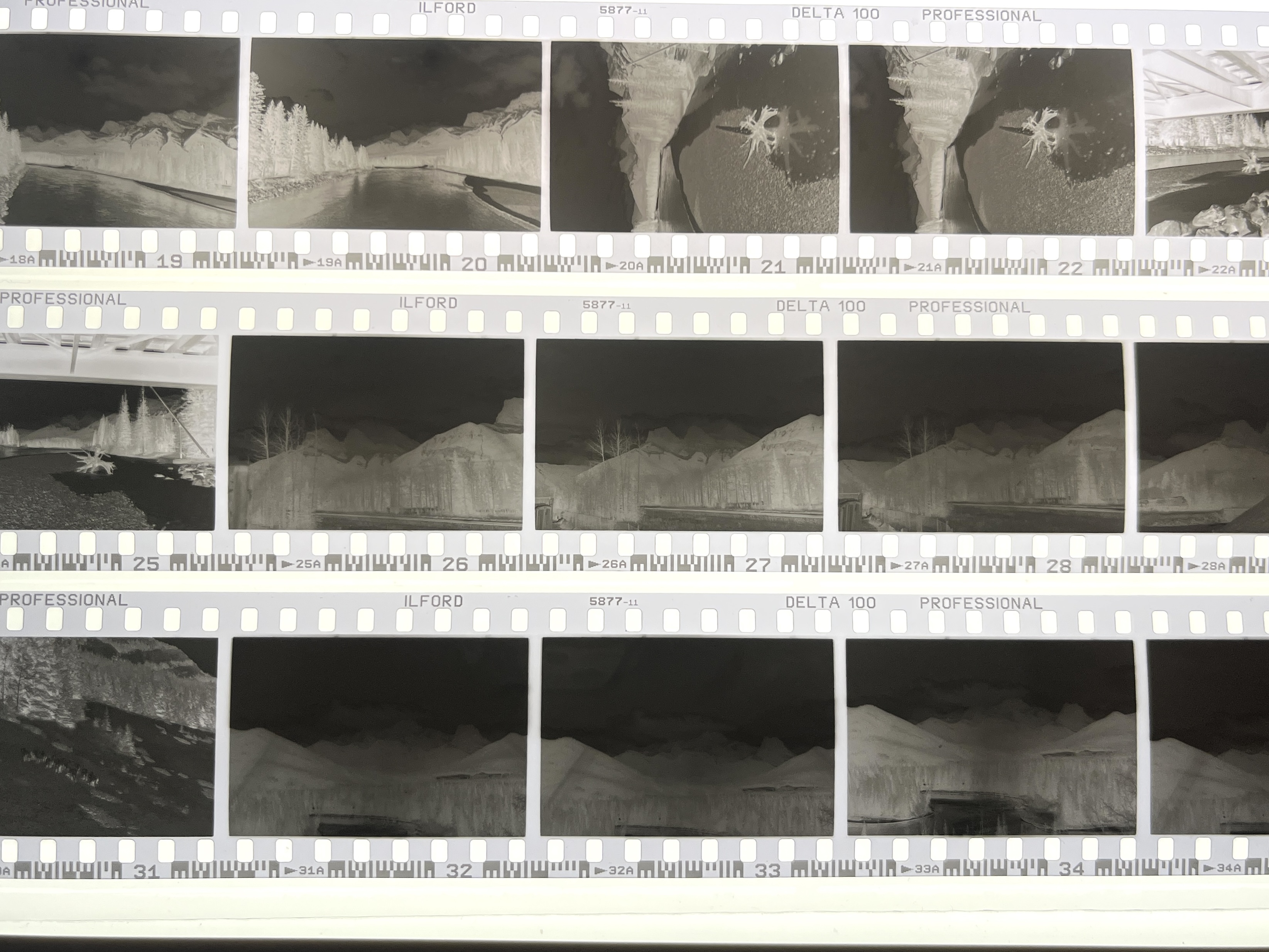

Well looking at the negatives on the light box...they certainly don't show much grain, and the detail is there in the complex highlights. I made a point to shoot a number of frames into the sun to see how cloud detail shows up. I am satisfied with the level of detail in the negatives. My sense is that Delta 100 will be an acceptable replacement for TMax100 for me. I'll comment more with images once i print a few.
Thanks to those Delta 100 users who commented with their experiences.
(All the images are from the last 24 hrs driving home from the city & around town... test shots to get a sense of Ilford Delta 100 in pyrocat for 35mm & 120.)
It remains to be seen if Delta will be my choice for portraits in MF where FP4+ is my go to by virtue of its tonality.

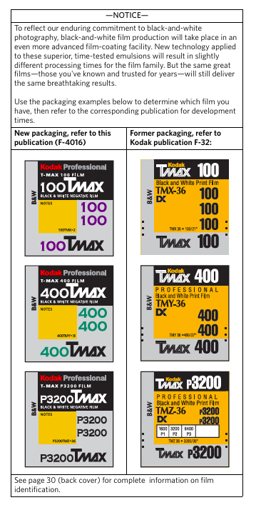

When speaking of the T-Max films, it helps to understand that over the years the 400 speed versions have changed their names and badging slightly during their evolution. Greg's post shows the current films, but this excerpt from the 2007 f4016 datasheet illustrates some older, slightly different versions.
The most important change probably happened in 2002, when the TMY designation was replaced with TMY-2.
All of those slight changes in name are only relevant if you are using old film.

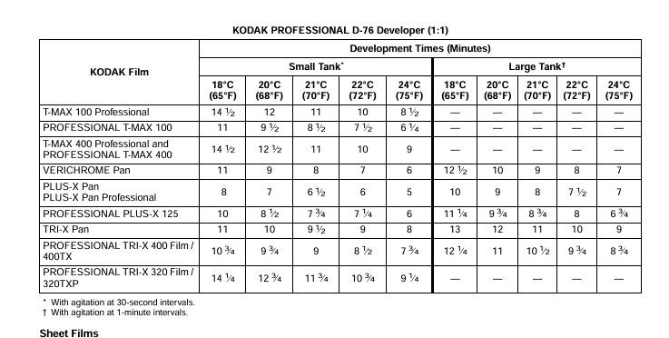

Note this excerpt from the 2002 version of the D-76 datasheet, which shows both versions of the 400 speed T-Max film name - old and new - and shows as well both versions of the 100 speed T-Max film name - old and new - with the quite large difference in recommended development time for those films.
Understood Greg. The image I shared happen to show 35mm box ends, but the slight name changes were mirrored in the 120 film packaging and branding.
Yes... the differences in developing time are significant....
