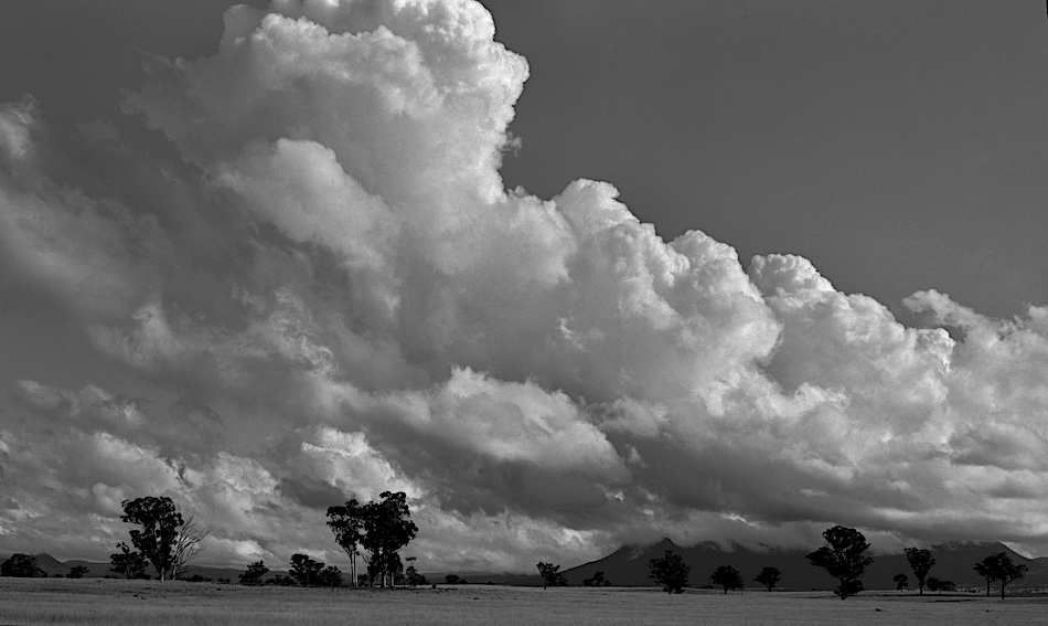

Unfortunately I'm not conversant with all the technical aspects of Delta 100, but this image was exposed on the medium and with very limited time to take the shot, all I could do with the light meter was to point it straight ahead level with the ground and using that one single reading, quickly set the camera then pressed the cable release. The 120 film was developed in ID II 1:1 for 8mins if I recall correctly. There was blown out highlights in the top cloud and the scanner found it difficult to deal with them, so I checked the negative and shadow detail was definitely in those highlights. Persistent scanning got them to show eventually, at the cost of dark trees, however, PS or Lightroom perhaps would fix this image up pretty good, but I don't have those editors on my computer. Please judge for yourself about tonality and dynamic range of this Delta 100 image. The exposing and processing was all pretty standard stuff, no pushing or pulling, what you see is what came from the camera. If It was possibly to do this shot again, I think I'd use Kodak Plus X Pan with the least amount of expiration, I have plenty. As usual, metering is important, I should have angled the meter up more towards the clouds, or known more about exposing for shadows and developing for the highlights, but just the same, detail was there in the negative. Would I use Delta 100 again? Yes, but for less contrasty scenes.

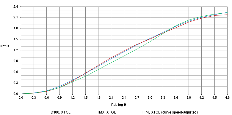

This might or might not be of use to anyone but with a series of general purpose developers I found the sensitometry to be virtually the same (see example below). Spectral sensitivity differences can alter the comparative results under some conditions. Some other differences - TMX is finer grained, TMX has a shinier emulsion surface.
GIMP is free. You could try that.
I'd hesitate to draw conclusions about the USA ility of this film for contrasty scenes based on this single image. Which, btw, looks fine to me; nice clouds!

@film4Me Many scanners have trouble dealing with density in positives and negatives. I'm able to extract a lot more highlight detail from negatives and shadow detail from slide film when using a DSLR copystand setup. It has to do with the brightness of the light source and the sensitivity of the sensor.
In what ways do you think the Plus-X image would differ?
One of the reasons for using TMax/Delta in 35mm is to get smoother results for landscape type photos. For portraits i don't mind a little grainier results as long as the tonality is good. For most of us Plus X is moot since it has long been discontinued, but i'm interest in your observations on tonality....
Thanks. However, I might try multi exposure scanning to see if I can improve that image. I did expose the whole roll of that Delta 100, so I've studied the other images as well, and I found that blown out highlights were a problem in other shots too.Spot metering and experimenting with processing I'd say are fairly critical to good viewable results from that film. But then, I'm still on my learning curve with it. I shoot mainly FP4, and as much Plus X Pan I can get my hands on. Even expired, Plus X Pan is a brilliant film for tonal range and handling highlights adequately IMO.
Sorry, but who uses 35mm for landscape photography? Wouldn't no less than 4x5 be better? I used 120 for the clouds shot and I'm moving to 4x5 in the future, like right now. 120 is alright, but for sharp detail in backgrounds, I reckon a larger format is needed. Of course it depends on your depth of field, but just the same, why have a murky out of focus background due to a format that is too small for the job? Good clean bokeh is just as important as a good sharp subject.
Yes Plus X Pan is discontinued so I'll refrain from mentioning it any further. I liked the rendering of the blacks and whites and all the tones in between, there's a magic about them, and perhaps it's the fogging of the expired film that suppresses bright highlights that warranted my attention, because blown out highlights have been a thorn in my side almost forever. I need to learn how to meter like the Pros. It's also fine grained if developed in fresh diluted developer, or even the second development of a one-shot developer. So, with Delta 100, I will be using semi stand or a much diluted developer process in the future, and experiment with times, to get slightly flatter images that the scanner can handle, and then post process to suit my taste.
