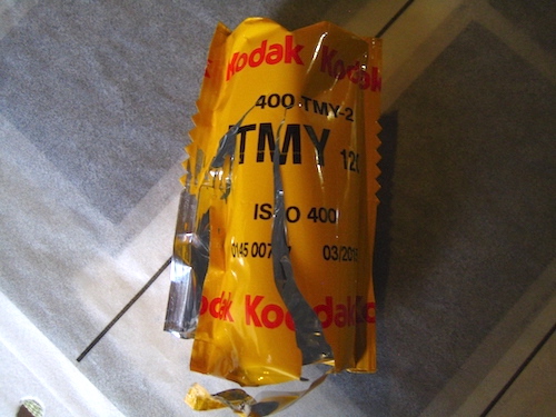

F, if it is ISO 400 the film would look like this (with/without wrapper)...... if there's an X and ISO 400 it's Tri-X......TMX then it's TMax 100
I checked the wrapper and it's "Y", TMY-2, with ISO 400 down below it, it's the same as the first one on the left in your row of pictures of the different TM films. This film, I imagine, is not relevant to your topic, is that right?
Nevertheless, it's in the Bronica now and I'll shoot it off to satisfy my own curiosity about it. I do though have two boxes of 100 TMAX I found at the bottom of the freezer, but it's 120 too. That might be relevant to your topic in terms of tonality ... Yes or No?

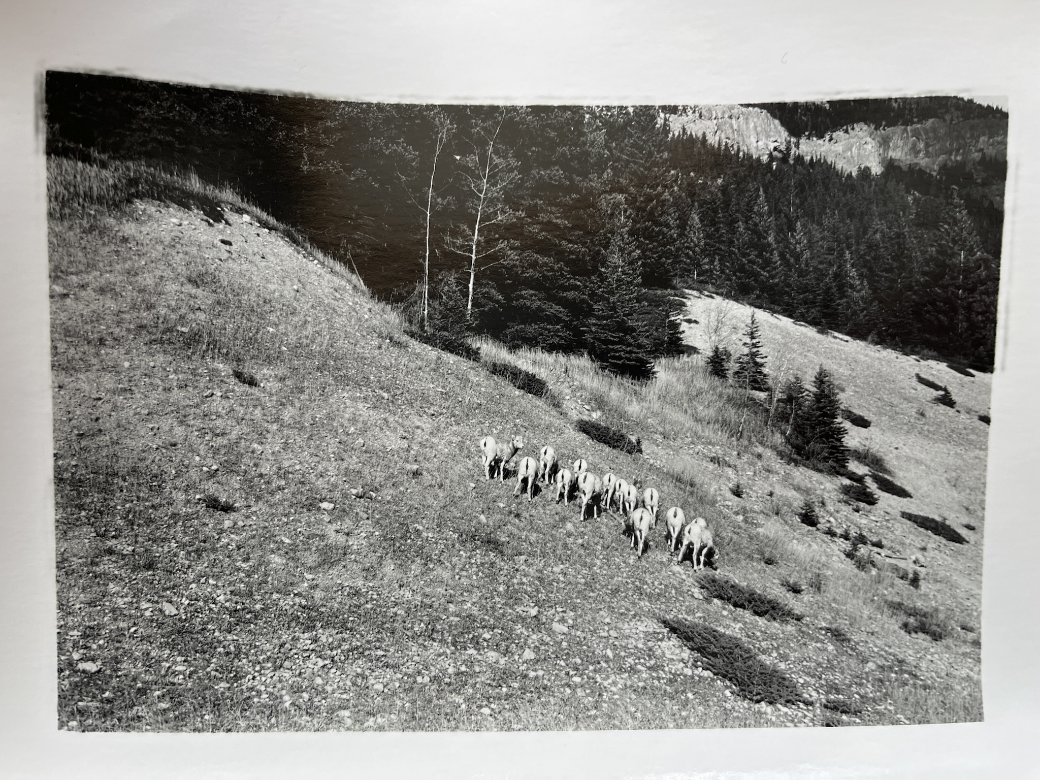

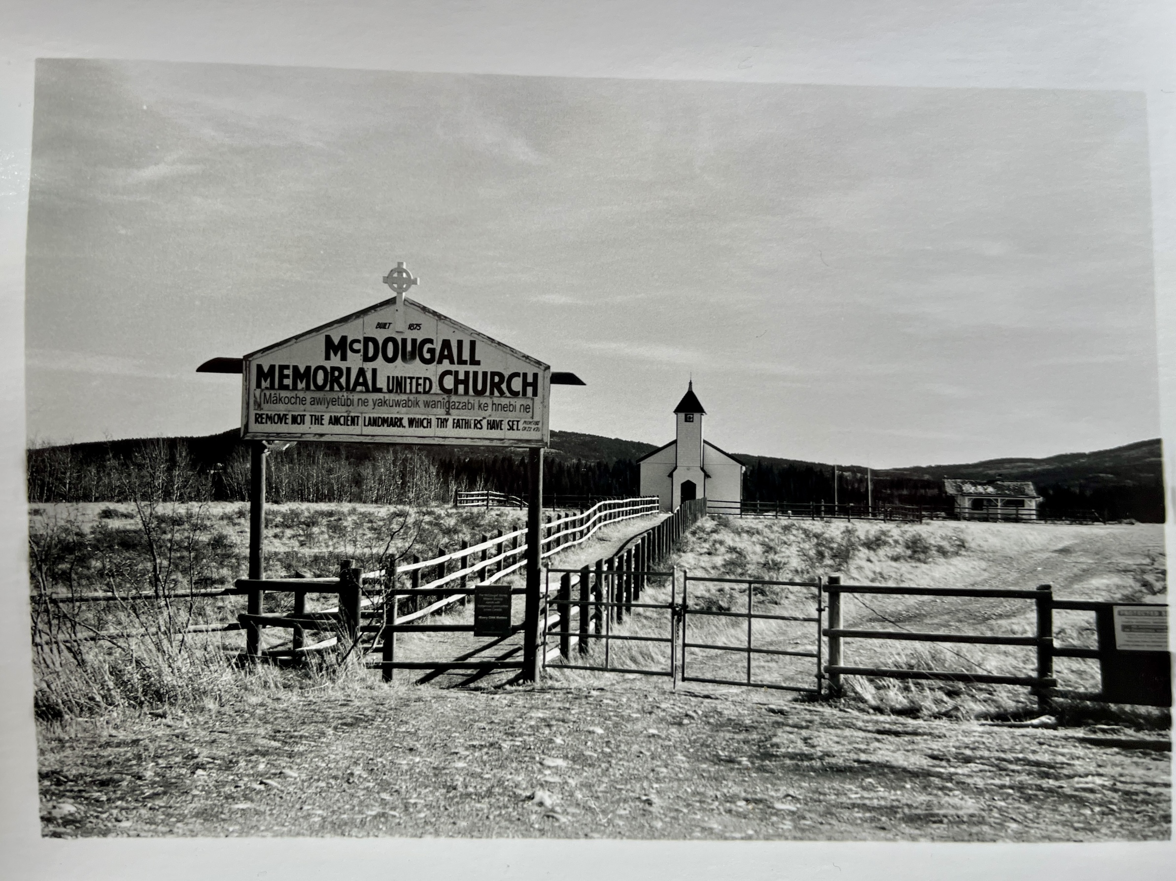

Straight unflattened test prints from Delta 100/35. Lots of detail, fairly contrasty (Zone VI enlarger head set for grade 2). Good tonal separation in similar
tones (sheep on grassy hillside). My initial feeling is that i wouldn't choose this film for portraits in MF....but would work for 6x9 format landscapes.
As i mentioned i'll reduce the development time to 9 min from 11 (Pyrocat 1:1:100) and reduce the agitation cycle to 4 inversions to start &4 inversions/minute instead of 30 sec of initial agitation and 4 inversions/30 sec.
What is the "Develop Before date on that wrapper - I can only see 03/20...?
2015, not that old, I'll be treating it pretty much as a fresh film. The other week I exposed and developed a 53yold Verichrome at box speed and it was fine, but I did boost the temp to 27c.

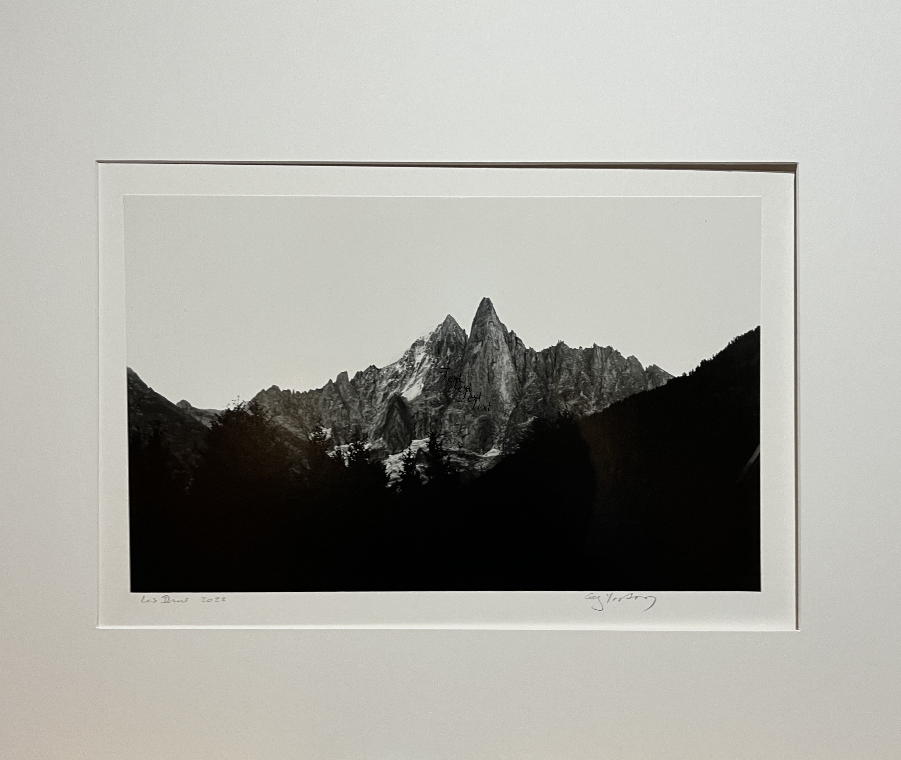

Yes, Pyrocat is my go-to. I've used it since it came out in 2015 and before that used PMK after seeing some results and reading the "Book of Pyro." One of the characteristics i like is the ability to separate subtle tones in the highlights. I've never had blown out highlights on pyrocat negatives. I don't use it for extra contrast as typically a lot of my subjects/lighting already have that going for them. At the same time Pyrocat doesn't supress mid tones.
The posted images in #135 aren't a good example by which to judge Pyrocat as the film was an unknown, the lighting was chosen for strong midday conditions (with lots of dynamic range rather than subjects with long tonal scale) and the prints were copied by iphone by w strong window light from the east (left). My sense was that uniformly lit subjects with smaller dynamic range are pretty easy to meter and expose for. As a starting point, I wanted to see how Delta 100 reacted to more complex lighting.
Here are a couple of examples of photos of exhibition print from pyrocat developer (iphone photos of 16x20" prints)...all Fuji 6x9 negatives with Tri-X

Yes, Pyrocat is my go-to. I've used it since it came out and before that used PMK after seeing some results and reading the "Book of Pyro." One of the characteristics i like is the ability to separate subtle tones in the highlights. I've never had blown out highlights on pyrocat negatives. I don't use it for extra contrast as typically a lot of my subjects/lighting already have that going for them. At the same time Pyrocat doesn't supress mid tones.
Here are a couple of examples of photos of exhibition print from pyrocat developer (iphone photos of 16x20" prints)...all Fuji 6x9 negatives with Tri-XView attachment 393314View attachment 393315View attachment 393316
Stunning photos and location. Do you live close by? I'm jealous!

You might run into the wrapper offset problems described in this thread: https://www.photrio.com/forum/threa...ing-paper-problems-emulsions-affected.137251/
I'm not sure Kodak Alaris's reason for the "13" imprint caused by sitting in a hot truck over the weekend is valid, I think it's one of those standard type brainwashing cliche answers that you get from any company deluged with complaints about their faulty products. I've actually had that imprint problem myself, and I'm not sure even if it was a Kodak film, the backing paper printing was affecting the film and if you looked closely you could read the print on the developed film. Anyway, if my TMY is faulty, I'll soon let you know.
Thank you. Yes, I live in Western Canada and worked as a professional mountain guide.... the photos #1 & #3 from the Bugaboos about 5 hrs west (250 km ...and some slow logging roads) of my home and #2 from the Cariboo mountains some 6 hrs north (500 km). Here's one from your side of the big water...
That's TEN years past its expiration date. Kodak films from that era are notorious for "wrapper offset" contamination. I'll be surprised if you don't encounter that problem.

Per the transient Kodak 120 backing paper problem. I never encountered it at all with any of their roll films, black and white or color, despite having used quite a quantity over those questionable years - that is, until just a few months ago when I thawed out an old 5pk of 120 TMY400 and sacrificed a roll on a goof-off project just in case of what-if? Sure enough, bad mottling upon development. But that was the only suspect box I had; all my other roll film on hand was produced after the problem era, and is relatively fresh.
