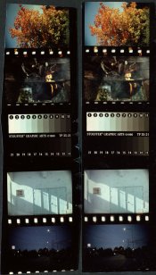

I started experimenting with developers, trying to get rid of that red-cyan crossover, but it seems it can be quite a difficult task, at least for me :rolleyes:. By adding more bromide, I've been able to decrease the red-cyan crossover but it changes to magenta-green crossover.
I've found that thiocyanate (KSCN or NaSCN) can give quite a nice masking effect that lowers contrast and gives a boost in shadows.
