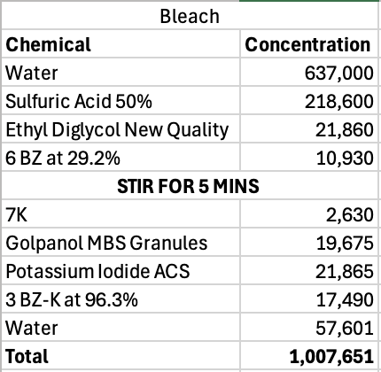

Based on the excel spreadsheet that was sent, I have simplified and translated it which can be seen in the attached images. Please do correct me if I am wrong! My questions are as follows:
1. I am assuming that the order in which they were listed in the spreadsheet is the order we mix in yes?
2. I have been repeatedly told that Ciba developer is basically just normal black and white developer, are you guys going to mix your own as per the recipe or stick to what's still available now?
3. I think 4 BZ is 4,4 Benzidine, thoughts?
4. I think 3 BZ-K is benzalkonium chloride, what are your thoughts?
5. The fixer seems relatively straightforward, however, when it states 'ammonium thiosulfate solution,' do you think it is referring to their non hardening fixer as a mixed solution? Same with the ammonium bisulfate solution at 70%?

For zhe developer and fix, I came to the same conclusion. Do you know what 7K in the bleach formula could be?
Pegajoy
May 31, 2024
18
Germany
Hi Guys, because I am not a chemist and not all of the parts are clear for me.
Expected, 6 BZ is Benzoyl (Bz, C6H5CO-) ? But is it Benzoyl Chloride, CAS 98-88-4 or Benzoyl Peroxide, 94-36-0 or Benzoyl Cyanide, CAS 613-90-1
And I expect, NTA is Nitrilotriacetic acid, CAS 139-13-9?
