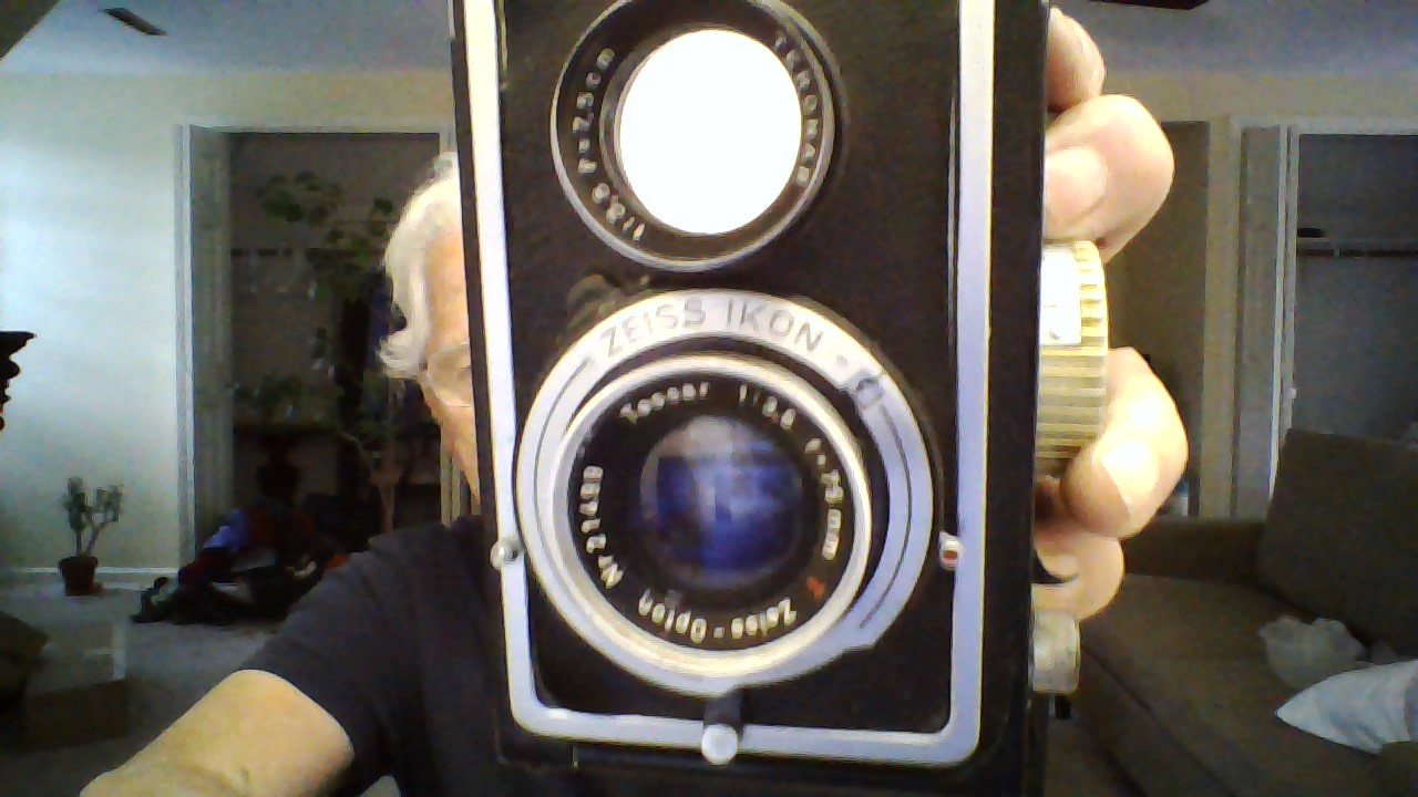

I have the same lens on a Rolleiflex Automat MXV and it's excellent. My gut feeling with such a low early serial number is it's an Ikoflex 1 850/16 Lps with a Prontor-S shutter. The Compur factory was badly damaged during the war and it was sometime before volume production resumed.

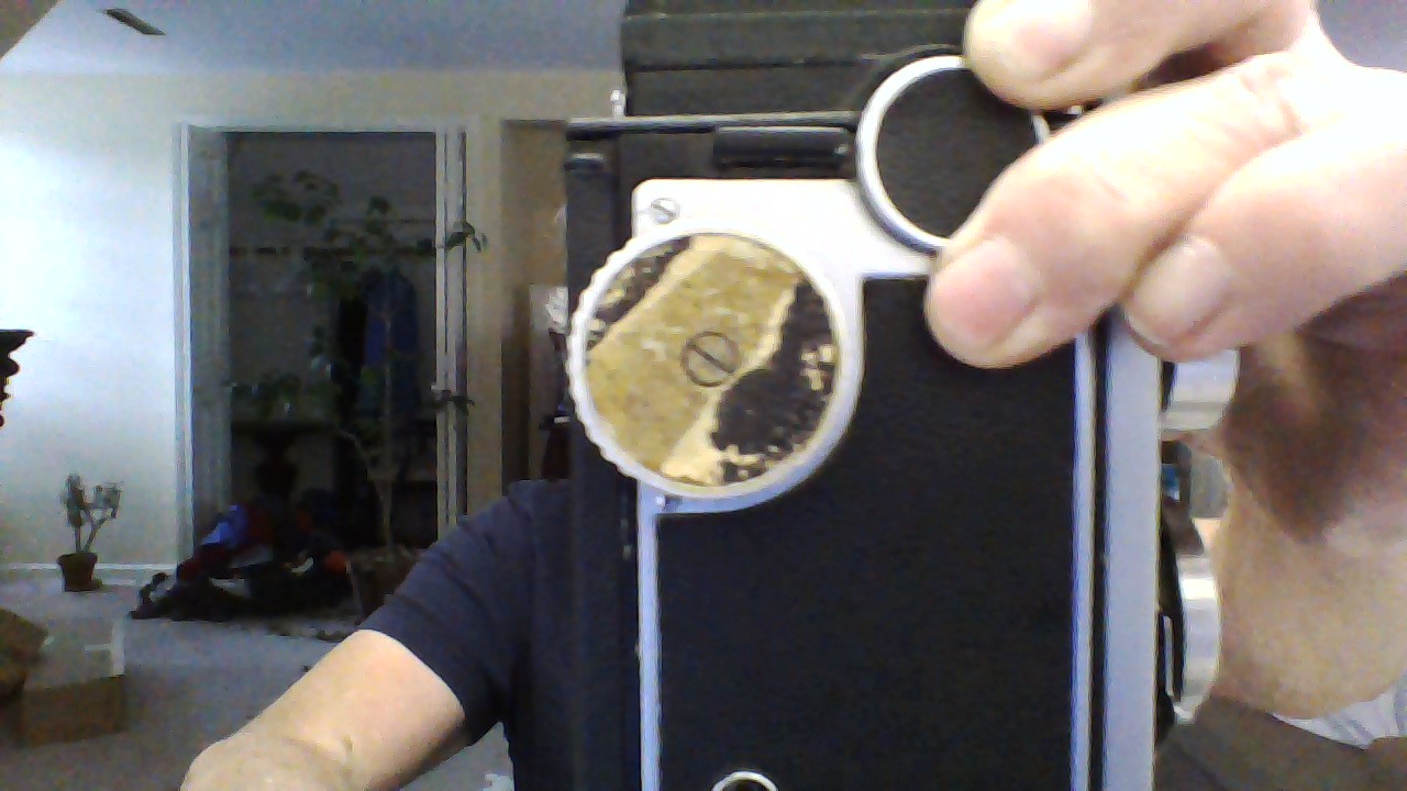

It doesn't have a mechanical counter, so you use the red window when you advance the film. This was one of the things that made the camera cheaper than the more advanced models.

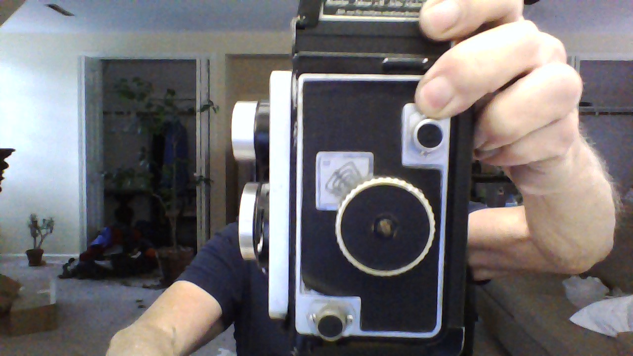

choiliefan
Dec 27, 2013
1,362
Do you have any pictures of your camera you can post here?
Might be useful for future reference.

JPD, I thank you once again. When I downloaded the manual I got only to page 15 and could not get further pages.There is no doubt a way to get more pages but at age 79 I am not super computer savvy.Here are photos that choiliefan requested
