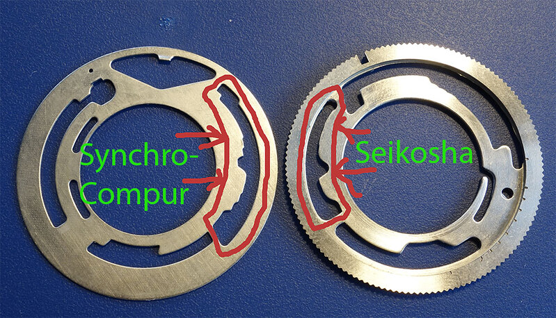

Great. Here are a couple of samples of this type of ring with steps. In both of them, you'll note a notch in the middle of the steps- the lower arrow on the Seikosha side is pointing to it, between the two arrows on the Compur. This the 1/25 or 1/30 point that JPD is referring to, where the slow speed escapement is disengaged. In both of these rings, the slow speeds are to the bottom (they rotate in opposite directions to change speeds). Looking at the Synchro-Compur lower section, you can see how small of a distance is involved in changing the speed from 1/8 to 1/15 (the lower arrow is pointing to this area, which has the slightest rise in the middle).
It is possible to fine-tune speeds by either filing down or expanding (swaging) steps as needed. You'll often see these marks on older shutters like the Compur Rapids and such. Or, as I mentioned before, you find the position of the dial that gives the right speed and make a mark.
