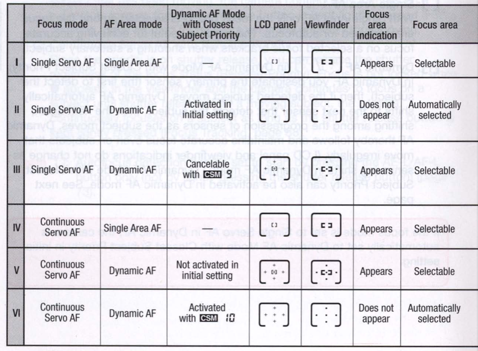

N80/F100 focus modes. I have had an F100 since 2010 and only ever used (I). I did, however, with the N80, try to learn these in practical situations. Though still pretty confusing.

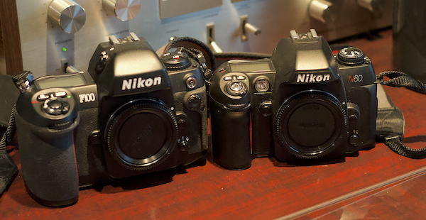

The more I use the N80 the more it feels like a compact F100 than a brother or sister to the N75.
The only focus mode I ever use on any of my AF cameras is single spot, single servo!
with the bonus of the built in flash. Aaaand low light focus assist illuminator. I have that on off in the custom mode, but I have that custom mode set to the first one to appear when I switch to custom, so I can turn it on super quick if I ever need it.
I pretty much use the AF single servo and pick a spot. The dynamic stuff is cool for some places and some things, I'm sure. But for MY style of photography, just putting the spot on target, touch, and if I need to recompose hold the AF/AE lock, then go.
I have all the modes on the F6, I almost never use continuous for anything, and all the rest of the modes... basically just more spots to choose from so I might not have to recompose after setting focus.
N80 works fine just single servo single area.

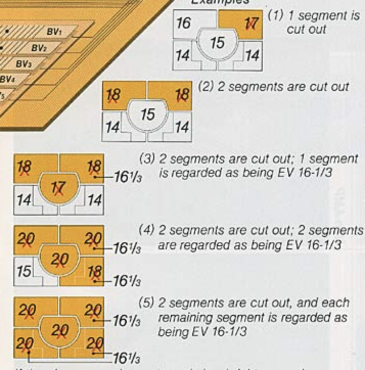

Nikon Matrix is supposed to NOT favor the highlights. For example in their literature this example shows hypothetical EV values sensed by the various zones. In all these cases, the exposure calculated is MORE than what one would get with an averaging meter camera. It eliminates the very high brightness zones from the exposure calculation.
Even if ALL the zones are high (example 5), it still gives more exposure; about two stops more...that is how it gets by being a "Box Speed" camera in my hands.
I'm interested if others find this works as described.

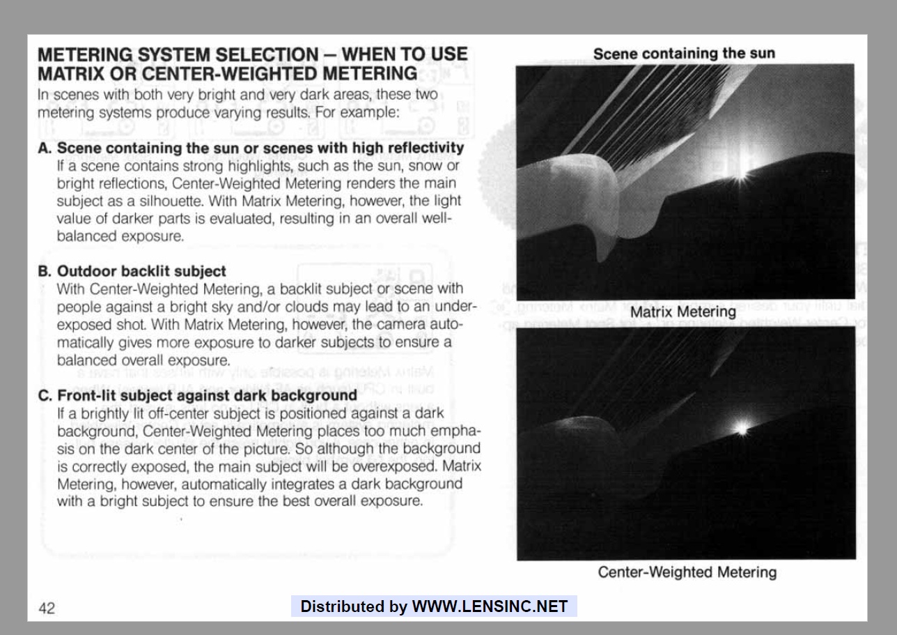

For what it's worth, here's an explanation from my N6006 manual.
So using this camera on matrix exposure mode is risky if you're shooting chrome film? It could easily raise the exposure and burn out the highlights.
Matrix, does seem to be based on rules for negative exposure but I have not seen that written in the Nikon literature.
I think the inclusion of the spot metering on the Nikon cameras was not for B&W Zone System users, but for 'chrome users to spot the highlights. That is a reliable method of chrome exposure. That and bracketing, both done well by Nikon.

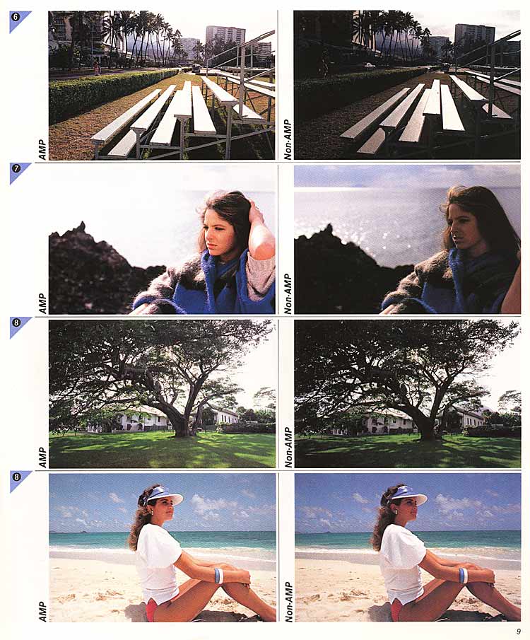

And I'm not so up to speed on the '3D' Matrix. Those screen shots I posted above were older, but I did find a simplified diagram below for the 1,005- pixel RGB sensor on the F5 and F6.
I suspect, one could compare '3D Matrix' to the non-3D by fitting a Non-G or Non-D lens (which shifts it back to normal Matrix mode).
