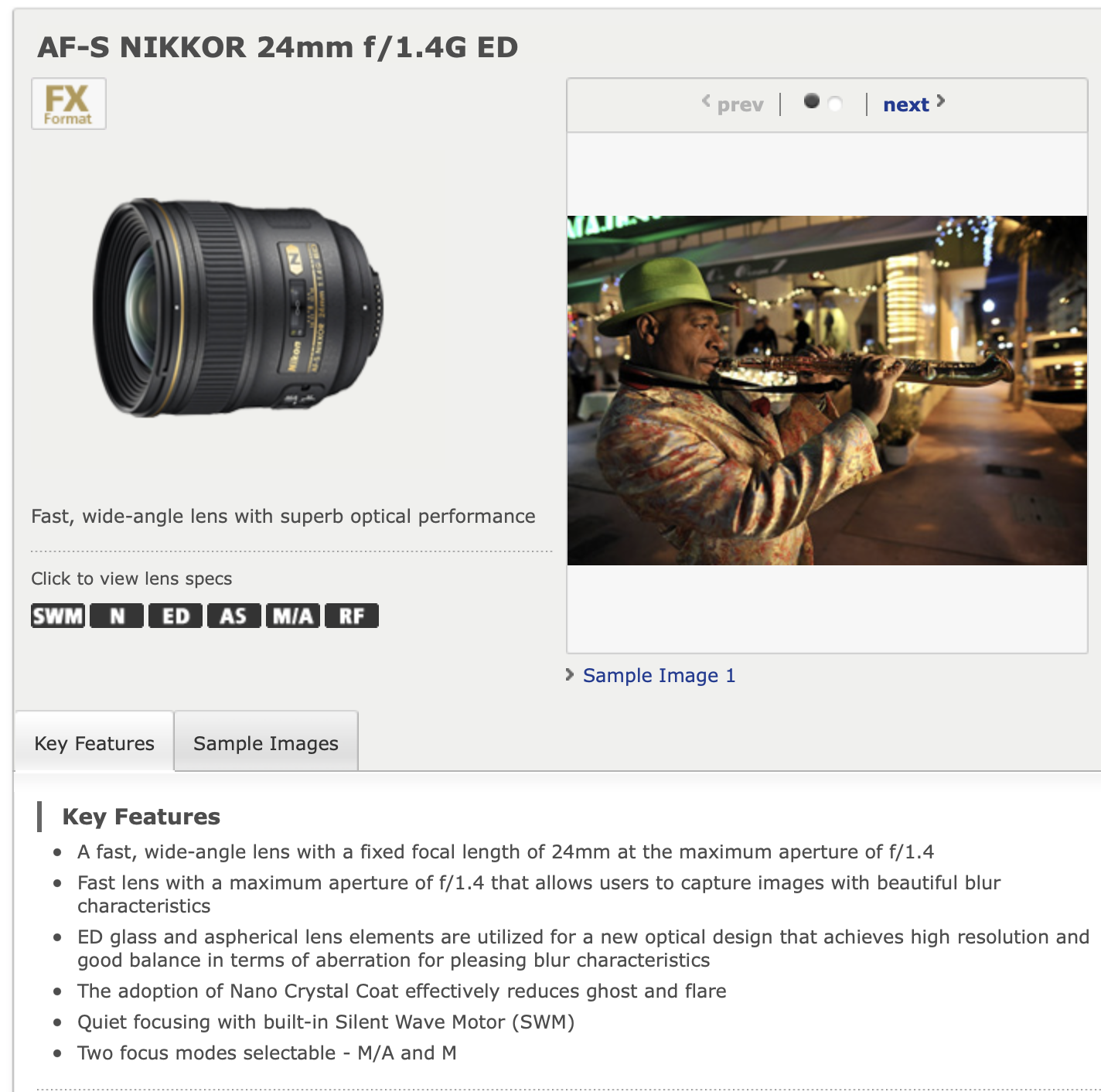

Isn't that an ED lens, so you can only shoot it wide open on F80 (or any other film SLR)? How does that make it a great combination?
It’s either wide open only, or min aperture only. I think it depends on which electronic diaphragm lens.
ED the Glass, that’s a “G” lens, it will work fine. It’s the “E” lens that can only shoot wide open.
Roger
Yes, a G lens, that is correct. The eight "E" lenses were all manual focus, and pre- chip, so not going to work on all the AF cameras.
This lens works great on all the latest Nikon AF cameras except the N55, on which it is 'focus confirmation' only, but everything else works on N55.
ED: Extra-Low Dispersion Glass
N: Nano Crystal Coat
SWM: Silent Wave Motor
AS: Aspherical Elements
M/A: Grab and go manual focus
RF: Rear Group Focus
You're thinking of Series E from circa 1980, there are now E lenses ( as a successor to G) that have an electronic aperture instead of mechanical. I think these are compatible with newer digital SLR's only.
Correct. NO film cameras are compatible with the new E (electronic diaphragm) lenses. E lenses came out after 2006, so only cameras designed after that era will work.
I was bummed when I found that out. I had the 200-500 before I bought an F6 and it's a fun lens, but I can only shoot if at f/5.6 on film cameras. I bought it for birding on my digitals, where it excels, but it would be fun to be able to shoot film with it.
