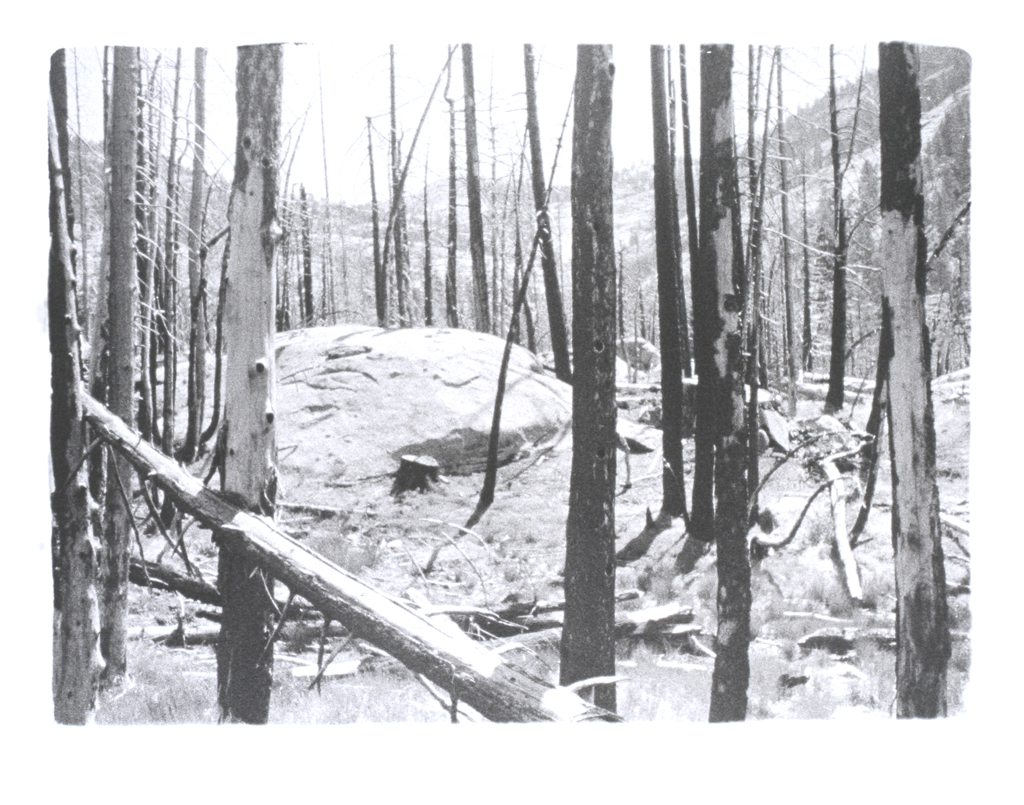

Move in closer with the Minox?:smile: I stole this image from another website... shot on 8x10 film. I suppose if I had to move in closer with the Minox then I'd shoot the part of the image in the red rectangle and print it to 2x3". Oh, but man, that would be a very l-o-o-o-n-g walk to crop with my feet.:D

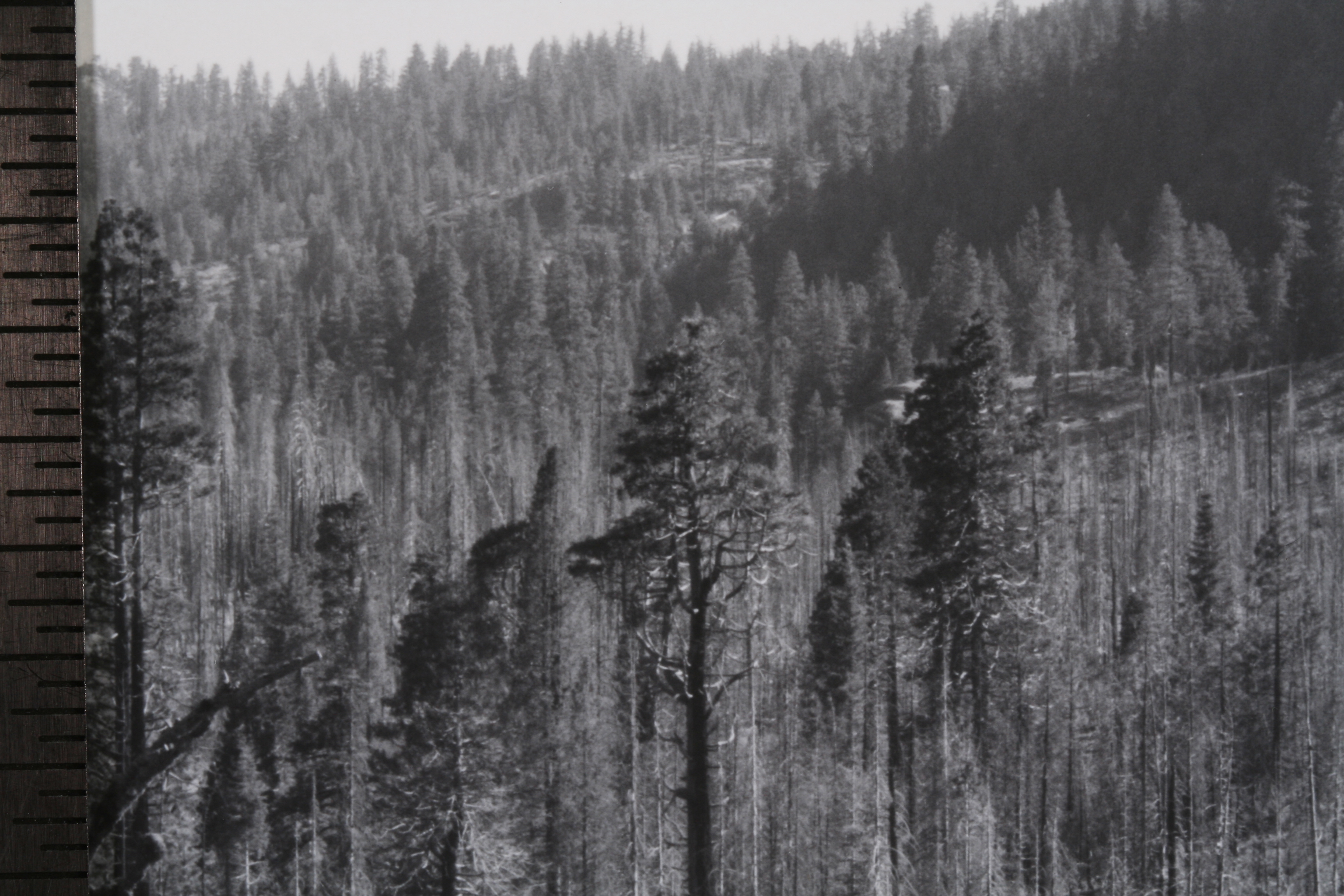

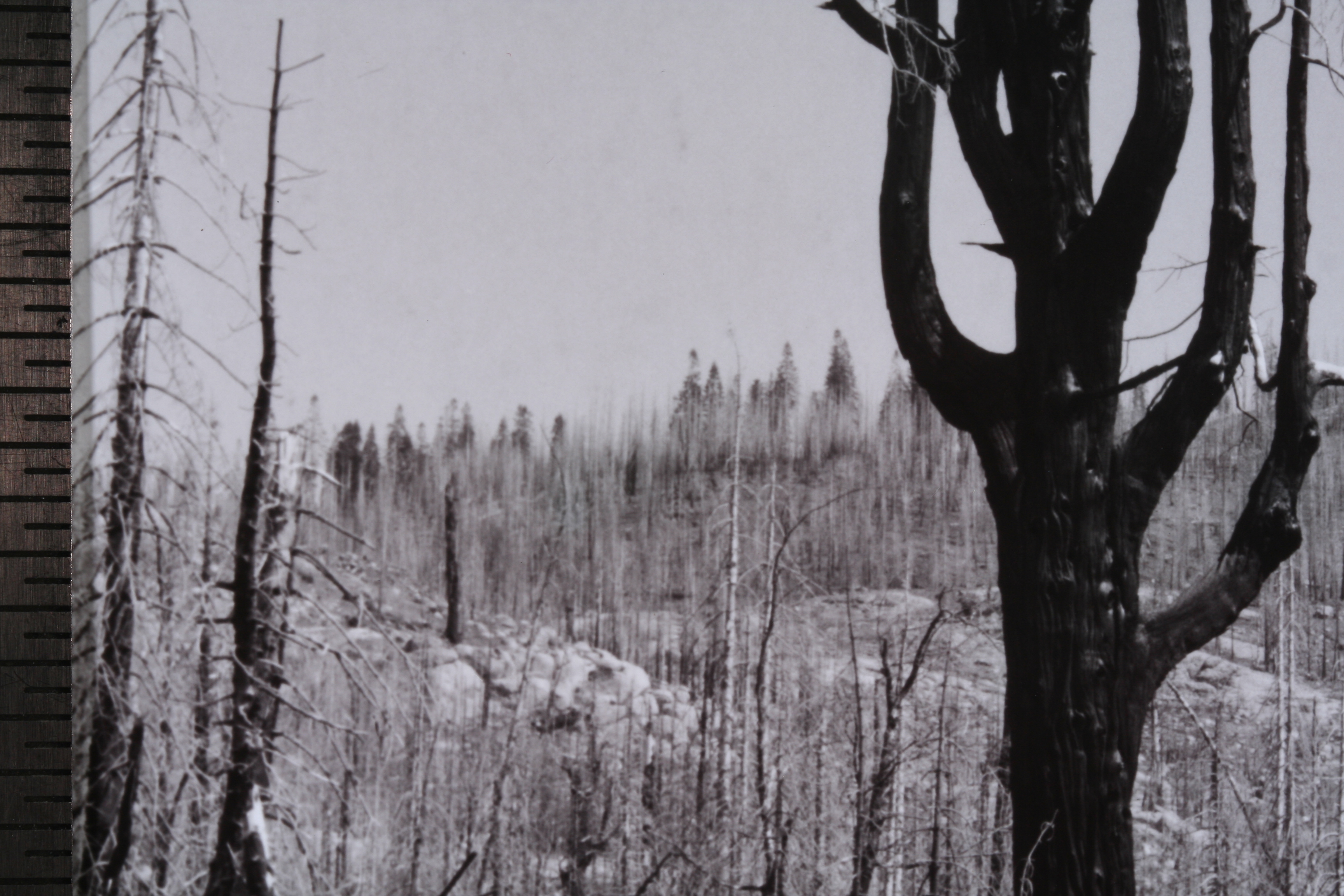

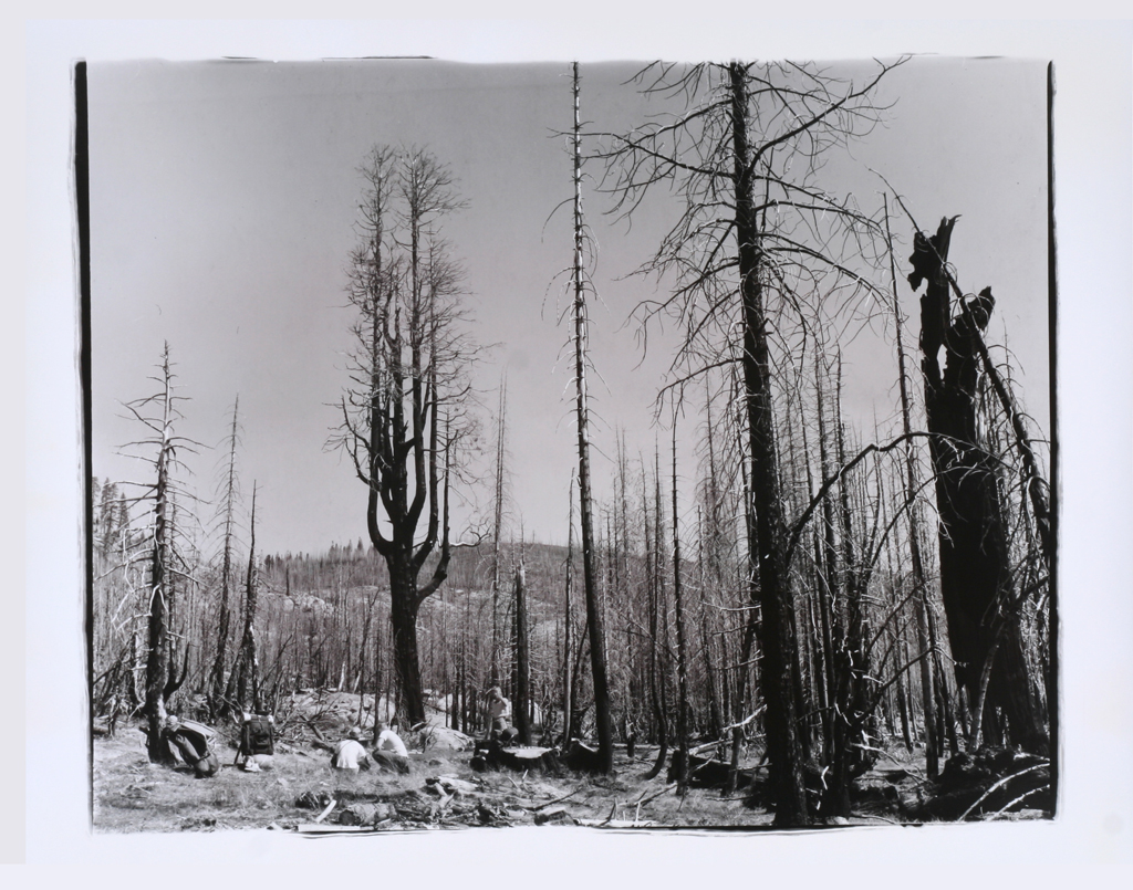

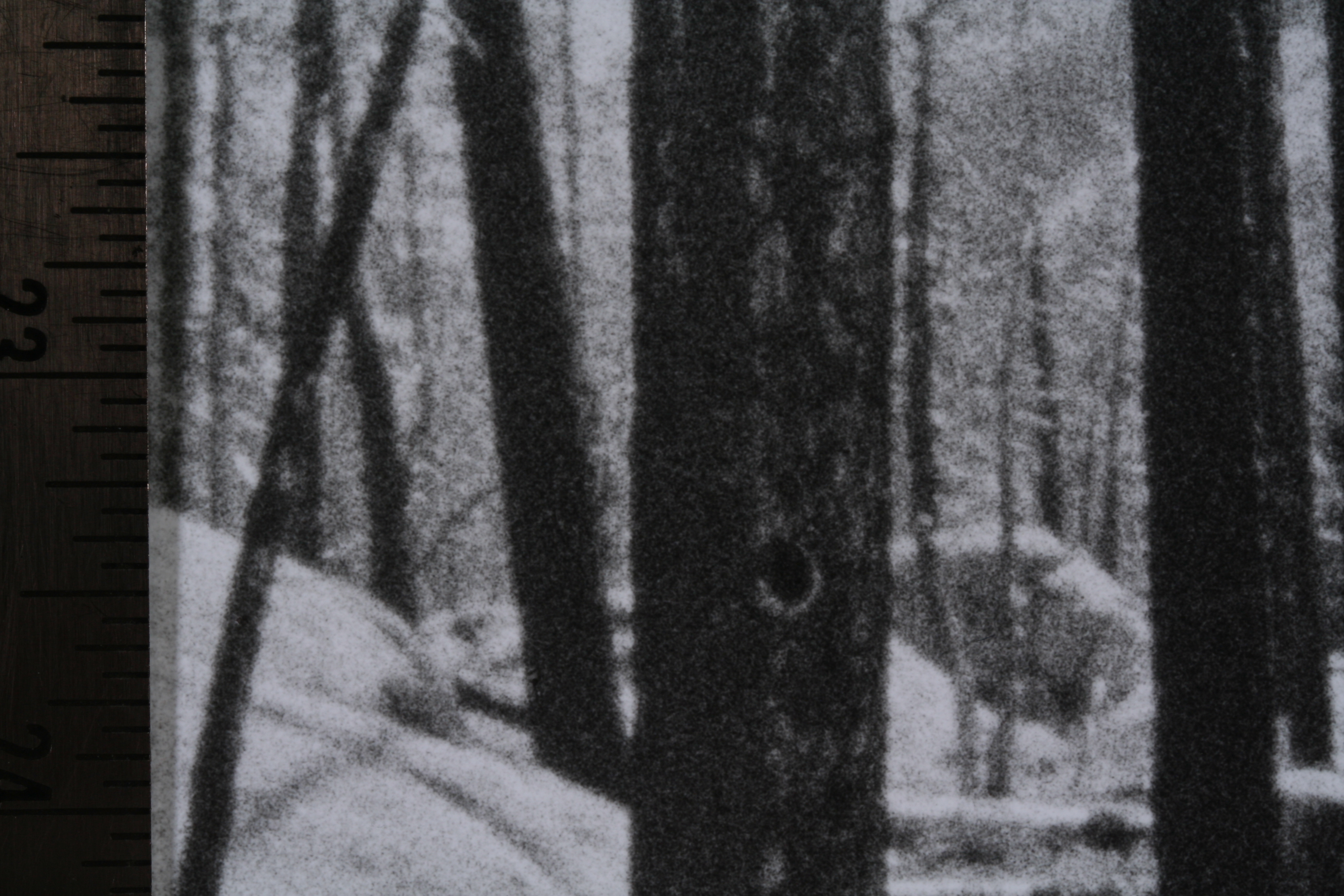

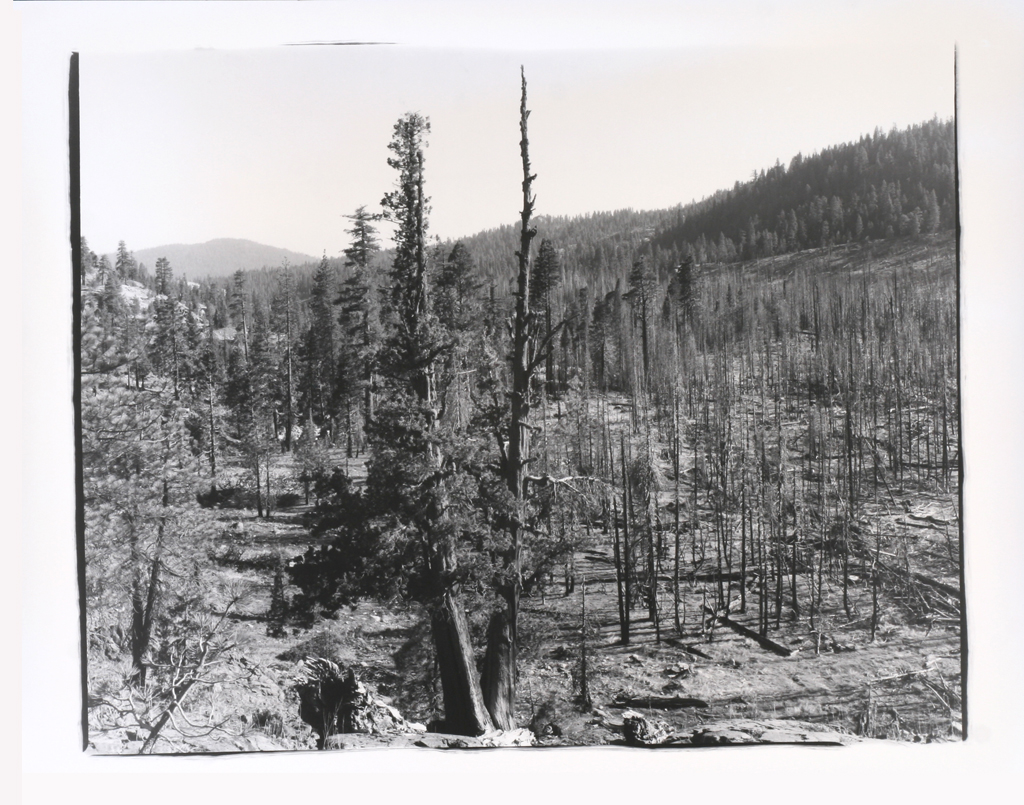

The following three prints came from one trip to Dinkey Creek after a fire in 1981 wiped out the forest. On the trip I shot 4x5 and Minox. The 4x5 shots are clear and sharp with such detail that your eye can drink in. You can literally count every tree in the forest.
It wasn't until after I started looking at the prints that I realized there was detail I could see in the Minox shot that isn't in the 4x5 shots. Simply because it was taken from a position closer to foreground subject matter. You can see every knot in the tree to the left of the boulder.
High Resolution Close-Up of 4x5
High Resolution Close-Up of Minox

It wasn't until after I started looking at the prints that I realized there was detail I could see in the Minox shot that isn't in the 4x5 shots. Simply because it was taken from a position closer to foreground subject matter. You can see every knot in the tree to the left of the boulder./QUOTE]
Cheater!
Cheater!
But wait! There's more. I have a 4x5 shot exact same composition as one on Pocket Instamatic, where the Pocket Instamatic shot is better.
And if that isn't enough. Try to solve my riddle how I got hundreds, maybe thousands of negatives represented on one Minox negative.
