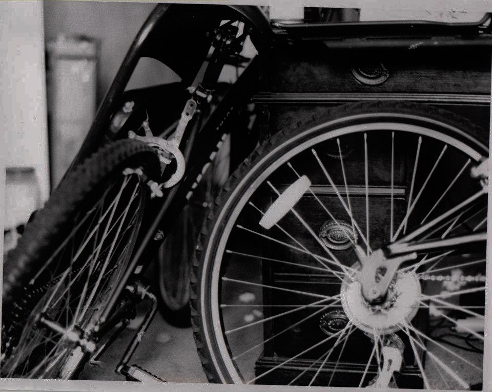

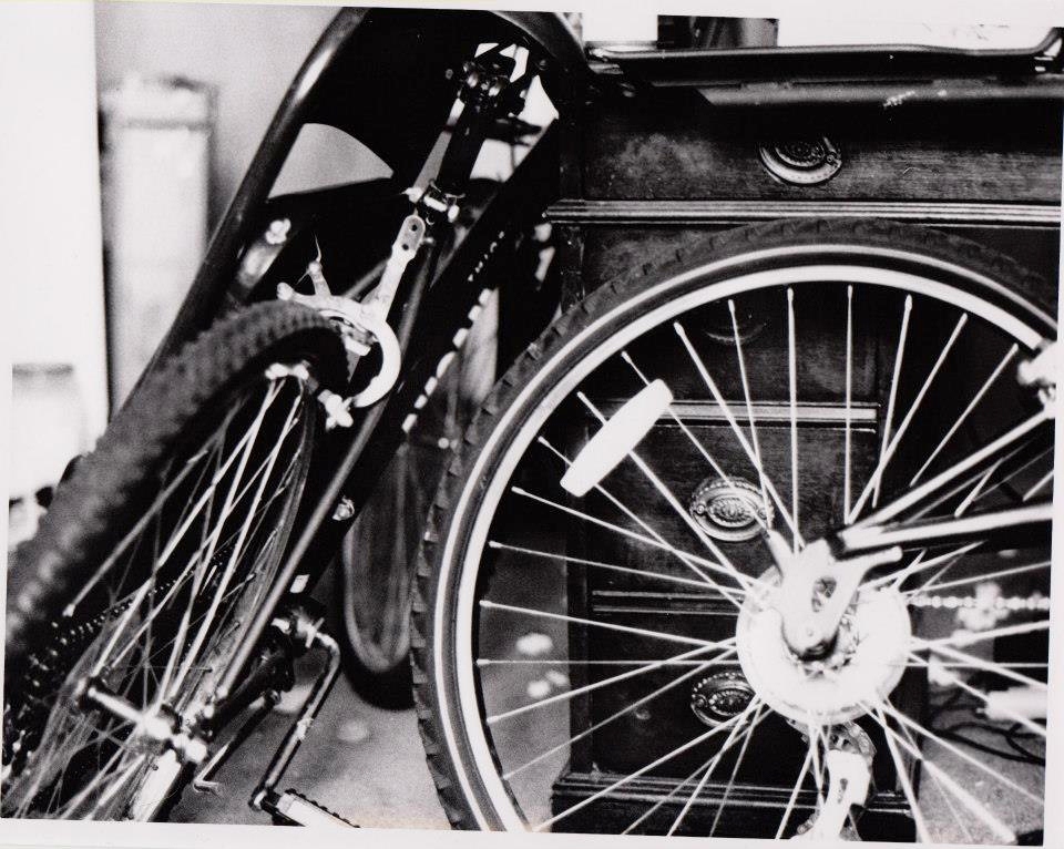

here are some flatbed scans of a negative I made for a depth of field assignment. the first is the one that was turned in printed in the schools darkroom. this was 7 seconds at f16 with a grade 2.5 filter and developed 1 min. the second was done a few hours ago in my home darkroom, 5 seconds at f11 with a grade 5 filter and developed 1 min. you can see there is a significant difference in contrast. I really hope the problem is with the bulb, I plan on replacing the lamp with a duel dichro once I get a bulb for it. the only other thing I can think of is that my developer is more diluted than what was provided at school. I don't know how it was done at school but I had mine at 1:1.

See the borders of your flat print are grey. That means either that you have a bad safelight, or your paper is fogged. Have you tried taking some of your home paper and printing it at school?

In your scans, it sure looks like the paper is fogged all over. That's what mine looked like when I used the wrong safelight with that paper.
