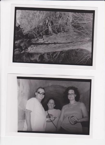

so far these are the best images I have been able to produce using a number 5 filter. I really don't see any sighns of fog the exposures are consistant. the compositions suck but they are the only ones to come out looking somewhat like they should. the problem is they're flat, and since I used my highest grade I can't give them any more contrast.

Are the negatives very thin (under developed or under exposed)?
no not particularly. I had over exposed them by 1 stop since I was trying out a new developer (WD2D+) the negatives ended up coming out pretty typical.

I am really frustrated right now, I can't figure out what I'm doing wrong. I've had my darkroom equipment for several years now but it has yet to give me a decent print. I got fantastic results when I was in school using their darkroom, so I know its not my negatives or my technique, but when I try to do it at home they always turn out flat, lifeless. I'm using basically the same setup the school had, same 23c enlarger, same zeiss lens, same dektol developer. I just can't figure out what is so different about my setup compared to the school's.
