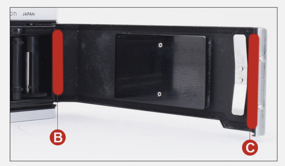

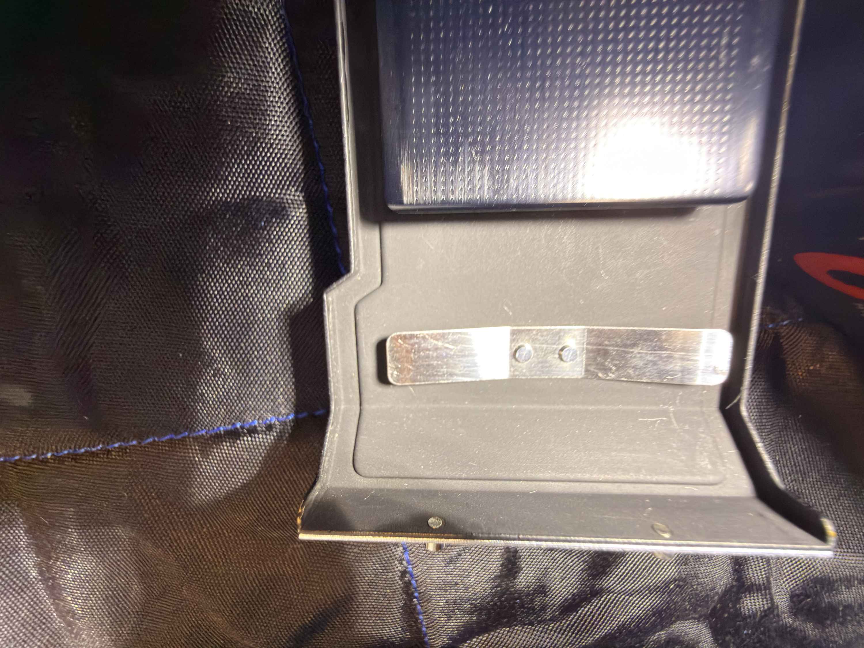

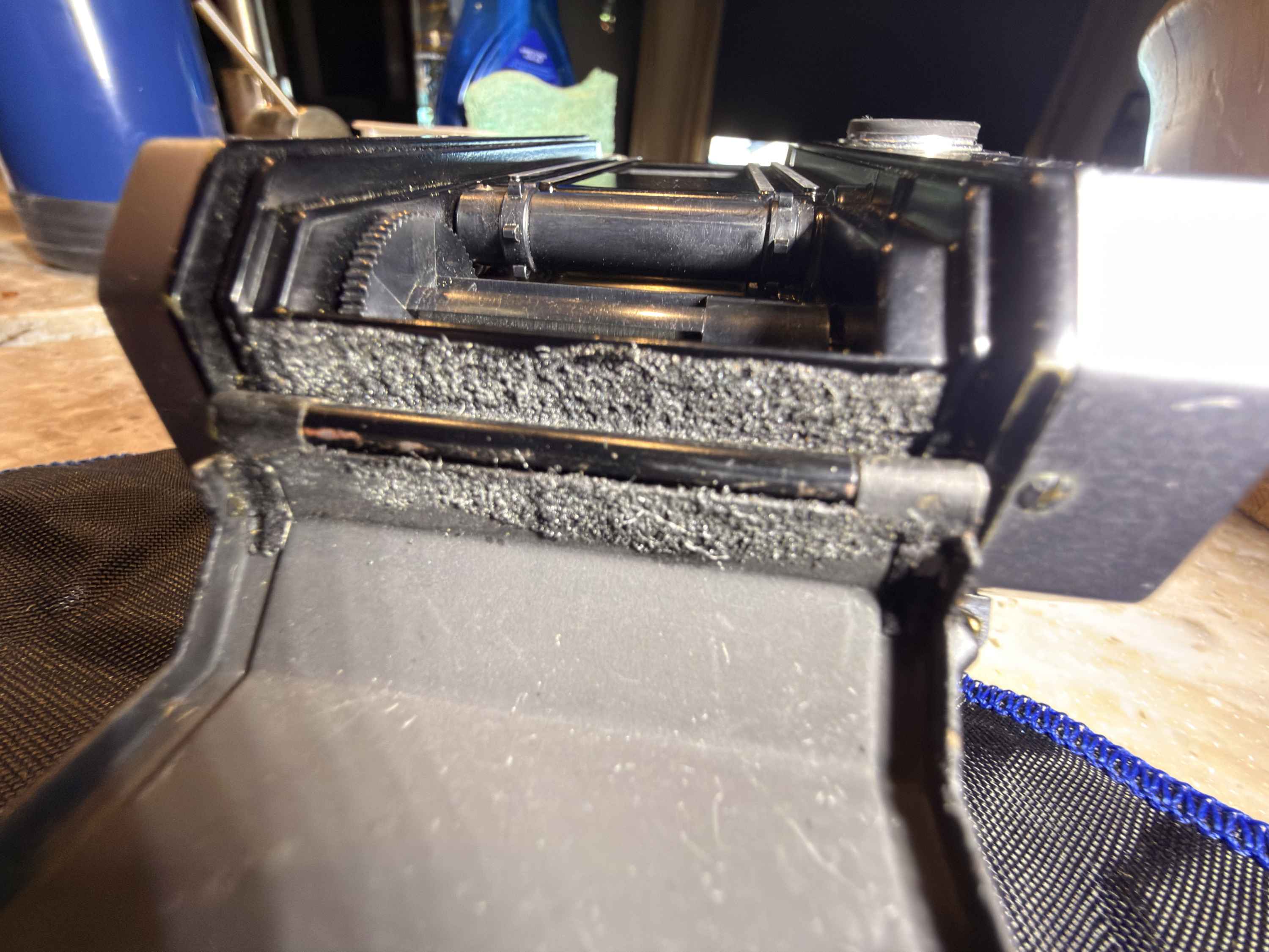

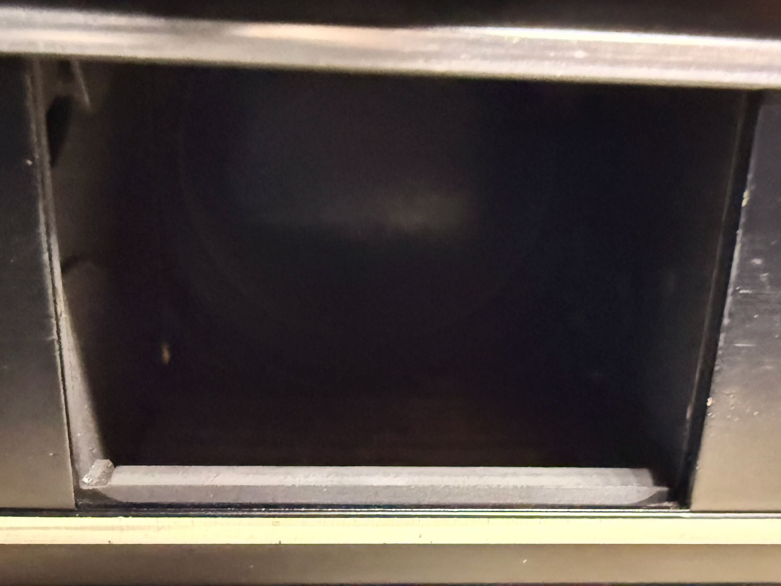

After cleaning the camera to make pictures, I noticed that the back door is completely missing the seal by the roll of film. The seal kit photo shows there are supposed to be seals at both ends of the back door. I made a photo of camera open on B, looking to the end of the camera that I believe is the problem. Nothing appeared to be shiny to my eye.
photo 1 is seal kit from web. photo 2 a terrible looking seal that is shedding, photo 3 no seal by the film roll side of the camera, and photo 4 looking into the camera. Did early Nikkormats FTNs not have that seal? mine is probably in the first couple of years of production. The seal missing, and that the door is a little sprung/mishapen makes sense to me as issue only occurs is only in brighter conditions.
photo 1 is seal kit from web. photo 2 a terrible looking seal that is shedding, photo 3 no seal by the film roll side of the camera, and photo 4 looking into the camera. Did early Nikkormats FTNs not have that seal? mine is probably in the first couple of years of production. The seal missing, and that the door is a little sprung/mishapen makes sense to me as issue only occurs is only in brighter conditions. View attachment 419092
I had a similar issue on my Sears KS-2. Didn't notice it until I used the camera without the half-case.
To fix it, I used some thick black felt in the proper areas, and it's been fine.

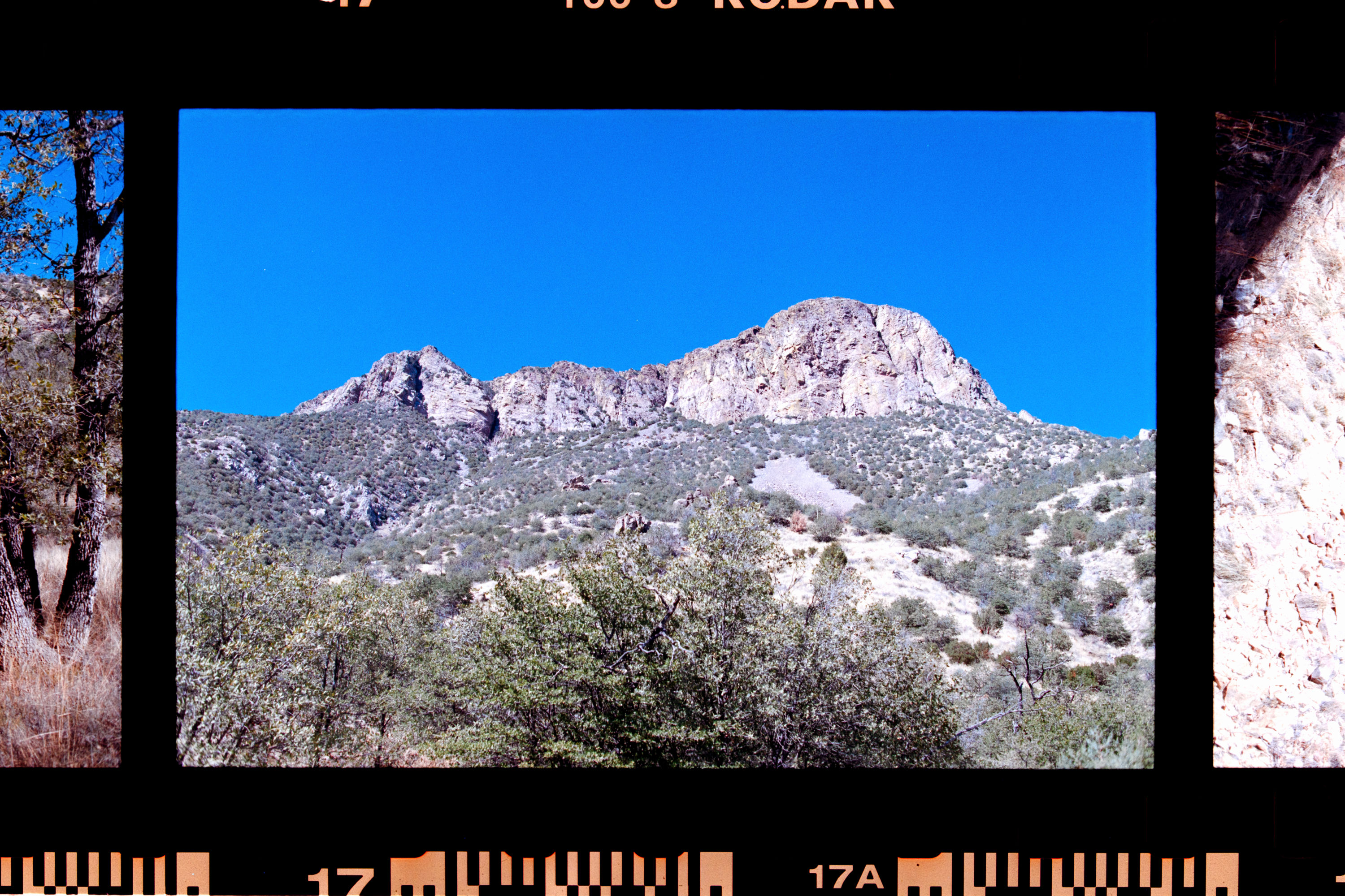

Here's a jpeg of raw scan, with minimal editing from import to LR.

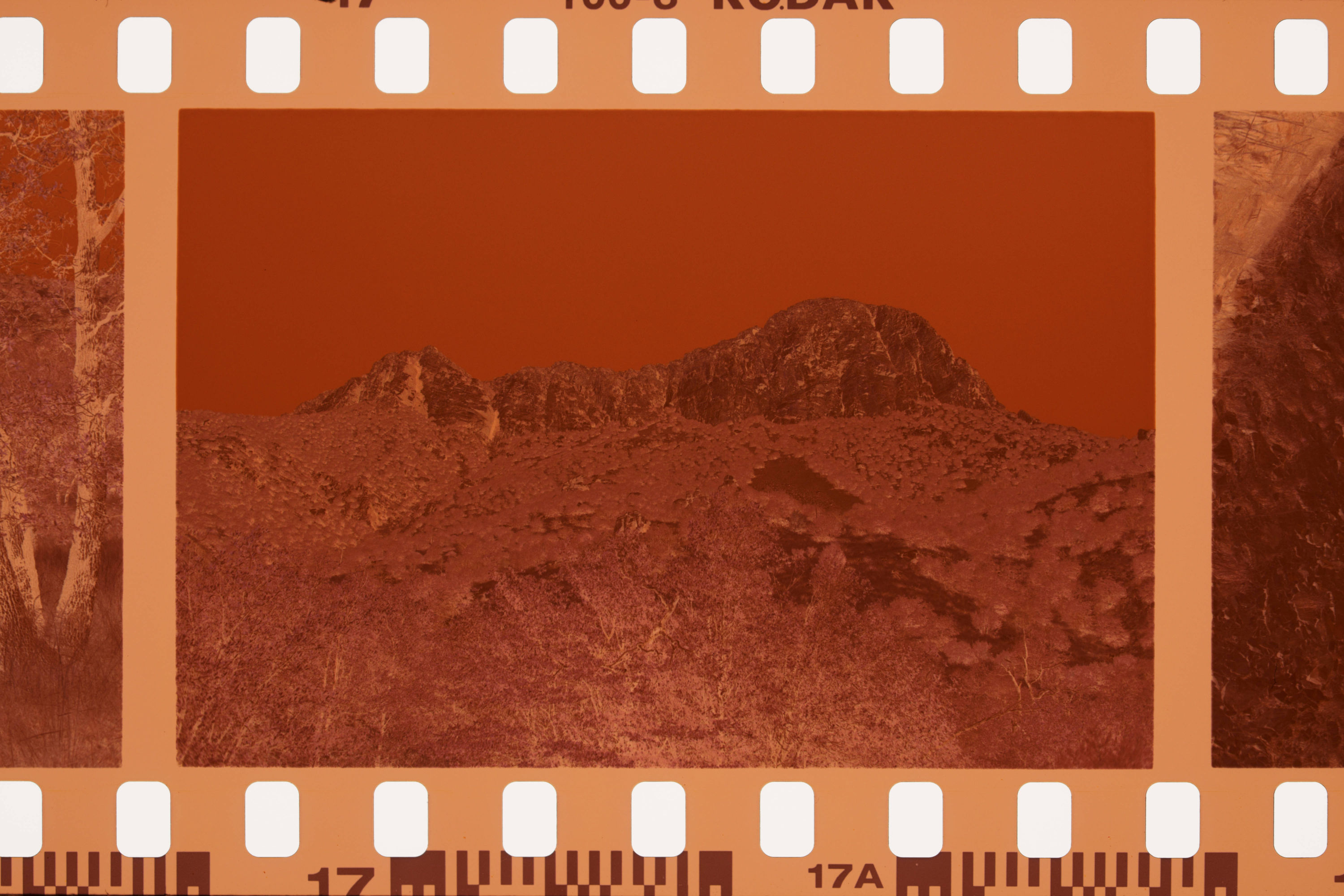

Here's positive done by negative lab pro, some editing to accentuate the issue.
Thanks for all the useful feedback!

Thanks; it's very faint, but it's there and there's nothing outside of the frame that seems to correlate to it.
The suggestion by @Alan Townsend to tape up the back of the camera, if only temporary to see if fixes the problem, is worth trying out.
Yes - the artifact is on the negative.
Wow it is faint, so faint that I wonder if I see something that the thread has programmed me to see. I could probably look at this in another setting such as the Gallery and simply think it was a nice looking print of a nice scene

Hi to anyone looking for the next step to my issue. An update. Short answer the squiggles did not go away by replacing the hinge seal. Good news is I didn't make the problem worse, and my camera is no longer shedding foam seal particles and scratching the film.
I've included two more scans today. I made photos after cleaning the interior of the camera and only replacing the foam hinge seal.
My new thought/theory is it has to do with the act of making a photo, not just a light leak from the back. My reasoning is that the leak does not extend into the rebate areas. Full scan and a tight one showing the issue occurring on the next frame too.
full frame close crop with next neighbor frame, squiggle does not jump the frame gap.
I think I will accept that this camera has a character flaws (like its owner) and not to sweat it. I'll continue to inspect and see if there is a loose screw somewhere, or a shiny surface, or a light leak from the mirror while up? I did buy a case, so I'll see if that somehow covers the issue. At least it will protect the camera and looks kinda cool. I did buy a much newer Nikkormat FTN (seems like last year of production) and film tested it, it doesn't appear to have these kind of issue, so that will be my main camera, this will be a backup for a different film.

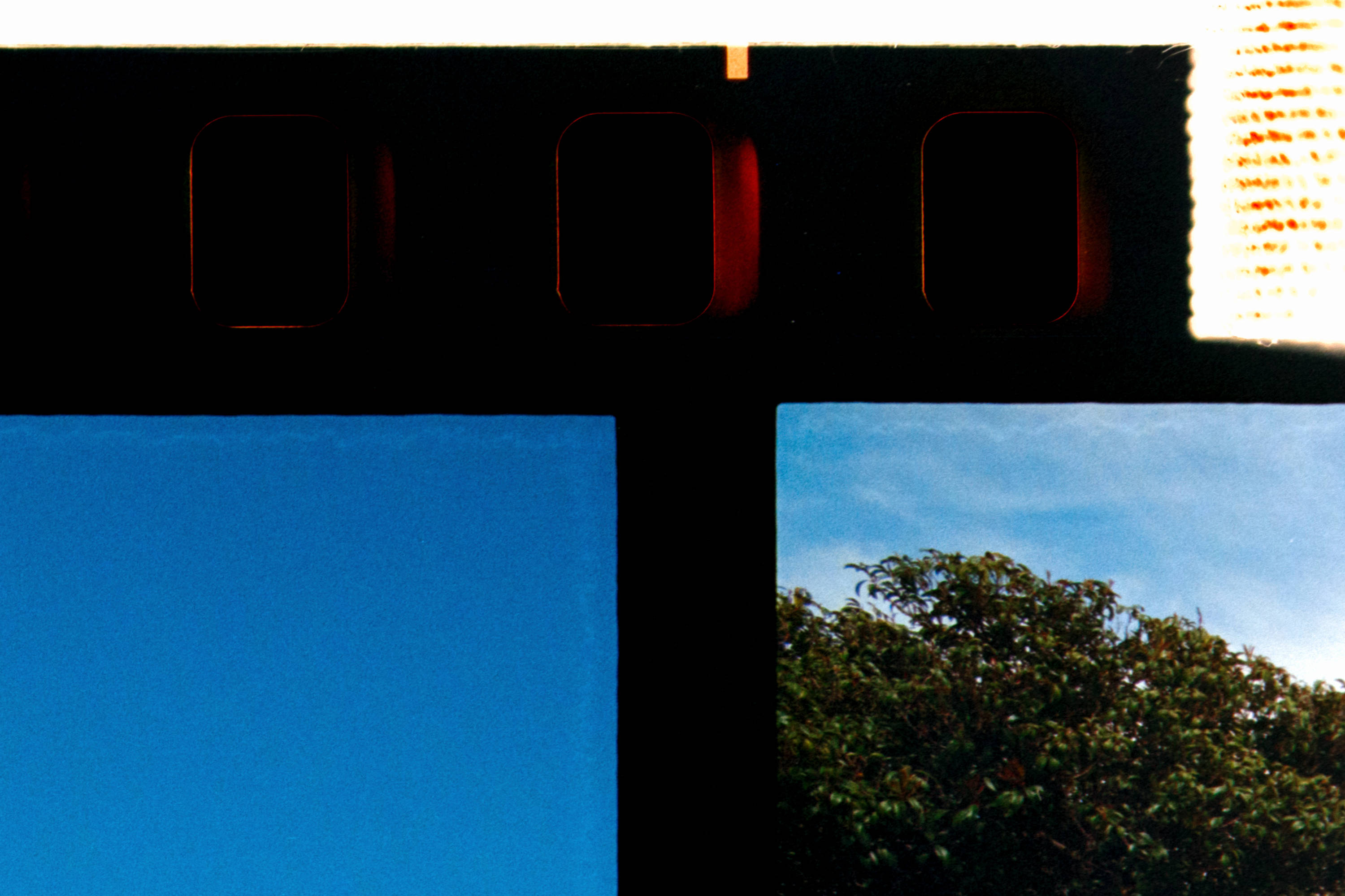

Btw, with your phenomenon somewhere in the back of my mind, I noticed something on a recent roll of film I shot the other day:
This is the corner of a scanned 35mm frame, but note it's on Kodak DoubleX, so negative instead of positive; i.e. the 'lighter' line actually inverts to a darker one on the print. So it's the exact opposite of yours in that sense. Also, it's a totally different camera (Canon EOS 30v). I think I've only ever seen this when using a filter (yellow in this case) on this particular lens. But I may just have overlooked it most of the time.

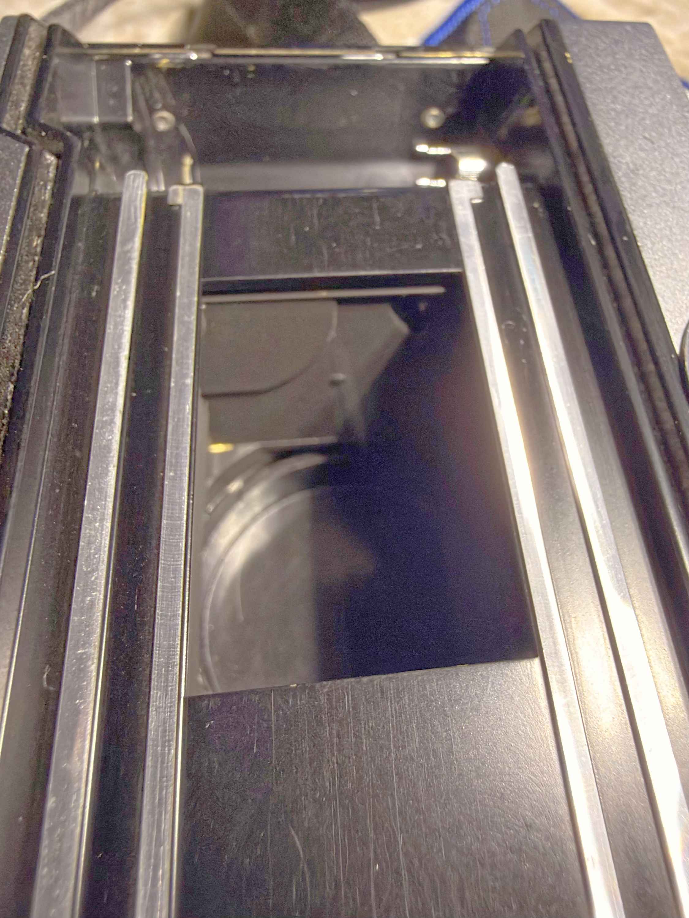

That film gate is positively glowing. I think the squiggliness is from the slight variation/scratches in that shiny surface. Try some matte black paint on a toothpick or tiny brush, very thin, only on the area which is at 90 degree to the film.
Also, see if the high points and low points in the squiggles can be mapped to a very close-up and detailed image of the film gate in bright light.

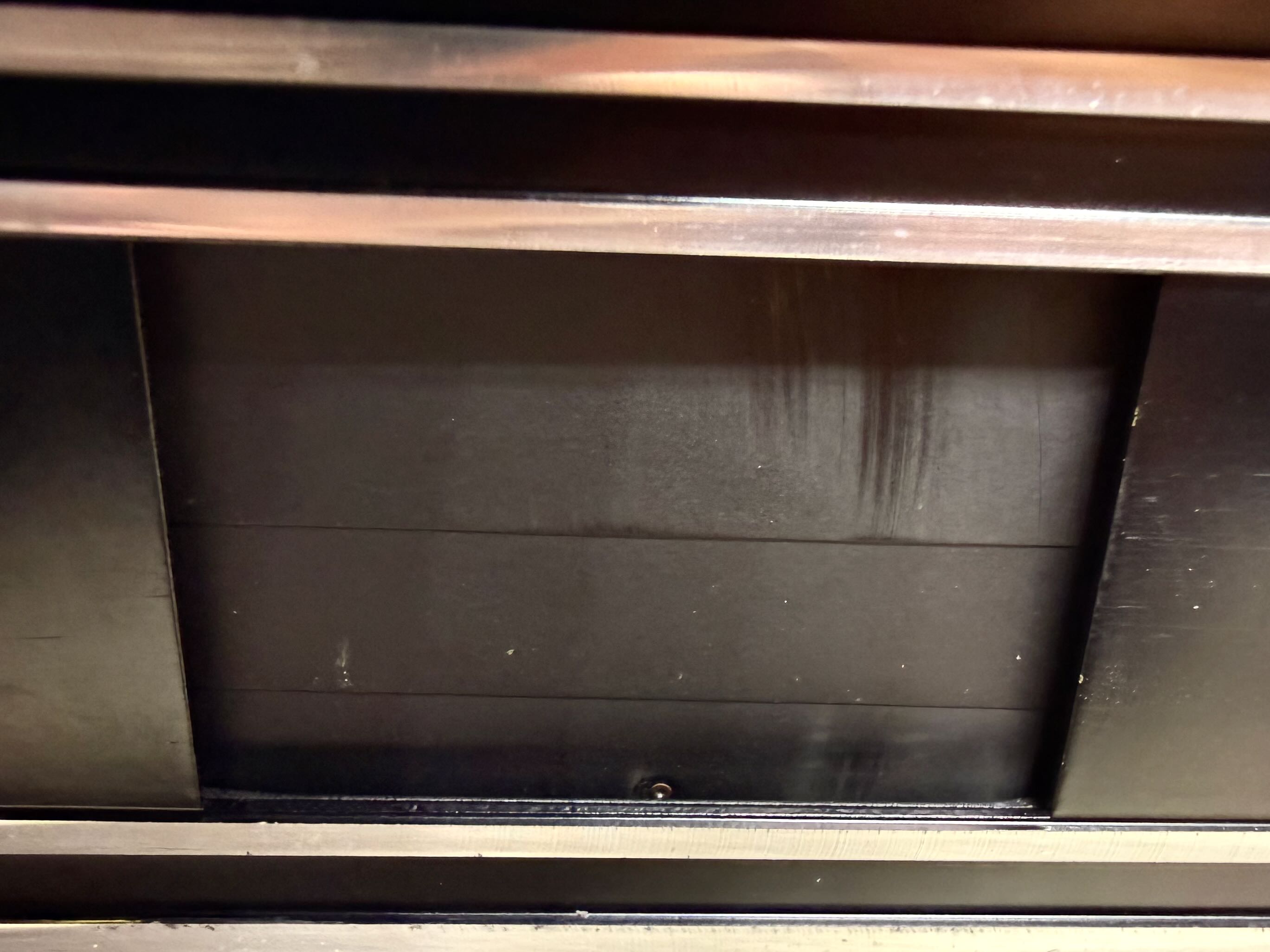

The issue occurs mostly in with a bright sky, never in shade that I can discern. Here are two better photos of the film gate. I wish I had tried to do this earlier. I think I can see the pattern in the gate, the squiggles.
How to fix? I saw the suggestion of toothpick and matte paint. I could get some matte paint from the local Hobby Lobby I bet. Can I use a sharpie? Acrylic or oil based paint pens? I've seen both available here. Seems like matte finish would be important.
In your 2nd photo of the last post it appears your gate is closer to one side of what's behind the shutter than the other. That would explain why you only see it on one side - it's being shaded on the other side.
Whatever you use it should be matte black and not something that will peel off and cause problems with the shutter. Normally there would be some sanding of the surface first but I'd be worried about doing that based on its location.
Thanks, I'm not sure how wildly distorted the iPhone macro lens is, but there's some for sure. You expressed my fears of something peeling and getting on the film or worse jam up the shutter. Sanding seems impossible, especially for a $65 camera. I was thinking cleaning with alcohol like I used to clean the camera body seals.
