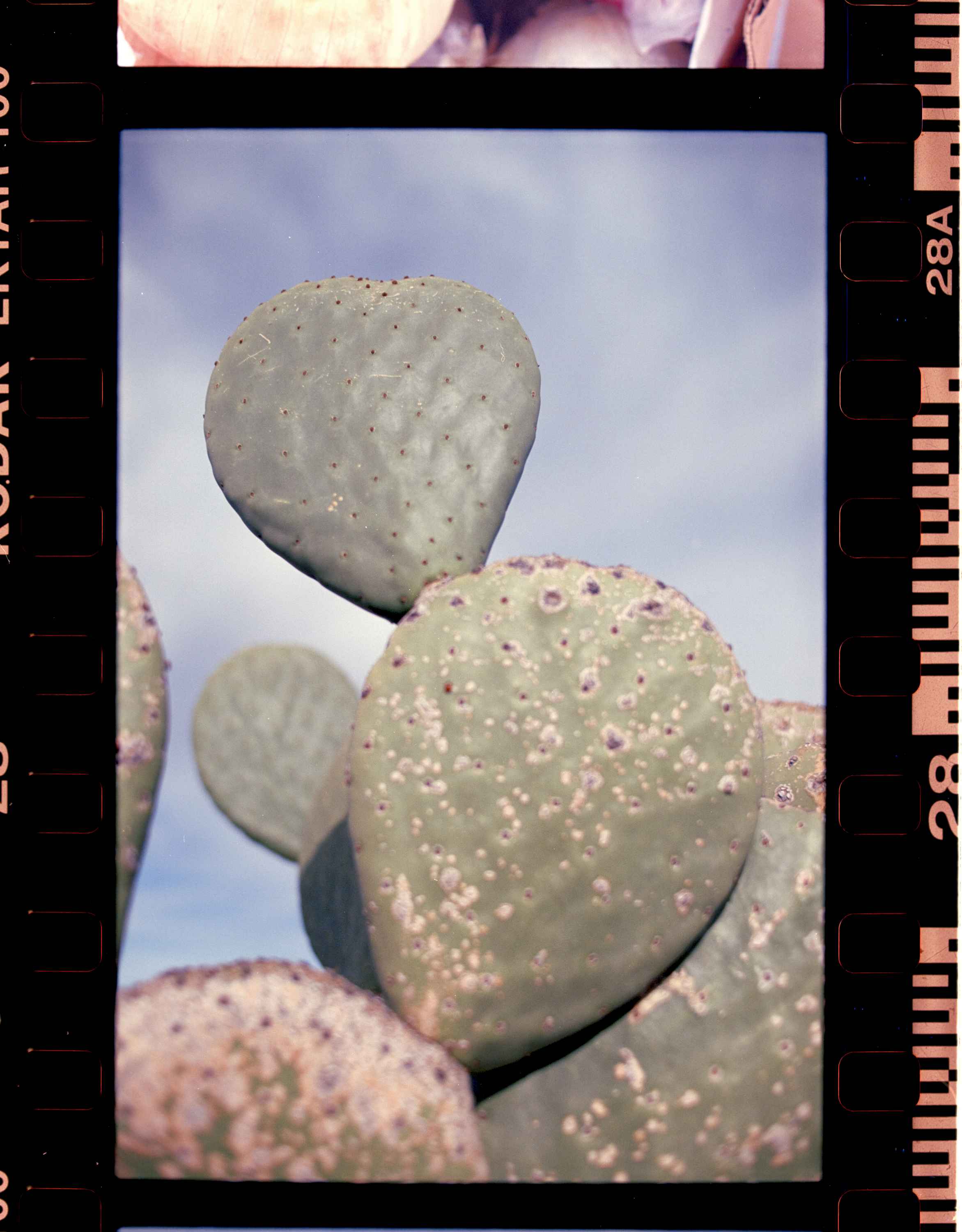

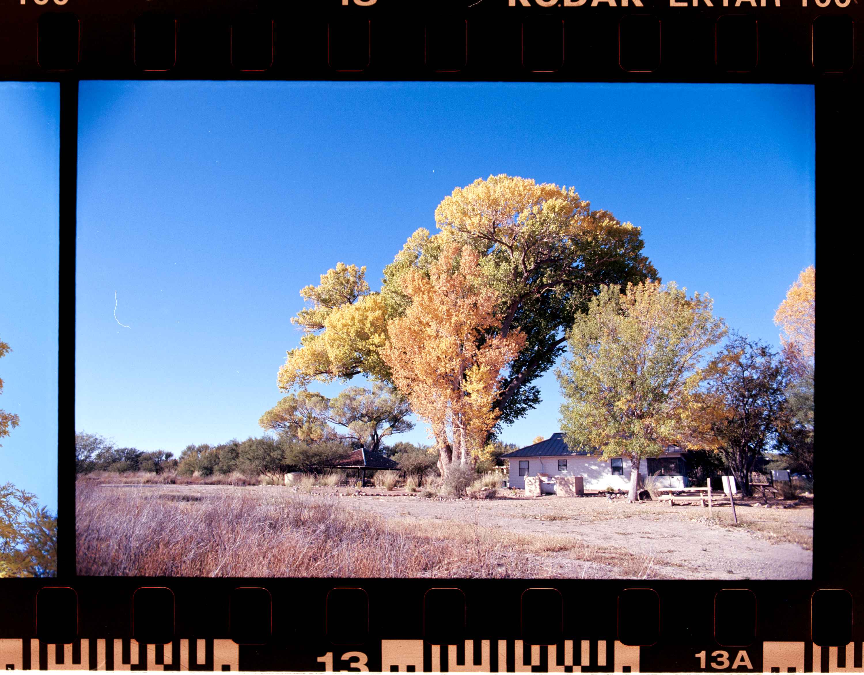

Thank you for all your questions and thoughts. Here are 3 photos, one of each lens, reduced to 3000 pixels and 40%jpeg to fit under the 2mb rule. this was my first roll and I took some notes, Ektar. Upon looking I see more of an issue on top and right of the photo. the jpeg file has the lens and exposure. I'm only concerned with the weird reflections, not the dust. These were done in DXO to do the file size reductions ( not on my Lightroom drive right now), my usual tool is Lightroom Classic.
I see that it may likely be a film/frame gate reflection issue too now. I have some photos in less direct sun conditions I'll post in a bit. I'll work on making a photo of the film gate too.

Here are 3 photos that have no issues, all in less direct light conditions. I think the collective wisdom has found my issue to fix. I'll still go work on making a film gate photo.
Thanks again.

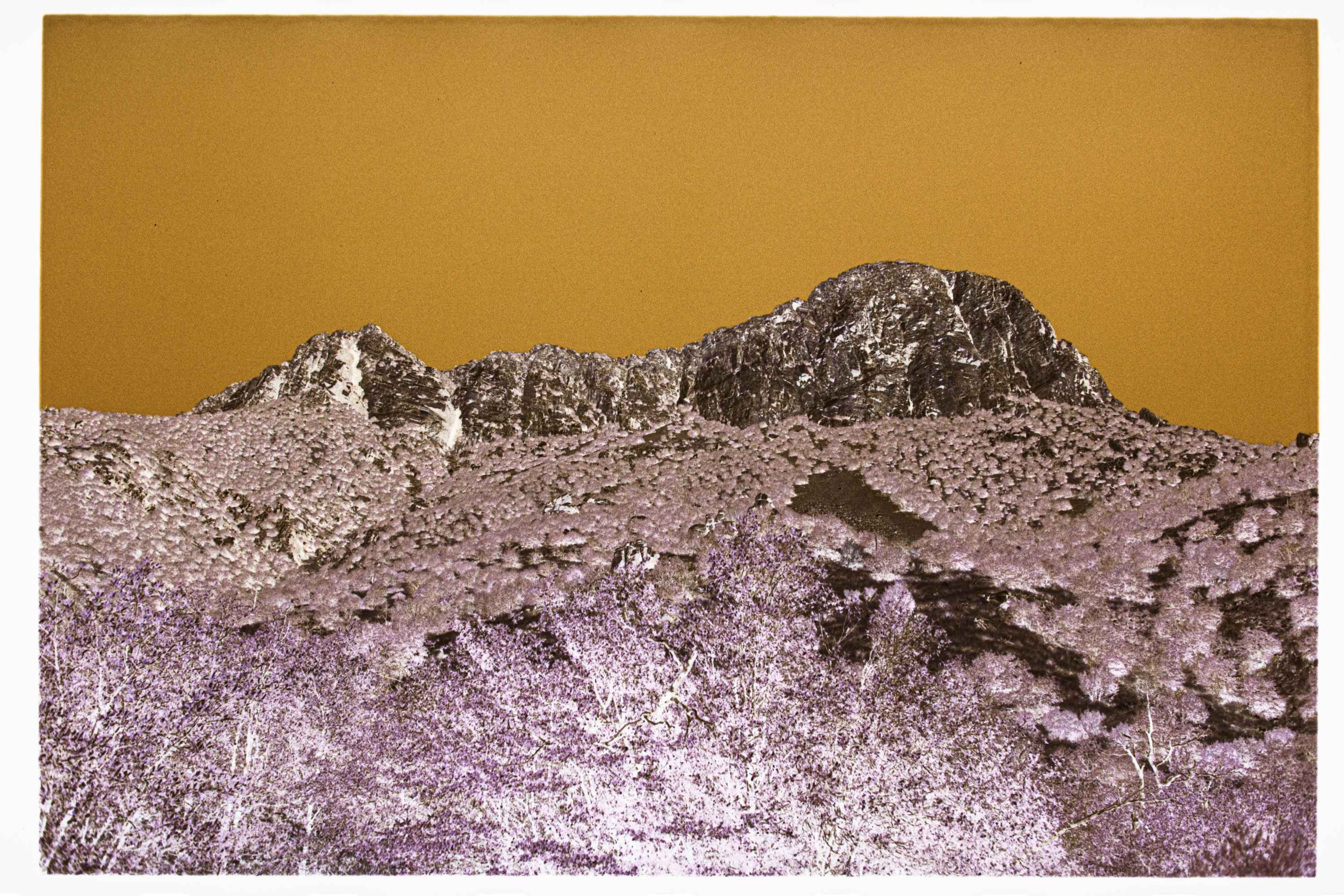

Hi, I don't have an elegant or useful way to make the neg photo. I do have a raw scan from another newer roll with same issue. Harder to see I used some contrast to see in both raw and positive jpeg. I understand it maybe harder to see with reduced file size, etc. Thank you for your patience and interest.
Peace

I bow to the consensus that now exists but isn't what you wrote above, Matt, still relevant? Don't we need digital pictures of the negatives?
Yes we would at least prefer to see digital pictures of the negatives.
Among other things, the appearance rebate of the film - the area outside the image area - tells us a lot.
And FWIW, a consensus built on part of the information is not as good as one built on more :smile:.
