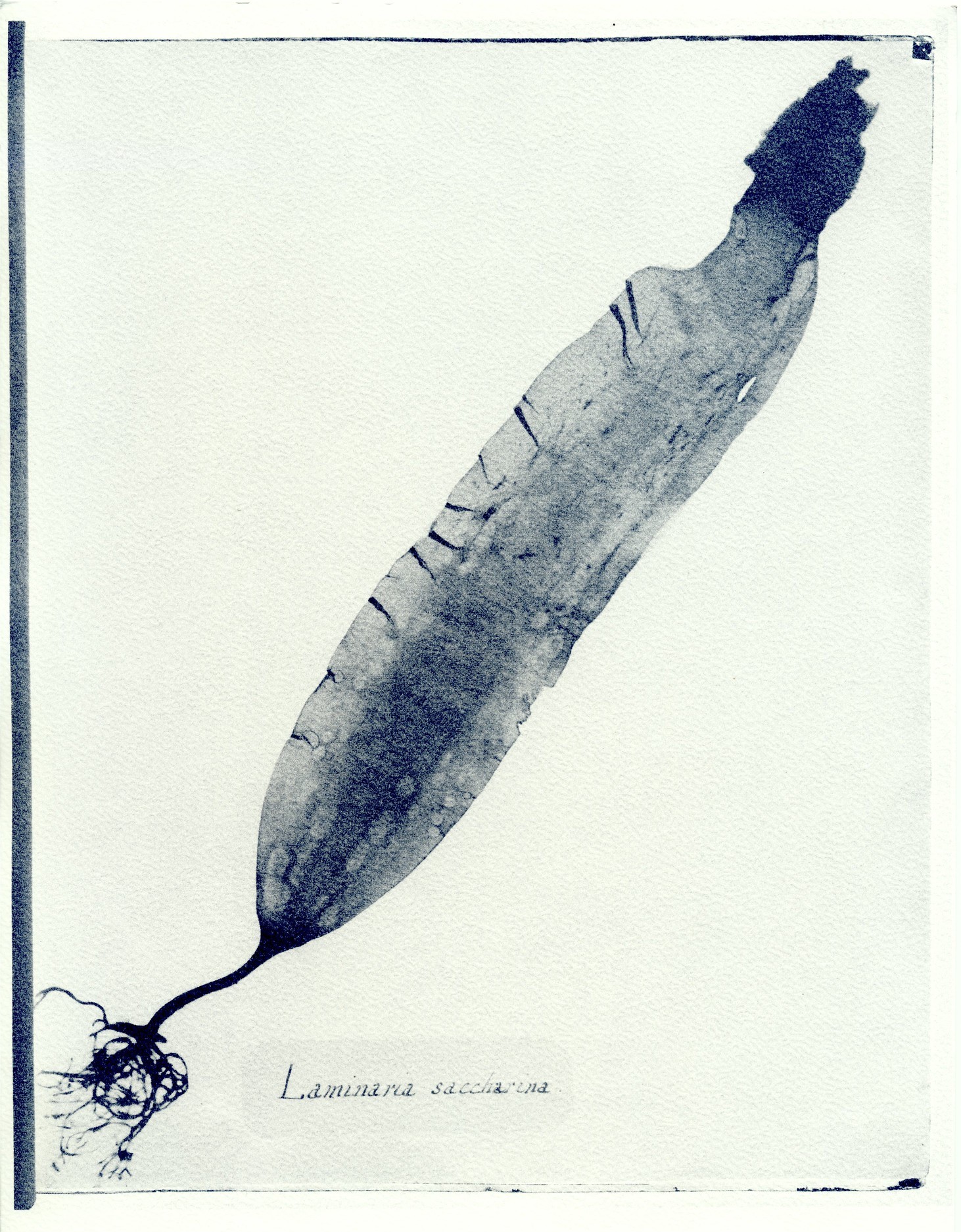

Not too much progress on the FAC jet printing. I am working on the "ink". Printing seems to work for quite a while but then sometimes stops. I am sure I will figure that out. I know more than I wanted now about refilling, opening, cleaning etc of cartridges. The new printer has not been sacrificed yet but will be due soon.
Let me add one of the last prints I did with the FAC inkjet printed process. For me this process is good to go ie ready steady. (which is where I loose the interest)
The next goal is printing on Silver Gelatin photo paper or Xray film...
I have always been interested in Anna Atkins her prints but then wanted to see the positives.
High resolution scan from New York Public Library Digital Collections.
Inverted on computer with PhotoDonut,
Image printed with FAC by Inkjet
UV exposed to max about 30 minutes
Kferri developed
short toning with Haritaki
dried scan
Size A4.
I am very happy how this reveals even more of the details of the original prints by Anna Atkins.
The rest of her book has to wait till I have cleaned the cartridge again.
