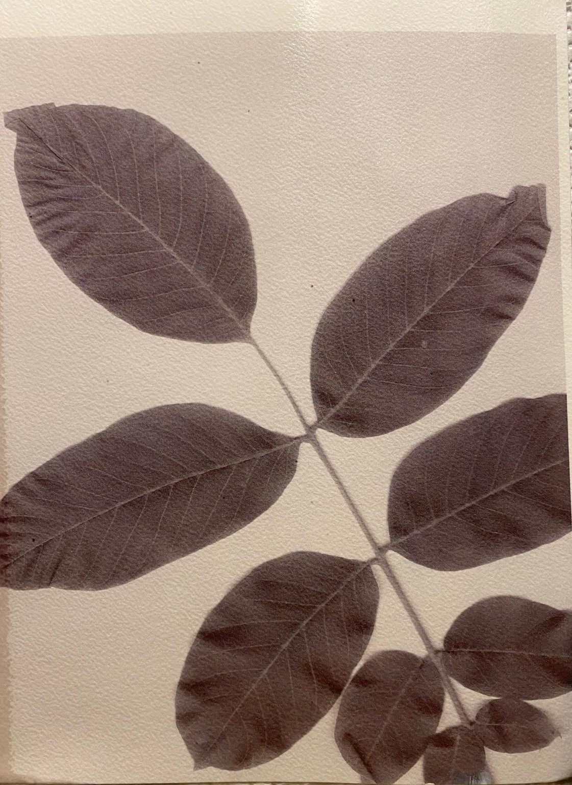

Let me share my first example, here some leaves on the glass, pressing the copy button to print in FAC expose for 10 minutes UV and develop with Kferri, then 10 minute toning with Haritaki.
the HP 901 cartridge - here filled with 10ml dest water, 2gr FAC 2ml of denatured alcohol, about 10ml water there after. (this is ongoing experiment)
Process
- use copier-printer to print FAC on paper (bypassing the digital negative)
- expose to UV
- develop with Kferri
- for this one toning with Haritaki

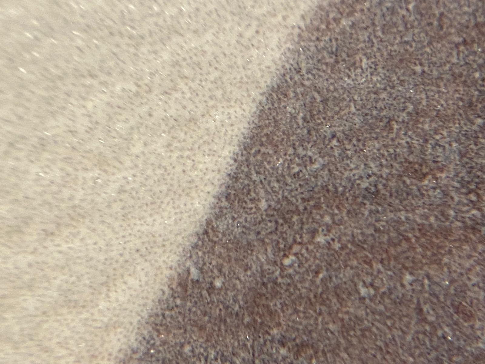

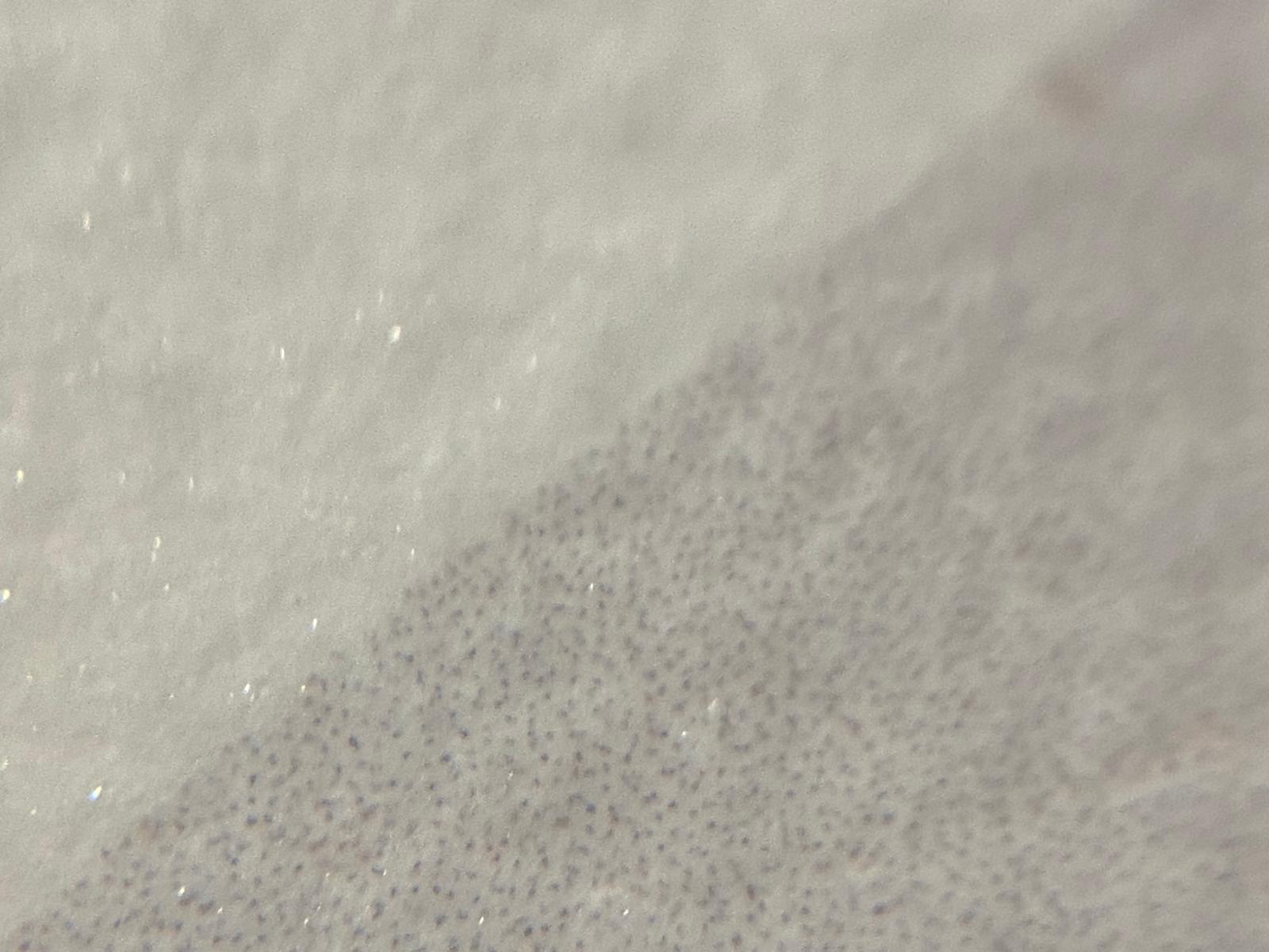

Print from computer, scan of the same leaves. added some contrast, this resulted that the background is no longer pure white though.
Printing from computer I don not know which setting is best yet but I selected HP Photo matt. The banding from the draft printing on the copier mode is now gone.
Detail
Detail top of the page where the gray background just starts
Detail of the leave and background.

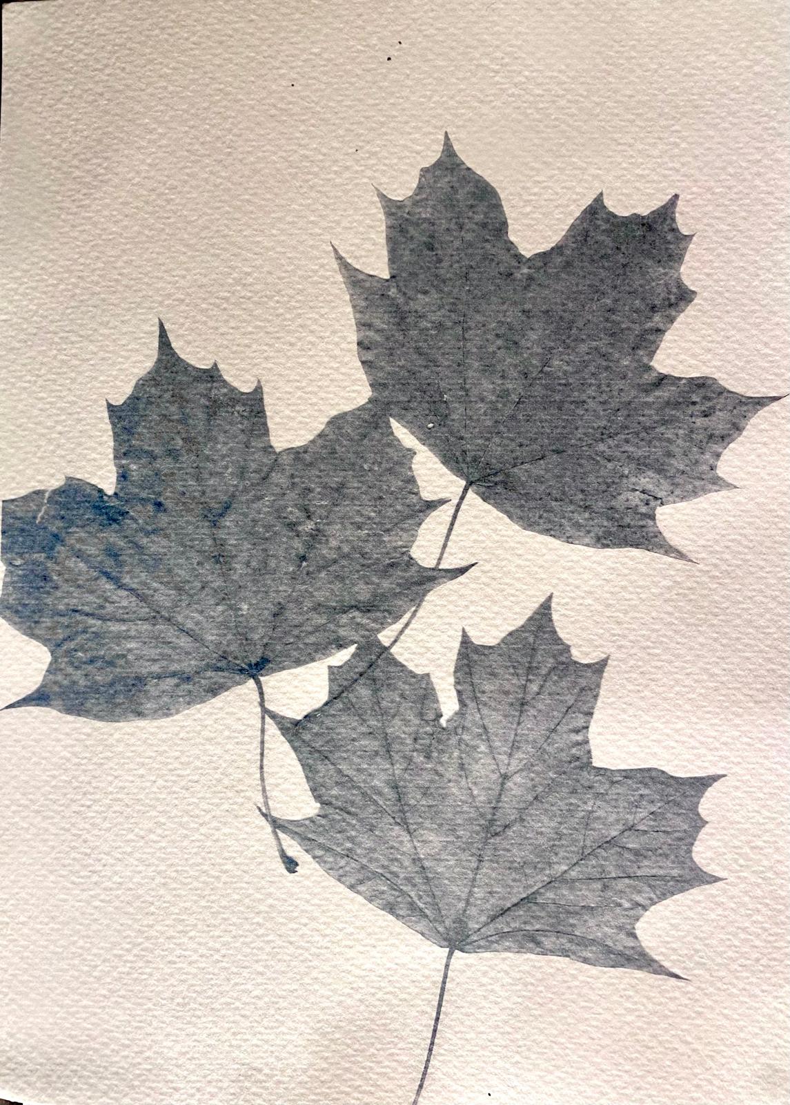

Update
I will give a small update for those interested. Yesterday after many prints and trying different papers the cartridge stopped printing, refill also did not help. If fiddled a long time with the remedies known, taking the cartridge in a bath wiping nozzles shaking etc. 17 years with 16 doing nothing is quite a bit anyway. So on to the second cartridge, filling it first with water to see if I could print it empty. This was also a dried out but not so much as the first cartridge. It took anyway 8ml water of the 14ml that it could take when empty. I made some 50 copies to see if it would start working and long and behold it started printing, and nice black (ink) too. After some 20 prints even the draft prints of the copier modes was perfect. I turned the papers round and printed the back to get as much black toner out. After that it could fit about 8ml of 20gr/100ml FAC-dest Water. I did not add anything else.
Of and print many copies again. After some 30 prints it started printing more and more FAC.
The learning here is that printing only FAC and water it does not absorb as well as the previous mix where i had 2ml of Spiritus added. This is not a problem during print or exposure but it is when applying the Kferri. It gives steaks when brushing it on. So i will add again on the next fill the first mix.
Meanwhile some empty cartridges should arrive the next days to have more variants on hand.
A print from this evening just brushed with Kferri and rinsed, before toning with Haritaki.
You can see on the top the uneven coverage due to some wash-off. I am also still not happy with the darkest blue, the toning does help a bit with that though.
I like all the gradations of the grayscale though.

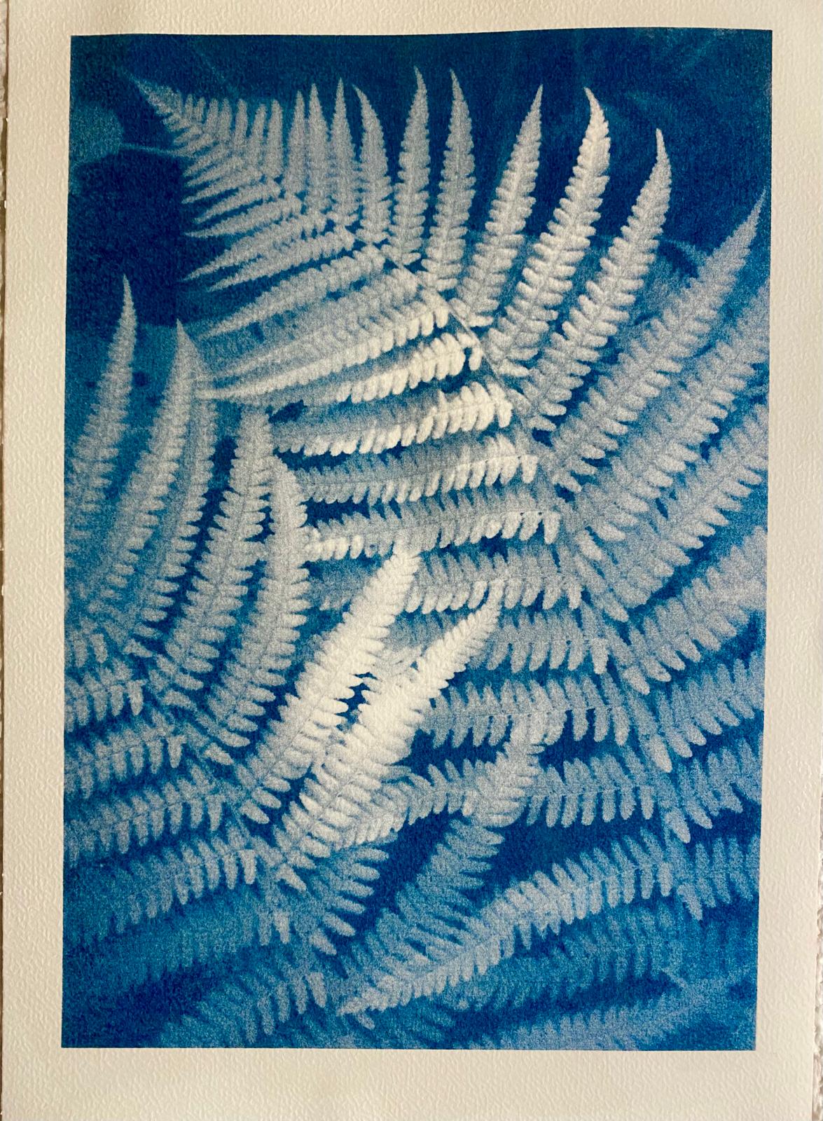

Update
I just made ready the latest print with the improved ink FAC solution. It keeps better on the paper no longer streaking when brushing the Kferri on.
now also the darks stay in place.
cheers
Jan.
Short followup Fern print in previous post now dried down had been toned short 5 mins with Haritaki as part of development. Dried down nice dark blue-grey.
400dpi scan
Another test with a scan from my Hong Kong pictures. Very happy with the deep black tones. Looks a winner this process. For now the cartridges are emptied, I have to clean them because without initial cleaning more black crusted ink was clogging. Will keep you updated when I have the next process dialed in.
Certainly worth a try if you have an old printer laying round.
400 dpi scan
detail of the dots partial scan on 1600 dpi

Jan, those prints are stellar! I love them! And they're every bit as good as what you'd get with the regular 'digital negative' route - but this process skips a step and saves materials. It's awesome!
I must say I also love the toning. I'm tempted to buy some of that Haritaki stuff. What kind/type do you use? I've had a quick peek and see a powder sold at around €1/gram in ca. 100g quantities.
I agree it has never been so easy, just print from the printer, the tonal curve is the same from what you see on the screen, and it skips the negative stage completely.
Almost unfair, but good for the environment, we can now use old printers, skip the plastic sheets and no longer pollute the environment with ink.
And best not depending on specifics in exposure times. You must just expose to the max.
