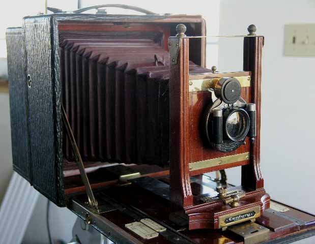

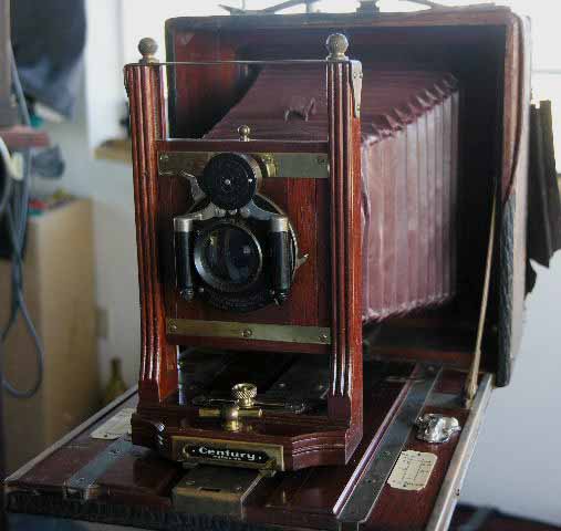

Hello Ron and All,
Well I found Jim's photos of the camera. Tell me more. Thank you for all the info so far. Making a hob to make involute gears is not a problem, but there are no gears at all with the camera. I am not against having someone else make gears, it is usually faster (and cheaper). I may have some other sizes (widths) of film. I bought them from J&C to cut down for old roll film formats well before I bought Jim's camera (last August).
Oh yes, thanks for the hints on cutting and testing with 220. I expect a number of disastrous test runs.
Cheers,
Clarence

Clarence - I looked at some of my old notes and found the gears for the #6 & #8 Outfits and #10 Camera were 32 pitch, with 14 1/2 degree pressure angle. I thought I would post this if you want to check on gear cutters. I used to look on eBay for involute cutters, but I never found any with the right specs. Maybe I gave up too soon. New cutters may be available. I never checked into new ones, thinking they would be really pricey.
Gear sets show up on eBay, but different Outfits and Cameras use different stem lengths/sizes, so you need to know what you are buying. If you have a lathe, you could make new stems to fit your Outfit.
Len

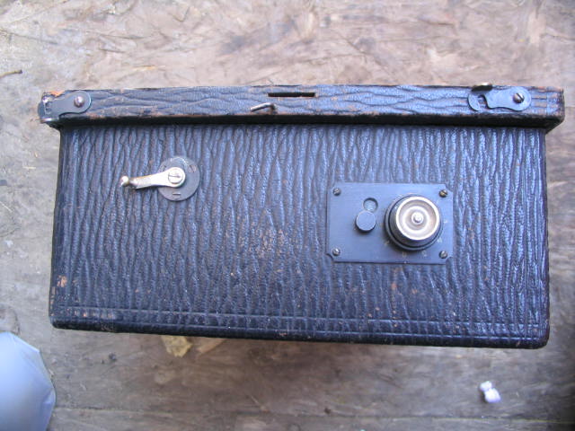

Clarence - I can't tell for sure, but I think your Cirkut back may be a fan drive, rather than a governor drive. Look on the back and see if there is a flat lever which moves to different marked speeds - 1/2 through about 1/12 (I'm doing this from memory, which is none too good). If there isn't a speed selector, and there is a shaft or two poking out of the bottom of the back (can't see from the pics), then it is a fan governor control. This means you need to make a set of fans, in addition to needing gears. Maybe Jamie has a pic of the fans. Fans should be way easier to make than gears.
eBay #110239245018 shows the bottom of a fan governor Attachment. I suspect your looks like this.
Len

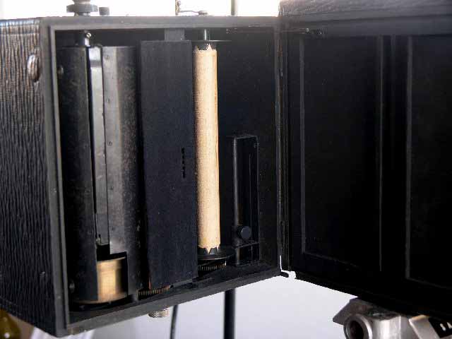

That looks like a fan camera to me. The gears on the fan cameras have holes instead of shafts. I will try to take some pics at some point. I have two fan cameras, a 10 and a 16. Each size can be a little different, but most of my 10 and 16 gears are interchangeable, as they were made at just about the same time. The shafts on the governor cameras tended to be different lengths for the different size cameras
Here are some pictures just taken. This looks like what you describe as the "fan" type. The scale on the bed reads 8" focus on one side and 14" focus on the other, with various pinions. The lens is a 5x7, Centar Series II in a B&L shutter. It is labeled "Eastman Kodak Co. Succ'rs to CENTURY CAMERA CO. The dial set is 1-100, B T with the CCC logo and Century printed on the centre escutcheon. There is only one aperture scale. The cirkut back is labeled "CIRKUT CAMERA, Made by, EASTMAN KODAK Co., successor to, CENTURY CAMERA CO., Rochester, N.Y.

Clarence - Yes, you have a fan governor back. I've been told some Cirkut shooters liked them better than the newer internal governor - they (maybe) run smoother, and you can make larger fans to give slower "shutter speed" effect.
Your lens is the double convertible, not the Turner-Reich triple. I don't know anything about the Centar, but suspect it will be just fine for contact prints. Did you get the ground glass back for the Century body? The Cirkut Attachment can be removed and replaced with a 5X7 sheet film back. so you can do both Cirkut and 5X7 with the same camera. It is also to view and focus when setting up a Cirkut shot. If you have the 5X7 back, you can do a couple of test shots with the Centar lens, if the shutter is somewhat functional.
As to making your own gears and tripod head, it should be an interesting project. Did you see the article a few years ago in "Home Shop Machinist" magazine about making a hobbing attachment for a milling machine? I don't recall if you only need one hob to make all different tooth gears of a given pitch. I know with involute gear cutters, you need several different ones for a range of gear teeth numbers. That would sure make it simple if you only had to buy or make one hob.
My notes show the ring gear for the #6 Outfit is 9 1/16" pitch diameter, with 290 (or maybe 296) teeth. That should give you an idea the approx. size you will be dealing with. I think the original was made of hard brass and nickel plated. You will also have to make a turntable of some sort.
