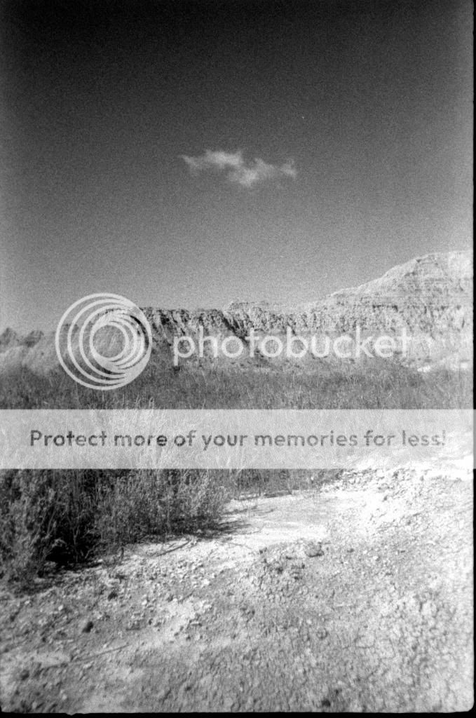

Am I the only one who sees uneven development in the 4th image? (1:100+salt). Right hand side. A less busy subject will show that even more. Stand and semi-stand is risky that way.
Definitely lighter to the right.
Now you mention it, image 4 (1:100 Salt) definately has a large 'streak' of lightness to it on the right hand 3rd, which doesn't appear in the straight 1:100.
Could it have something to do with the salt, though it doesn't appear in the 1:25 Salt? An effect of the long developing time maybe?
My guess is the lack of agitation.

Hi Ming Rider (MR) and fellow Apug'rs. I was intrigued by what MR was doing so I had to do the same :smile:
I had a roll of HP5+ that was shot on a plastic camera and have some Ardonal laying around and thought I'd try to replicate what MR was doing. So the fact that the below was shot on a plastic camera, err, take that with a grain of salt :tongue:
The images look great (remember this is a plastic 28mm lens camera with prob a 2 cent lens :smile: ), except sadly I have that right side streaking that was seen in the orig 1:100+Salt scan that MR showed. Should one be able to solve for that streaking, this might be promising....
Notes: I used a tank that holds 900ml. I put in 1 blank reel, then reel w film, then 2 blank reels in the tank. 891ml distil water with 27g of Kosher Salt diluted into it (in line with the 30g/l theory of MR). 9.5ml of Rodinal (well really Adox's branded Ardonal). Agitated for first min, stand, then agitate 10 sec at 30 min, 30 min more stand, then drain, stop, fix, wash; all in line with how MR did his test....
I love the look (I like my grain, which is why I love this combo), just not lovin the steak....
Well if you like the look the good news is you can have it without the non standard agitation. Agitate conventionally, as Ilford recommends is a good start, work out a time that gives the contrast you like and expose properly. You'll have what you like and evenly developed negs as well. No need to over complicate things.
Agree, I usually use Rodinal 1:25 or HC-110 with my HP5+; however, when Ming Rider (MR) possibly found a unicorn solution, I had to give it a go - biases asside. I am going to say that the neg above looks great, just not for me due to the streaks :sad:. I have to confess, of all the times I have done stand or semi stand, I get streaks, so it continues to not be for me, though dont let that dissuade anyone. Test with your tanks, agitation, water, etc.....
Actually the right side, since this started as a negative, has been developed more causing the lighter positive image. The area to the left did not progress as far.
That doesn't change the method needed to fix the issue, it just lets us define the problem properly...
