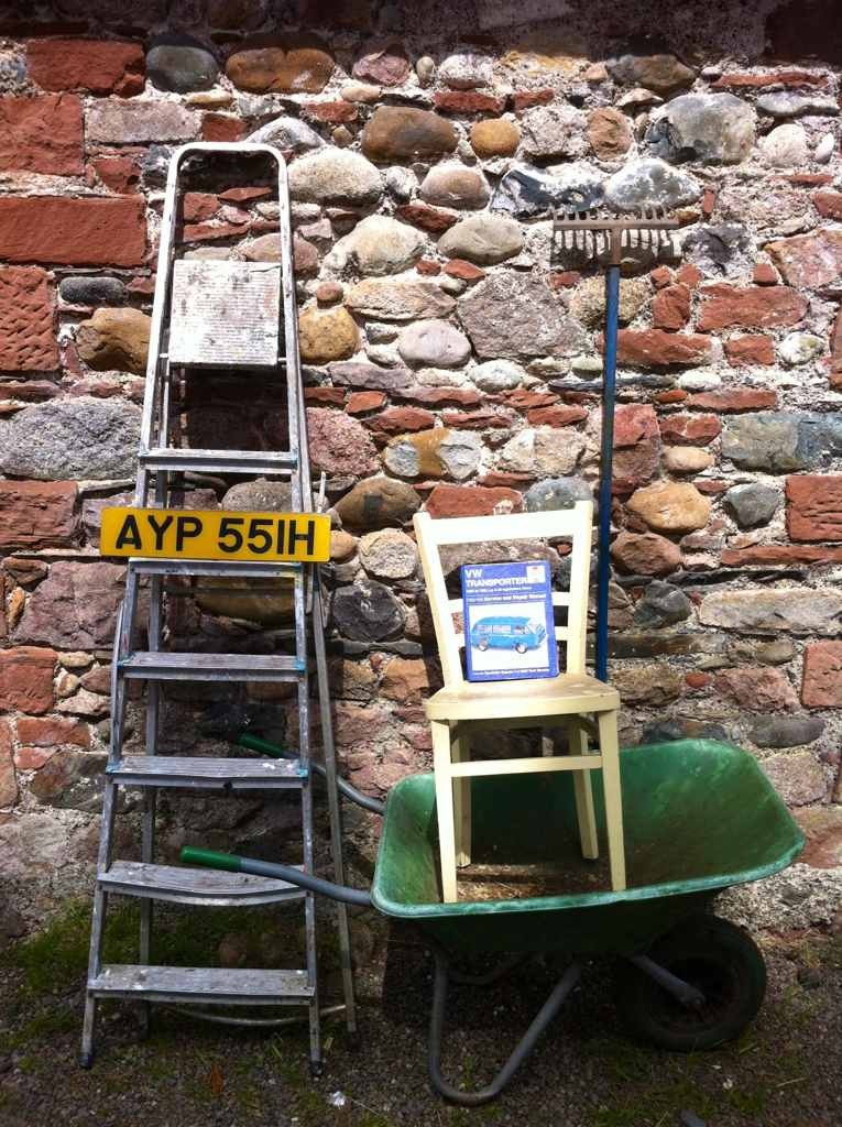

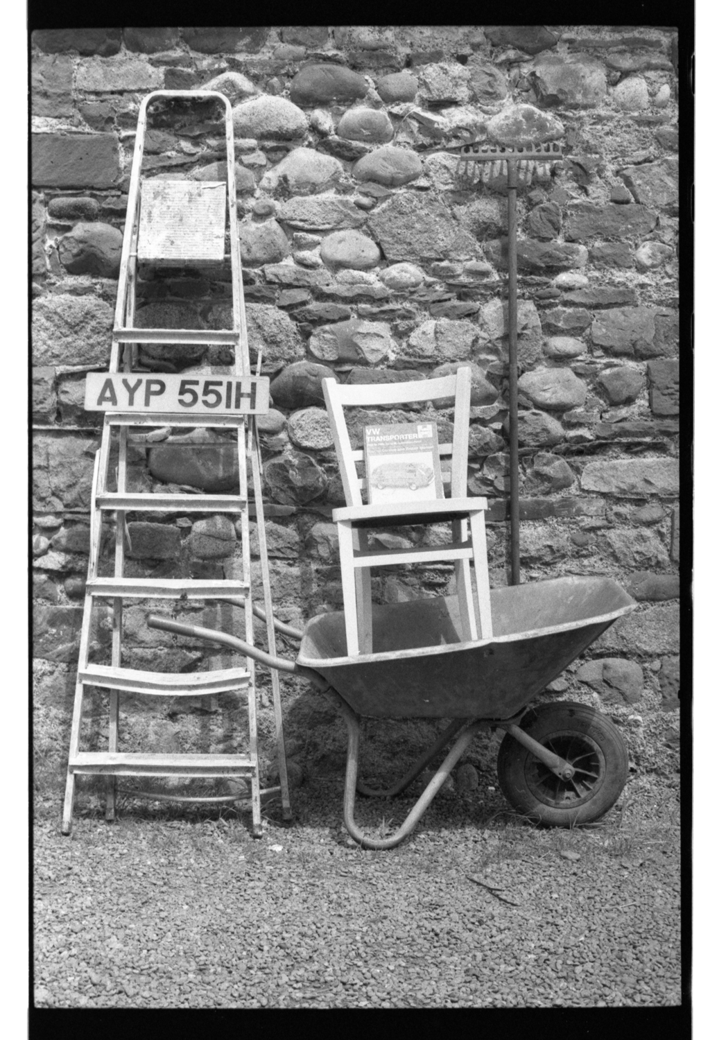

Hi Bert,
Here's a pic' of my test setup. I took the shots about an hour ago so the light has now gone to pot and there's shadows. But earlier was bright and clear.
Just waiting on the first batch of Rodinal 1:25 to warm up.
Good luck,
Hi Bert,
Good luck,
KevView attachment 70699

Nice setup,
I'll start looking for the props:laugh:
Cheers,
The downside of living in the country and with the wife away - I had to grab whatever was to hand. I did consider the Cats, Dogs and Horses, but they wouldn't stand still long enough. :D
Cheers,

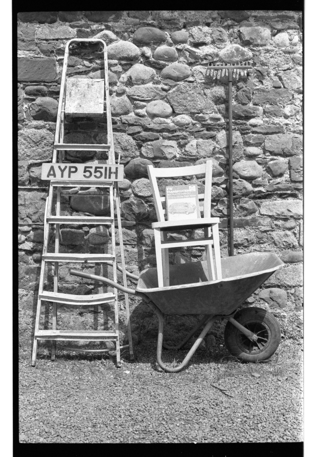

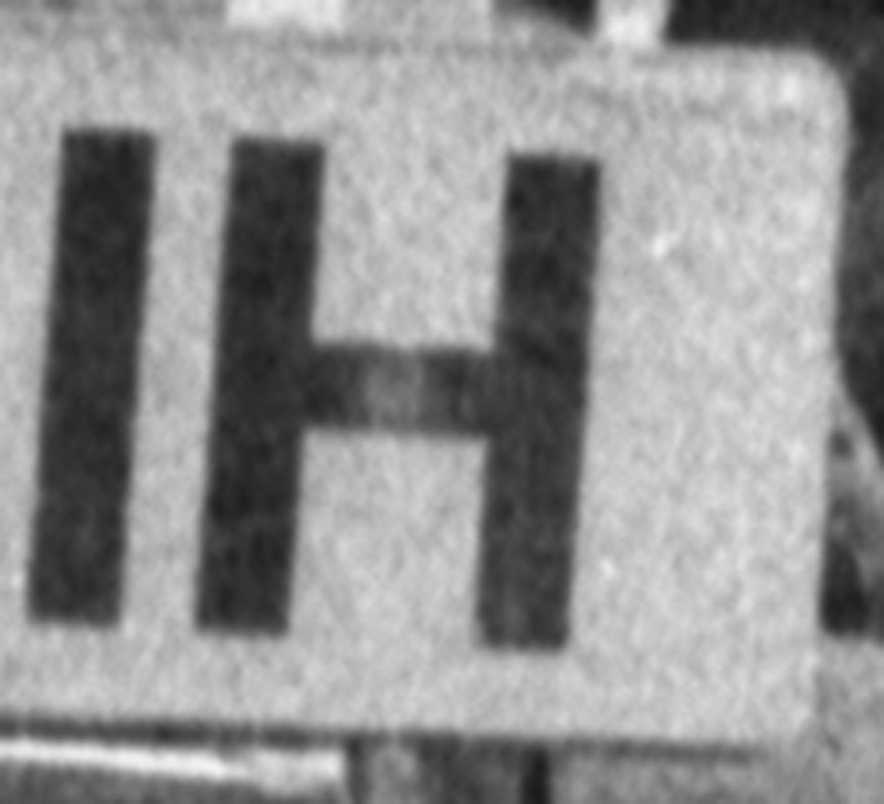

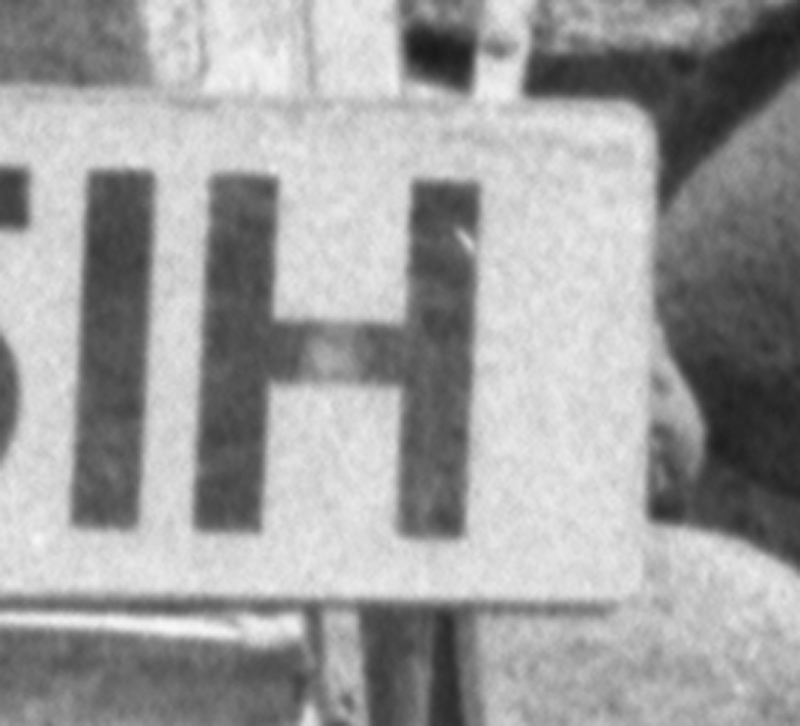

The results are in . . .
The results are in, and I must say it has been a bit of an eye opener.
Firstly, I would like to reassure everyone that by doing this test, it is not my intention to tread on any toes. Nor am I out to prove anyone right or wrong. In this thread, I gratefully received a great many suggestions, all of which I took on board and put together in this series of tests. Like a `Mensa Test`, there are no right or wrong solutions. Each has it's own merits but at the end of the day, it comes down to personal preference.
All test strips were Stopped for 1 minute with constant agitation. Fixed for 5 minutes, with constant agitation for the 1st minute, 10 seconds every minute thereafter. Then rinsed using the Ilford method and swirled in Wetting Agent. Then squeegeed and left to dry naturally overnight.

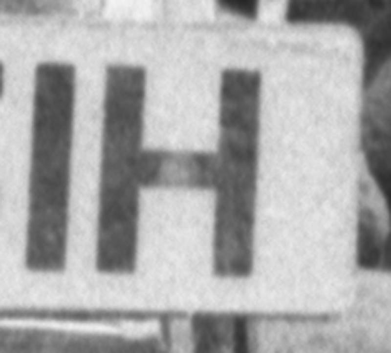

First up is (my usual method) theRodinal 1:25, 20c for 6 minutes, agitation for the 1st minute, 10 seconds every minute thereafter.
On inspection, I was quite happy with the result. As this was the first strip scanned, I had nothing to compare it against . . .

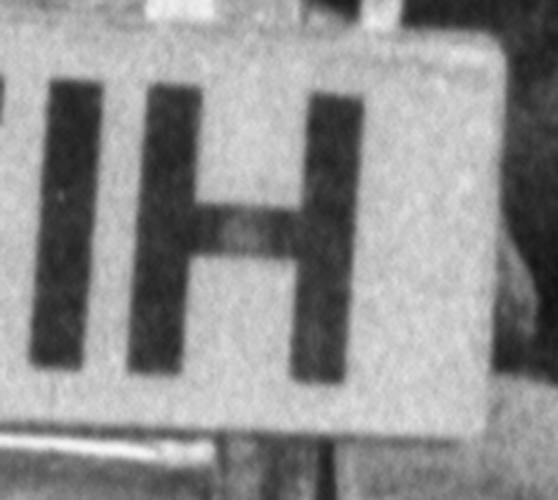

. . . next, Rodinal 1:25 + Salt (same method as above).
After scanning this one, the difference was quite a shock. I particularly like the results of this one. The salt, whilst not making much noticeable difference to the grain, has boosted the contrast throughout the image to another level.
After viewing this, I realise the standard 1:25 seems quite 'bright' and not as clearly detailed . . .

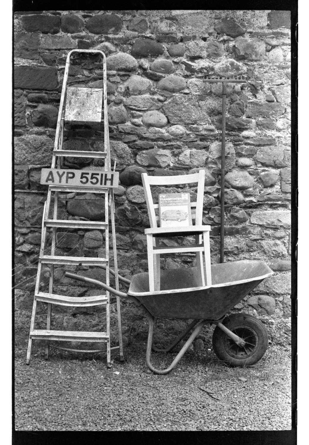

. . . next up, Rodinal 1:100, 18c, 1 hour, constant agitation 1st minute, 10 seconds agitation at 30 minutes.
What I find apparent here, is that there's very little difference in contrast with the 1:25 standard and also very little difference (if any) in terms of grain size, clustering or shape. Maybe with the weaker dilution but increased time, the results are the same. Two ways to skin a cat, if you'll pardon the expression . . .

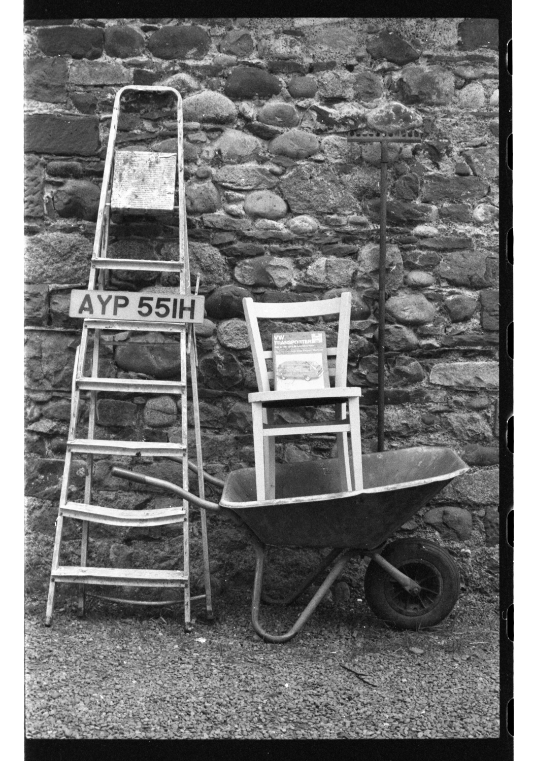

. . . and finally, Rodinal 1:100 Salt (method as standard 1:100).
What's apparent here is that there is a more noticeable difference with the 1:25 Salt. With the rake head for example, the contrast seems to have more balance, as though the salt was loosing it's potency over the longer developing time (?) Also, the grain appears more structured and `busier`. I am particularly pleased with the look of this negative . . .
Nice job, thanks!
Here are the 3 images side by side for easier comparing:
Rodinal-1-100.jpg1+100 Rodinal-1-25.jpg1+25 Rodinal-1-25-Salt.jpg1+25 with salt Rodinal-1-100-Salt.jpg 1+100 with Salt
It is possible that the sun was gone in image #3 (with Salt)? I don't see the shadow of the ladder anymore.
If you used the same exposure time, then this could explain the darker image.
Are you planning on printing the images in an identical way?
. . . So there you have it. The results of the 4 tests were quite surprising for me. It would seem that none of the four methods had any real effect on grain size, clustering or sharpness. However they (to my eyes), fall into two distinct groups as far as contrast is concerned. Both the standard 1:25 and 1:100 appear to make similar images, maybe a factor of wildly different dilutions but offset by wildly different times. The same could be said of the salt solutions, however the longer period of the 1:100 Salt seems to effect the longevity of the salt itself?
So in summary and based on pixel peeping only at the moment, my money is on the 1:100 Salt.
